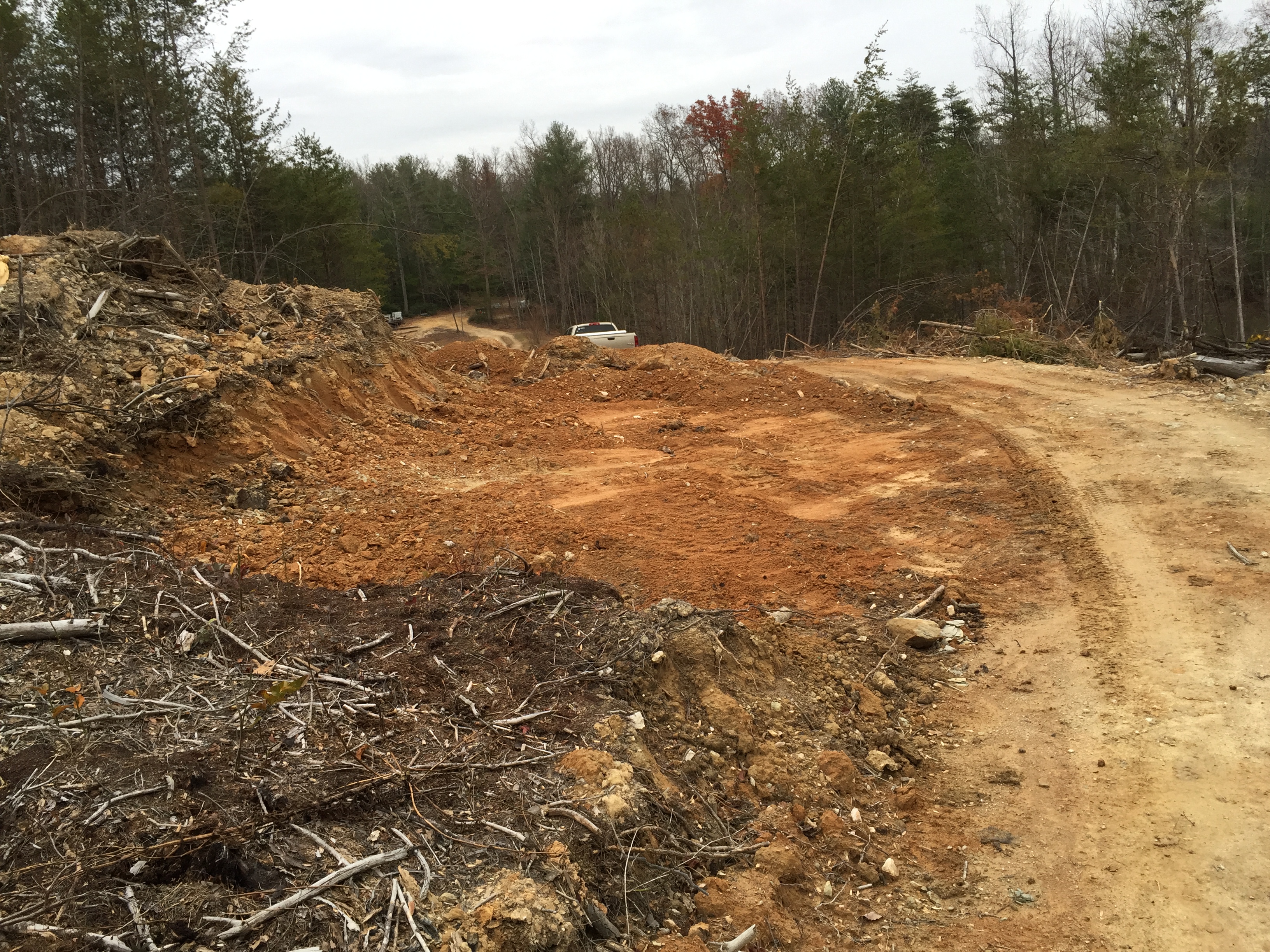

I spent the weekend Camping and hunting at my homesite. I had a new eye when I was walking that road. I am going to give this a go. If we get into January and it just doesn't feel like it is something I can handle, I will call someone in to finish it. I spent a couple hours on it yesterday afternoon after I had packed up camp, just to get a feel for it. In construction of my bridge, I had already dug into the hillside some more because I needed soil to build up and even out the bridge.
I had already widened it....perhaps more than I need to for the rest of the road so I just continued on with that same basic line. Before moving any earth, I used the teeth on the bucket to push any debris our of the way on the uphill side and pulled up and debris on the downhill side so that I would be shoveling clean dirt and rocks, not a bunch of sticks and brush....and so that I would moving it over to a clean hillside, and not putting it on debris that will rot and create unstable and uneven ground over the years. Time consuming, but neccessary. Then I pulled stumps, then I shoveled out the dirt.
I have found myself needing a lot of soil on the farm, especially in areas where I dig out stumps. and to even out the skid roads that logging have left across the fields. I don't think I want another machine with a big engine to maintain, so I might be looking at a dump trailer. I had already been thinking of getting one so that I only touched things once around the farm instead of twice. Eddie has given me some very good advice in the past and I have no doubt that I should consider what he has said here in the way that I approach it. The comment about "swales" that Sixdogs made had me googling for a bit and the images really brought together what a wider ditch needs to look like. On the 1/4 mile of road that was already on the property, there is a small trench ditch on each side of the road and a culvert at the bottom to guide water. It works very well, but doesn't have a large hillside looming over it. There is a lot of rock that I will be dealing with. Some of it rather large. The only way to know what I will get into is to get into it. Implements that I currently have are 84 inch box blade. 84 inch landscape rake (when I bought it, I didn't know that I should have gone wider than the tractor). Neither of those will do what I need in a timely manner. I have time to look around for a decent back blade for shaping once I get the digging done. I figure the digging will take me a month or so of weekend work, before I even need to think about shaping it with a blade. ...especially since I like to sit in the woods with my rifle in the morning during hunting season. I'm going to take my time and "dig in" to it. Yeah....bad joke.
