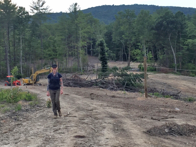

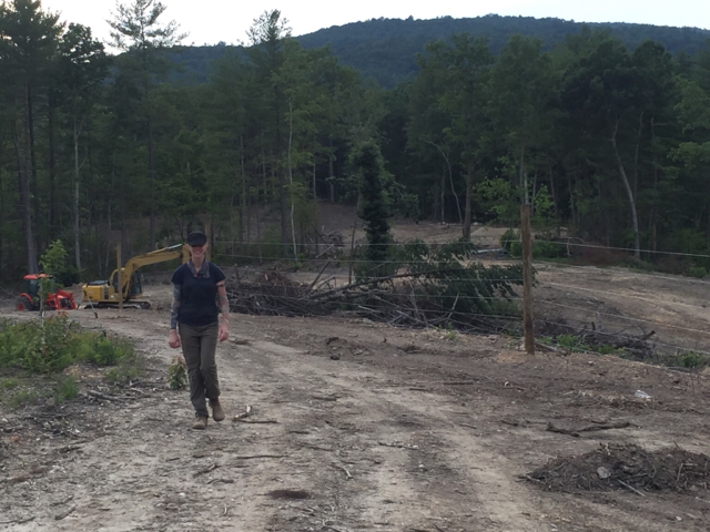

Because a large part of this fence will eventually get moved I just did 10 foot poles. 3 feet in the ground with 7 strands of hot steel wire. Previously we had a lazy 3 strand fence that successfully kept them out of the orchard so the 7 foot should do the trick. We are two years away from a harvest so I expect things to change when we have apples. IMG_6790.JPG

Nice looking fence.
How high is the top wire?

Ah, missed that part... good choice, then... I would still try and make it more visible to them. If they are running, they will not see it also, you don't have to energize above 6-7 feet since to make contact, they will be flying in the air and will not completing the circuit.
I hadn't even considered that. Thanks.

One of the wiring plans I have seen for fences suggests alternating hot and ground wires, even without good dirt contact they can still give a good zap...
