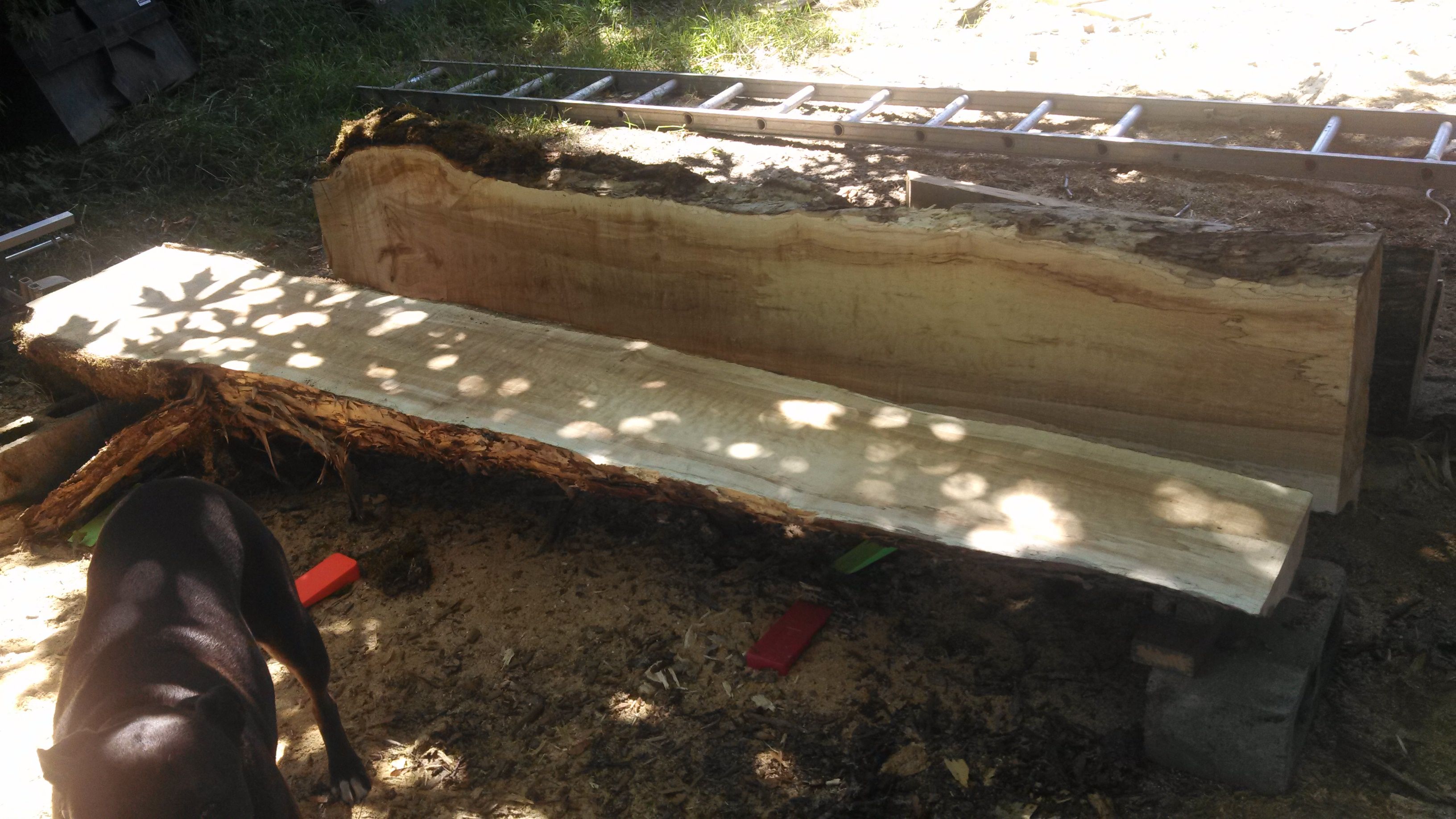

I really like that huge bent wood shape. If you made a few and sold them - you'd be making good money I bet. also find some locust wood and cut a notch to hold log off ground. should last long enough to enjoy many years around fire pit.

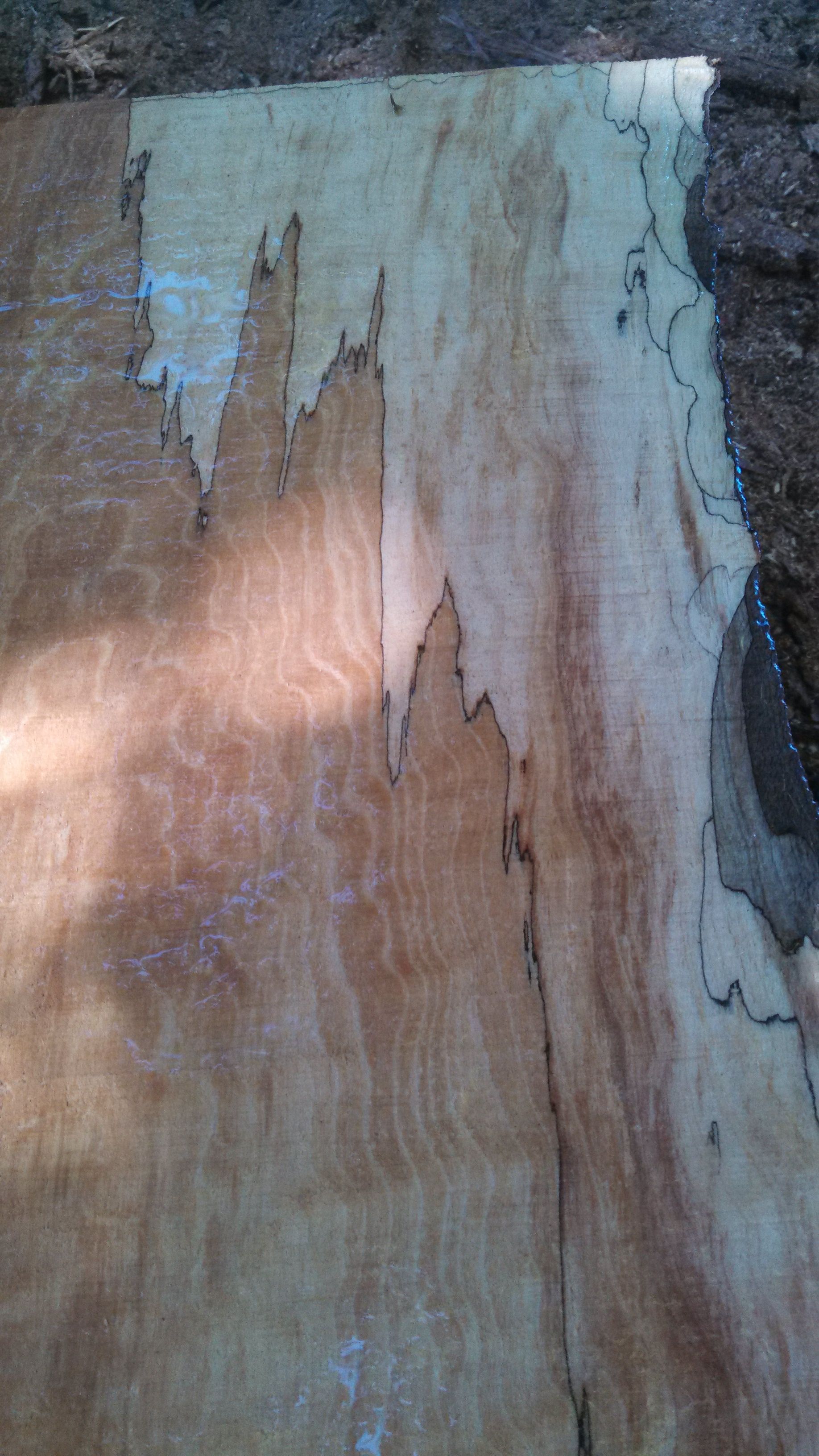

Well, I seem to have found a new use for these twisted logs. My neighbors saw this, and we live in a logging area, and the phones were dialed. Now I am supposed to hook up with some logging outfit, They find these trees all the time and usually just leave the bent stump. I guess they will drag some up for me if I want.
As for how I did it, well, I wouldn't repeat my procedure. It is an alaskan mill with a 32" Stihl 044. I put an aluminum ladder down, one end to the other, got my estimated height in the middle and then set the ladder to the middle with cribbage. As I got to that point, I stopped and rotated the ladder so it wen to the other end.
NO BUENO
Ladder tilted, things got mucky and you can see the wow in the cut.
l
Next time I get a piece like this I will sacrifice a 2X8 or a 2X6 and some 2X4 cribbing. Cut the 2X6 at angles to get it to make a relatively flat turn... like _/

Ha...well let's just say I can bluff my way through just about anything(and don't look too close):laughing: I have not used an Alaskan set up, both my CSM's were fixed on a track like a band mill so cutting a curved log would have been "interesting". What kind of feet or base did you decide on?
/ Firepit Bench project
#34
I was thinking Cedar rounds. Cedar is a choice of wood in the PNW for direct burial. so I figured it would work fine as footing.

I have a curved Cherry that I had a guy with a portable band mill cut up for me. It was a large model mill and he didn't mind playing around some. He cut half way down it, backed up the saw unit, spun the log around, and cut from the other side. The two cuts lined up really close, nothing a planer couldn't remove.
