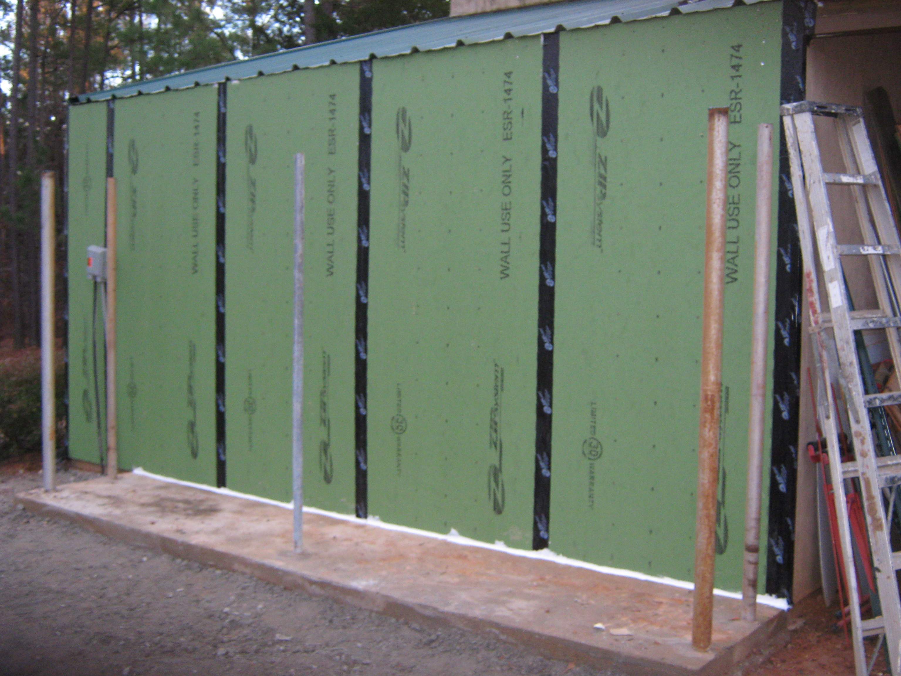

After much thought, and trying to find a better place, I decided to build a leanto on the side of my house to store firewood. Bugs have me terrified, but it's the only location that really works for me.
I have some used pipe laying in my scrap pile from jobs that I've done that I thought would make goob supports for stacking the wood, and to hold up the roof. I set them in concrete and then poured a pad next to my foundation. Before I poured the concrete, I sealed up the bottom edge of my exterior, Hardi sided, house. It's thick and ugly, but I belive bug proof if anything gets through the concrete.
On a side note, hate the siding on my house. My long term goal is to replace it with James Hardi Lap Siding.
Because I'm redoing my entire house in stages, I've decided to try Zip System. The panels don't require house wrap, and are designed to be out in the elements for extended periods. I've never used them before. The ones I bought were 4ft wide and 9ft long. My wall is 8ft 7in tall.
Eddie

Eddie, your stove looks very cozy. Nothing like a wood stove for comfort.
I think as long as you split your wood and let it dry well outside in the hot Texas sun before bringing it into your woodshed, the bugs shouldn't be too much of a problem. I am guessing you made the lean to snake proof too? :D
Dave.

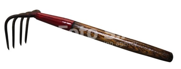

I use a garden claw to pull my wood off the top of my wood pile. It has a 5' wood handle with steel fingers. Like this one, but with a long handle. That would let you sort through the pile and stay out of surprise range! :laughing:

Eddie, do you plan to extend the roofline to cover the stacked wood ?
If you don't, the wood will be dumped on big time every time it rains. If you overlap the front of the stacked wood by 1 ft you should be fine, unless you happen to get strong wind from that side. If the wall was to be south facing, it can be amazing how much faster the wood dries. I have burnt oak 8 months after splitting it, which is about 1/3 of the recommended seasoning time, but I think the south facing position was key, as well as keeping the splits small in cross section.
Termites should be no risk in firewood, except for where they may go when leaving the wood as it dries.
