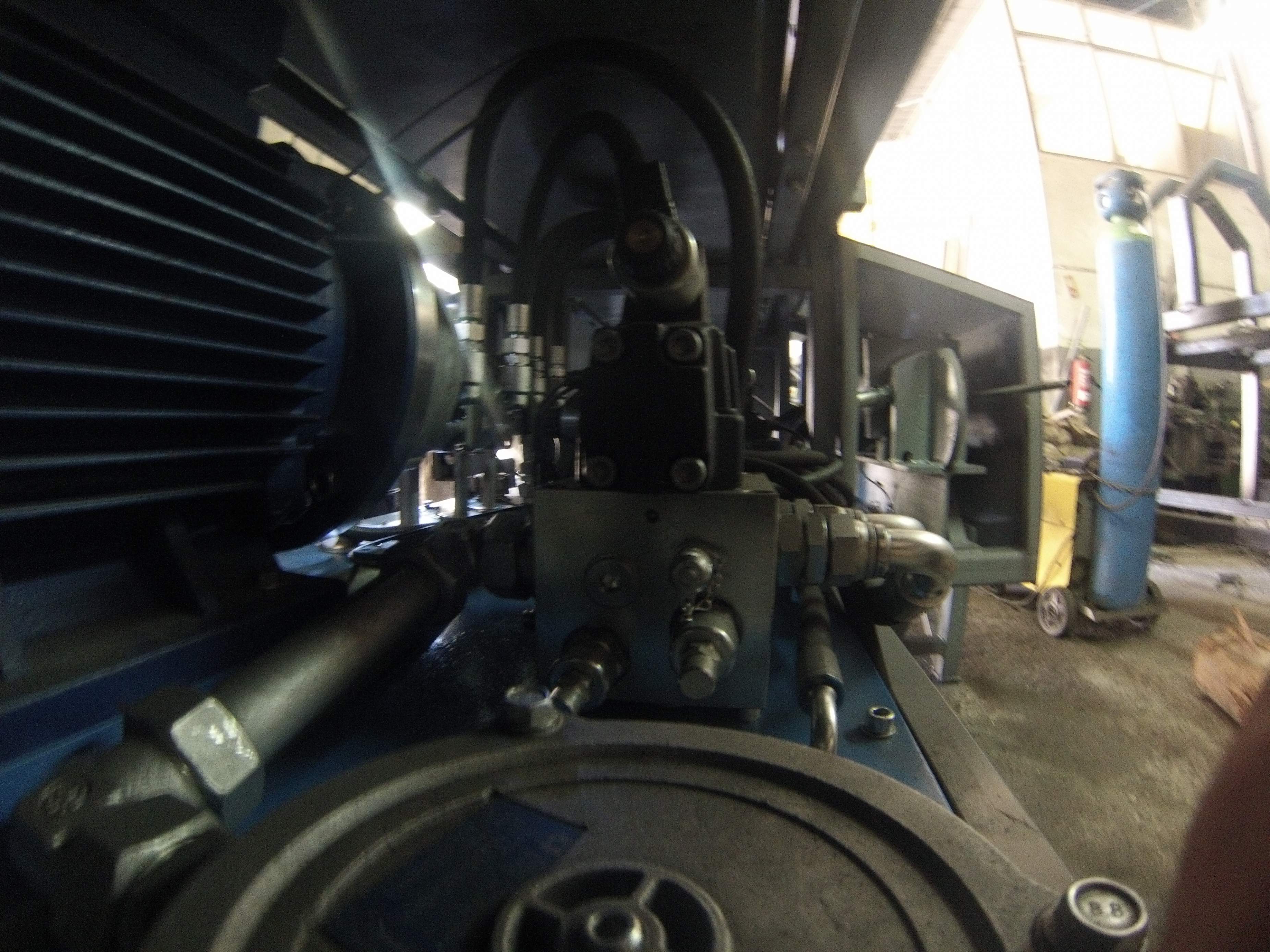

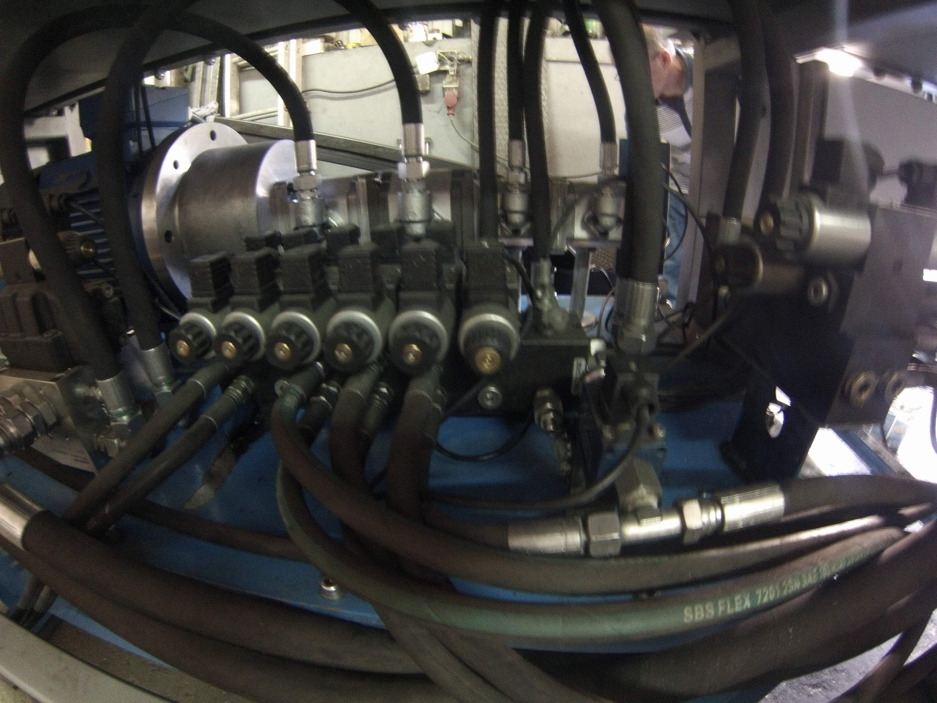

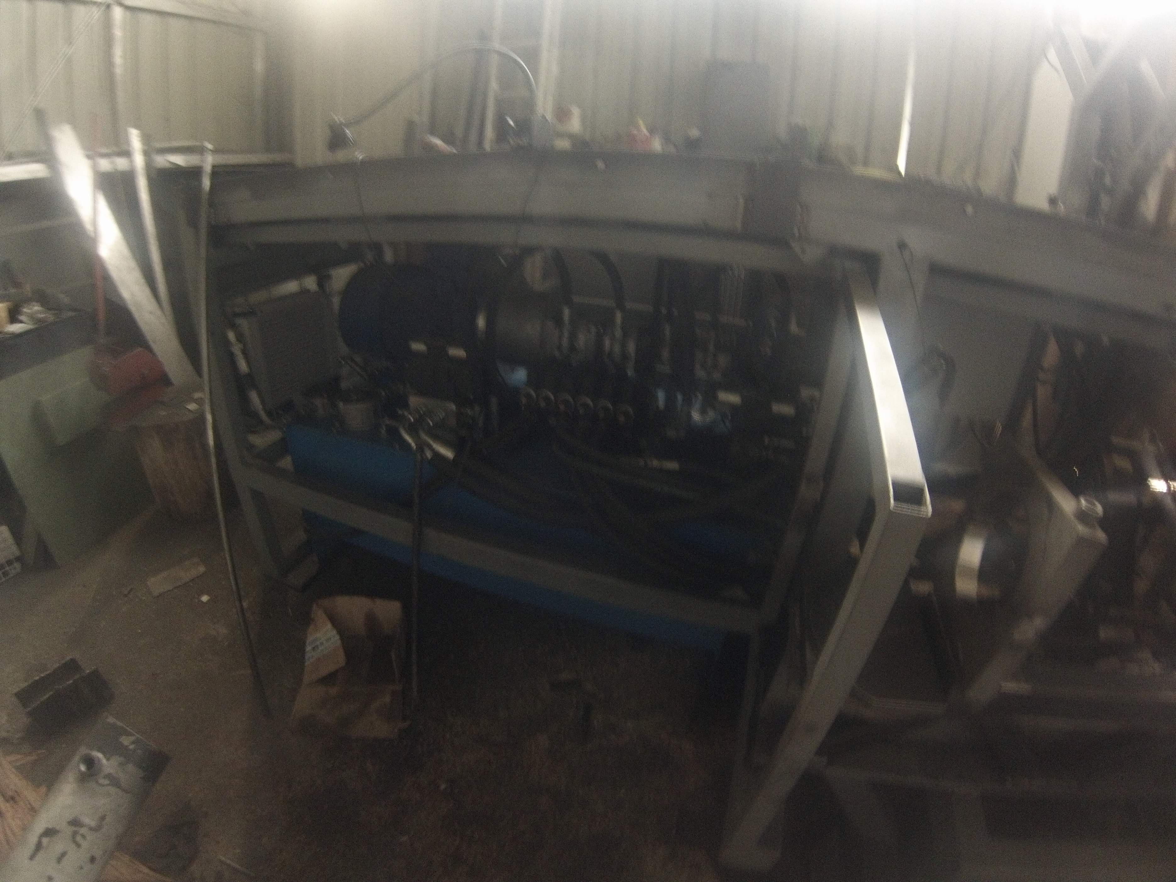

3- 3 independent circuits (one for splitter, one for saw and saw cylinder, and another for all the rest) with independent block solenoid valves. I´m at 0 (ZERO) knowledge in this part of valves, reliefs, check valves, etc, but I swear I'll study this subject , and within a few days I can talk about this with some knowledge. I think I have somewhere the engineer circuit draw, i´m gonna find it and post it!

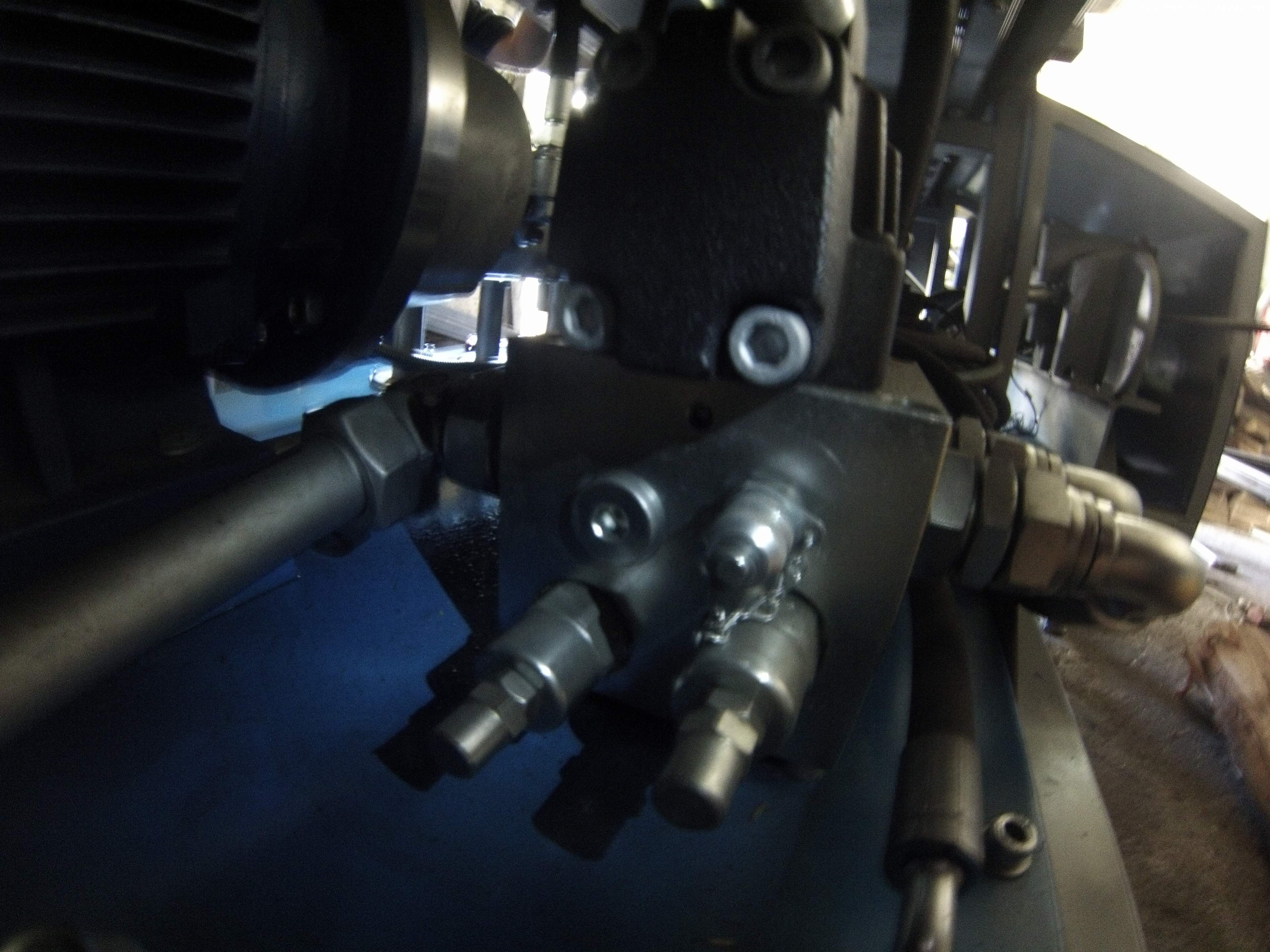

4- the splitter circuit GOPR0533.jpg GOPR0545.jpg work like yours surpluscenter 2 stage pumps..do the math, and you can figure out what i can do with 25 HP and 29,2 GPM at 1500 rpm, with 12,7 GPM at high pressure stage and 29,2 GPM at low pressure stage @ 6,3 in bore and 3,5 in rod cylinder.
5-GOPR0544.jpg My saw circuit have 2 solenoids: one for saw motor and one for saw cylinder (this one have some king of pressure regulator valve too, so i can change pressure in saw cylinder independent of pressure in saw, that have it own relief or check valve, or whatever it have). This is feed with the 8,9 GPM pump. Again, you can do the math, and figure out what my .404 chain should give. Don´t forget i have 2:1 pulleys ratio, and 12 tooth rim sprocket, and f11-010 parker motor.
6-the third circuit is feed by the 6 GPM pump, and it intend to work with clamp (this one have pressure valve, or what else kind of valve to clamp at what pressure i need), log conveyor, log deck, log lenght, and log push down system.
7- almost all my lines have flow control valves, so i can change things as i want
Think this is all I know about my machine..

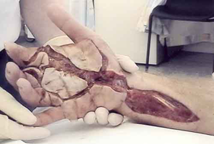

You said.
About my homemade cylinder: it has no specs, it is homemade. If it explode, and since the machine will be working mostly in automatic mode, i hope to be away, stacking some wood or something..if i die, i will remember that you have been warning me about my homemade cylinder..
Here is an example of a hyd injury.
Fitting exploded in a gloved hand using a hyd tool.
   / Firewood processor help
#108
woow..if that was made by a fitting, i wonder what it could happen with a cylinder explosion..
..hope that guy is ok, seriously..
