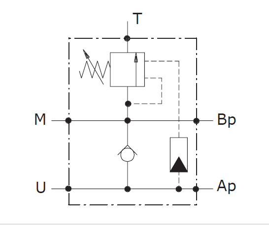

for now i canエt spend more time..got to put machine working..but, yes, the goal is try to put some oil on it..maybe my splitter pumps can do it..i havenエt figure it out yet, but i already know what kind of block valve I have: itエs a "Walvoil" two pump hi-low unloading valve, and i have the schematics draw with all the simbology for this Walvoil valve, but it is chinese to me..:) maybe you could "read" it for me..:cool: Walvoil two pump HI-LOW unloading valve.jpg..think "AP" is high pressure in italian, an "BP" is low pressure.."T" got to be tank, and the others have no idea..

J.J..don´t you help me with one thing? :) tomorrow I need to set up splitter reliefs correctly, and don´t have sure how to do that, since i have hi low pressures to set up, and a sensor that don´t let me extend cylinder to max..you think i can do it this way?:
If i disable this sensor, the cylinder will extend to the max and is going to put all shop electricall installation down (trust me, it happens a lot:D)..so if i open the two reliefs that my Walvoil unloading valve have (one for HI and another for LOW pressure) all the way counterclockwise, when the cylinder extends to max the valve should bypass flow to tank since the pressure is set at the minimum, wright?..
then, think gradually ajust pressure UP in both LOW and HI pressure relief valves at the preset numbers (about 1200 PSI) should mean that my two pumps are going to bypass to tank at this pressure..and then if I set gradually up only my HI pressure relief valve, means that only this pump will flow to the cylinder above this preset pressure since the low pump is already adjusted and bypassing to tank at 1200 PSI..am I wright?..ajusting the second pump to about 2800 PSI, means that at this pressure my second pump will bypass oil to tank too, while my first pump is still bypassing it..all this have to be done with cylinder extend to the max..it´s should stay there, bypassing oil to tank, and not shut down shop electricalls, or damage a pump, or burn motor, or whatever..
Is this the correct way to set up this reliefs?..i have a 6000 PSi gauge connected to splitter main block valve, so it should be able to measure this easly..

the systems does not work like that J.J..my WALVOIL two pump HI LOW unloading valve, must be working in a diferents way that you aare saying, because i measure timings to retract and extend cyl, and it got to work this way:
My two pumps work togheter all the time, with a combined oil of 12,7 + 16,5 GPM..so around 1200 PSI is going to be my pressure relief setting for the 16,5 pump because this pressure is my limit for 29,2 combined GPM, ir should be required 23 HP or so..since above 1200 PSI only the 12,7 GPM pump will work with pressure, it should hang up with 2800 PSI, requiring around 23 HP..
but my problem isn´t the reliefs PSI values..do you think that is a good way to set my reliefs?

A little more figuring is needed if you plan to set one relief at 1200psi and the other at 2800psi. For one thing, you still need hp to make the 1200psi with one pump, and then you are going to have to have enough power left over to power the other pump up to 2800psi. Just because the one pump is dumping over relief doesnt meant is isnt consuming hp. you are still pumping 16.5gpm at 1200psi and than adding the 12.7gpm at 2800psi, you need to combine the hp numbers to find total hp needed. 16.5gpm@1200psi=12.8hp, 12.7gpm@2800psi=22.7hp. 12.8hp+22.7hp=35.5hp. I think to make it work, you are going to need to use a pressure switch along with your solenoid valve so that when both pumps are pumping and pressure reaches 1200psi, your 16.5gpm switches to dump to tank mode while the 12.7gpm is building high pressure. You would need to add a check valve to keep pressure from dumping from the hp pump to the low pressure pump and back to tank. With this method, as soon as pressure drops below 1200psi, the solenoid valve would redirect the the low pressure flow back toward the splitter and and speed the cyl to full speed. Right now, I think you will need at least 2 seperate soleniod valves to run your two pumps thru and somehow combine flows between the solenoid valves and the cylinder. Maybe the walvoil valve does that, I just dont know.
I dont know how the Walvoil valve is supposed to work, but it it keeps the high flow low pressure side up to 1200psi as it dumps oil, then you are still going to be way low on hp.

relief set for all 3 circuits donne..today engineer give us a help..i realize many things..
the twin pumps work togheter.. the relief for the low pressure high flow pump was set @1200 PSI, and at this pressure i have both pumps working on splitter.
As soon as pressure rises, the low pressure high flow pump begins working with no pressure to tank, freeing all available HP to the HIGH pressure pump, that was set @ 2900 PSI..so, got HP for HIGH flow (15 TON @29GPM @1200PSI with 23 HP) and got HP for HIGH pressure (37 TON @12,7GPM @2900PSI with 24 HP)..for set this reliefs we have to disable splitter sensors, and they were set up at max cylinder stroke..
Saw is alot better..we ajust reliefs too, and it is cutting at max pump pressure..next step is try to give some more oil to the F11-10, thinking to change the 8,9 pump for one maybe with 20 GPM, should have HP for saw @1900 PSI, witch means the old one .404 pitch, 6500 feet/min at chain speed, and around 20 HP of power..can´t wait..:cool:

I did a little reading on those high low valves. It seems they work similar to pressure reducing valves in that they do switch flow to tank without running the fluid over reliefs. I still dont completely understand how they work. I did talk to some of the hydraulic folks at work on the phone this morning and they tried to explain it to me, but I think I am going to hit them up to go over it again next time I get back to their shop. This thread has given me an different ideal on how to plumb my processor than I had originally planned. I am also considering going with a variable displacement pump and closed center. I think I can secure one 90 gpm variable displacement pump that will run everything instead of using 3 separate gear pumps.
