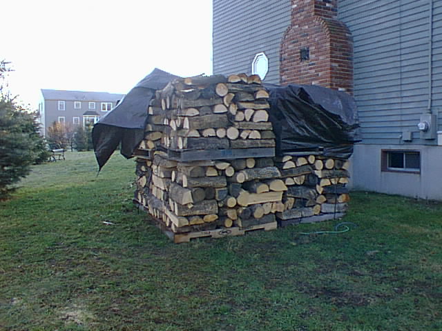

This year I put away the firewood trailer and started using pallets to store/dry and cue up the firewood near the door. Yes, it took me awhile to get out the camera, but here's what's being used and I'm really enjoying the dry wood resulting from the hot drought period this summer. My scenery isn't anywhere as pretty as AndyR's but my setting is more suburban than rural too.

Are you loading the pallets with green wood, and then moving the pallets to the site shown in the picture?
I was wondering (if the above is true) what you are using to move the pallets. Forks? front, rear?
I am planning to begin stacking green, split wood on pallets, and moving the stacks, after the wood is dry, up to the house (100 - 200 yards), and wondered about stacking about the same height as you have done.

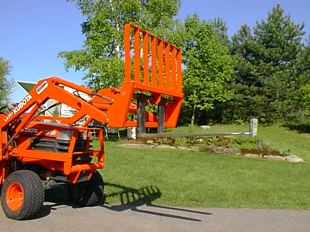

My wood was cut this spring and is stored tree length in a 5 foot high pile uncovered. This year I started cutting up the pile in July and took advantage of free drying by the summer heat. Yup, the stuff is heavy green, sometimes I could only pick a few inches, mostly with the rollback function and did the drying single high. There isn't that much energy for creating firewood at that time of the year anyways, sailing is more important! Since it is palletized, multiple moves are not a problem, and the banding needs to be tightened as the wood dries. Moving device displayed in the attached picture. SteveV

How do you band the wood on the pallet? and what is involved in tightening the banding?
Did you re-pile it after the drying process, onto the stacks on the pallets shown in the first pic?
Nice forks for moving the pallets. I may just stack some dry wood (red and white oak split) onto a pallet to evaluate the height I can pile and still move with my FEL. I'm guessing about 2' of height, and then stack on another pallet (also based on AndyR's pic earlier in this thread).

There were enough questions there to go multi window to answer them. For banding I use cheap poly banding from Uline (www.uline.com), it comes in a kit with band, tool, joiners all for like $40. it's good for something like 600#, pull it tight with gloved hands if you please or use the tool supplied. Nope, no resacking after drying, it moves around some but just tightening seems to keep everything where it belongs. You get a pretty good idea whether to add that next layer or if its going to be a top skid or bottom after you've done a couple. SteveV
