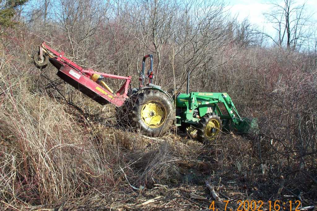

Hi, RichZ. Could you take a picture from behind the tractor with the mower on? I am having trouble figuring out how check chains work. My BrushBull doesn't have them.

Hi, Mike!! Ask, and ye shall receive!!!
By the way, the check chains don't come with implements, you have to buy them seperately.
Here's the picture...
I hope it helps.
