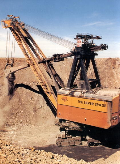

Dozers are meant for one thing.. Hard pushing. So half a day and the latter half of a day on a very large extension cord. Keep in mind that the now defunct Gem of Egypt and the Silver Spade we both 100% electric powered strip mine shovels and so was the 'Big Muskie', the worlds largest dragline. They had some HUGE extension cords. Back then electricity was plentiful and cheap. Today it is neither and getting worse as demand grows.
This interested me. There are currently some battery powered shovels but these are juicing up their own batteries with a diesel engine so they are more like "hybrid plug ins".
At any rate, I can't imagine these old electric shovels being "corded". I would love to see the generator and the size of the wire utilized but can't find anything on the net about it or I should say don't know how to look for such.
I would imagine the gen sets self contained but fueled with gasoline or diesel I'm thinking.
Google P&H 4100 xpb. We had them at the mine I worked at.

None of the above. They carried their 'extension cords' on large reels on the back that wound it in and out depending on how the shovel moved and they didn't move a lot, didn't have to. The cord if you want to call it that was about the size of your leg and it was run to a substation provided by the electricity supplier. If you go to You Tube and search for the 'Silver Spade', there are a few videos on there and a couple of them show the back end with the cord reels. My dad was one of the analytical chemists that worked on perfecting the high strength alloy's used in the Spade. He worked at the long gone Republic Steel and he got to be there when it was put into operation near Cadiz, Ohio and I got to tag along when I was a kid.
I still remember it quite well actually. it made no noise other than the cables winding up on the drums and some squeaking it was basically a silent giant. it was so big it had an elevator inside in the center so you could get to the upper floors. Had it's own machine shop and cafeteria for the workers on it. Just the crawler tracks were 15 feet high and if I remember correctly, there were 6 sets of them. I believe Bucyrus-Erie made the tracks and designed the entire machine and put it together.
The operator sat in a cab that stuck out from the side of the main house so he could see everything and the bucket was big enough to put a 2 story house in with room to spare.
All it did was remove the overburden so the coal seam was exposed to be removed.
If I'm not mistaken, quite a few of the BE shovels of that day were also electric powered.
Do a YT search for it. There are a few good video's of it in action and one about how it was dismantled or should I say blown apart. Big Muskie suffered the same fate (blown apart with shaped charges and scrapped).
The Spade, Muskie and Gem of Egypt really laid waste to the area surrounding Cadiz, Ohio. That was prior to reclamation being enacted.
The Silver Spade had 8 crawlers - one double crawler on each corner. They were about 8' high.

When I was a little tyke they seemed like 16 feet.... :giggle:
I still remember coming up on it. Dad was driving and I was gawking. All you could see was the top of the stick over the piles of dirt and rocks. Until you got down to where it was you (at least I) didn't have a clue how big it was.
I remember when they drove it over Interstate 77 too. They piled dirt I think 16 feet deep over the interstate so they could drive it across.
Machines of a long gone era.
