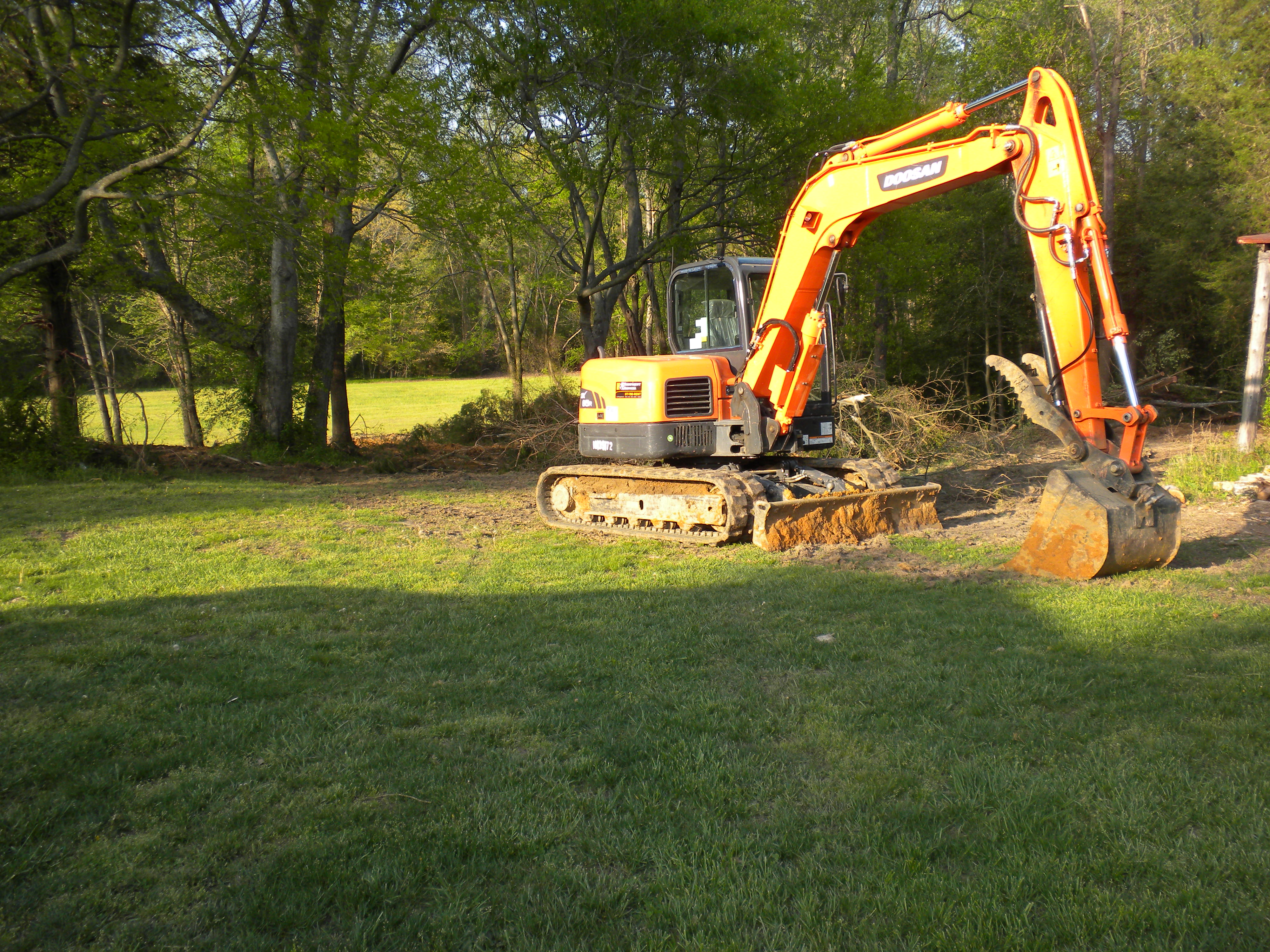

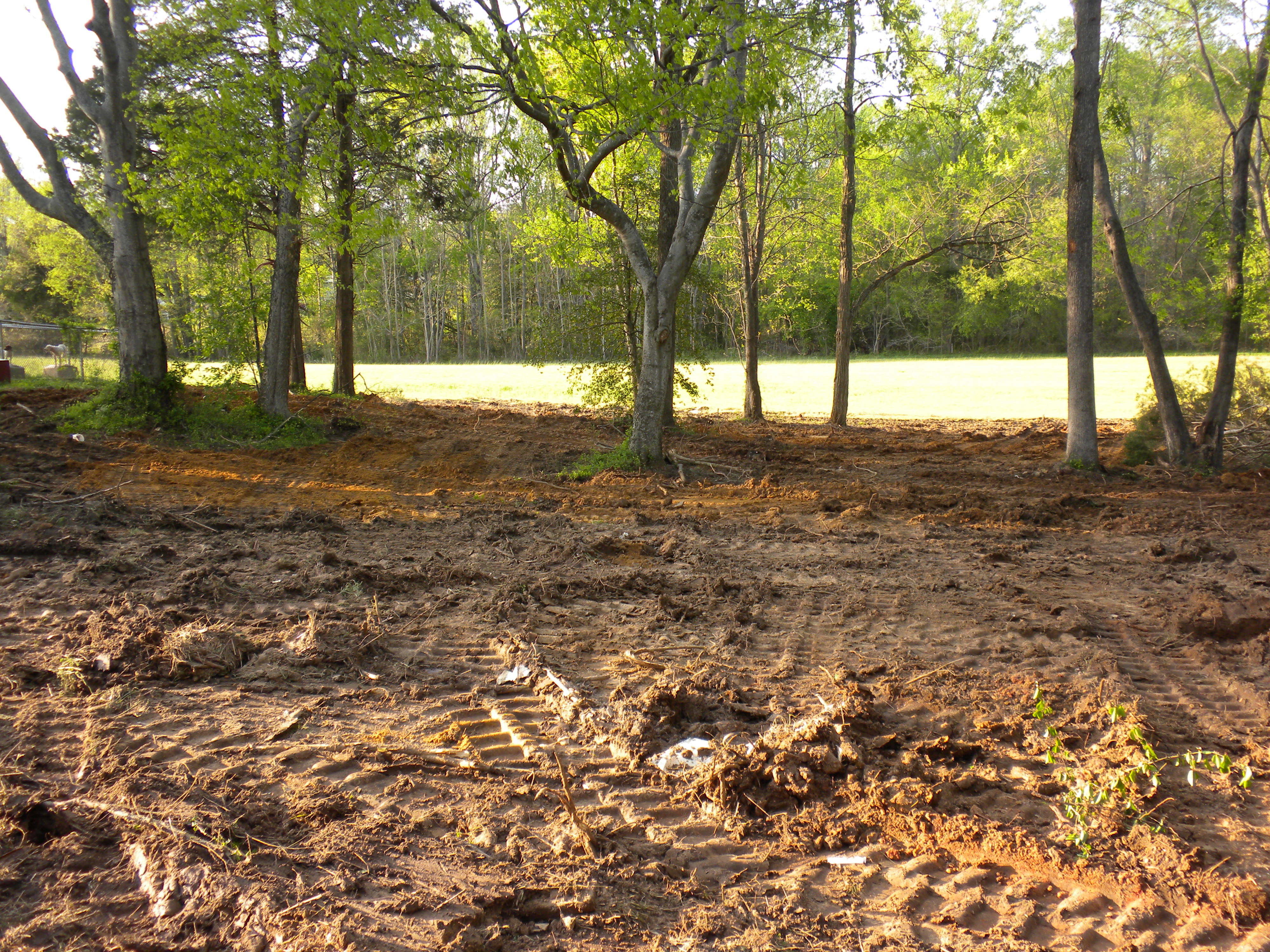

An 18,000 lb mini excavator for one week including fuel and delivery is around $ 2,500. It is the biggest size you can get in a mini-ex and will clear out an acre in a week easily if you know how to operate it. I cleared an acre behind my house with 18" dia. plus trees and buried and old dump pile. The machine knocked them down like they were twigs and pulled up the stumps with ease. It had a hydraulic thumb and I dug and picked all the stumps, dug a hole, put the stumps in and burned them. I used the dozer blade to rough grade the ground after all the destruction. Best vacation ever!

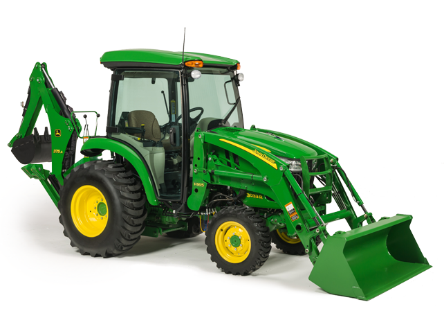

You listed the 3033r so I figured I'd attach a photo. I'd love to hear from anyone who has this setup. It has to be fun to operate.
