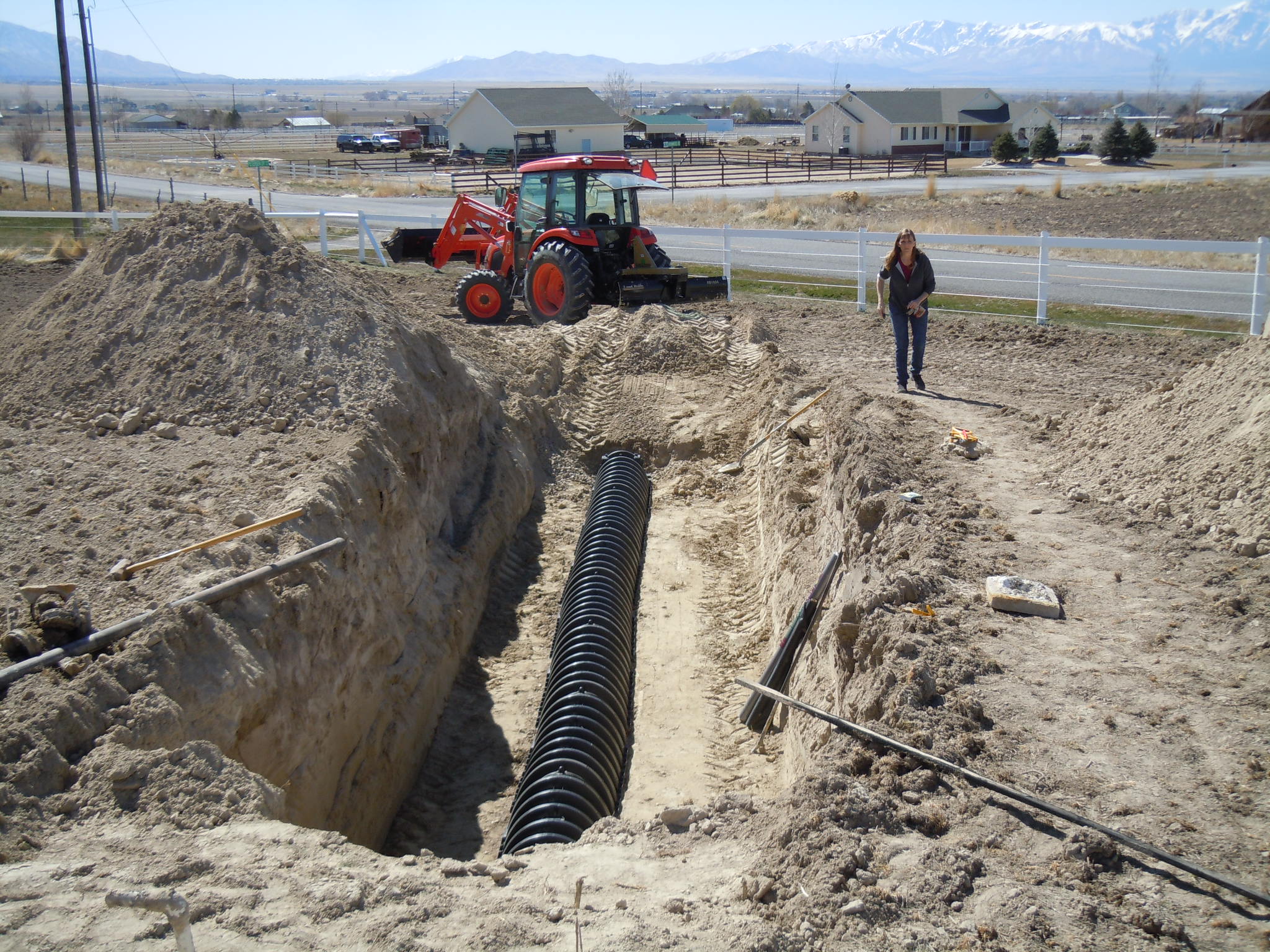

I dug this trench with the FEL 2 months after getting my tractor. I have to admit, it took a little time to burn the movements into my thick head. But it was going smooth after that.
The more you use it the more natural it will feel.
