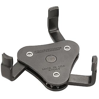

OK, thanks for the suggestions. I have the the Deere wrench. Is it necessary remove the side panel to get at the filter and remove it completely. It's a tight fit. If you remove the panel, how? It appears that there is only one screw attaching the panel to the frame.
The panel can be a bit finicky to remove and replace as it's really wedged in there and you don't want to break any of the tabs. On my X500 I just remove the 8mm bolt which holds the panel and then the panel has enough free play to easily get a wrench on the filter and remove it.]
   / First Oil Change X590 -- Oil Filter Wrench? #12
I'm a big fan of this type of filter wrench. It's geared inside so as you turn counter clockwise the teeth bite in. One size fits all. :)
I have one of those but on the X500 I've been using one of the socket-style filter wrenches that just fits over the end of the filter. It fits perfectly so it doesn't mar up the filter. It also works perfectly for tightening the filter 1/2 turn. Something you cannot do with those geared loosen-only filter gizmos.
