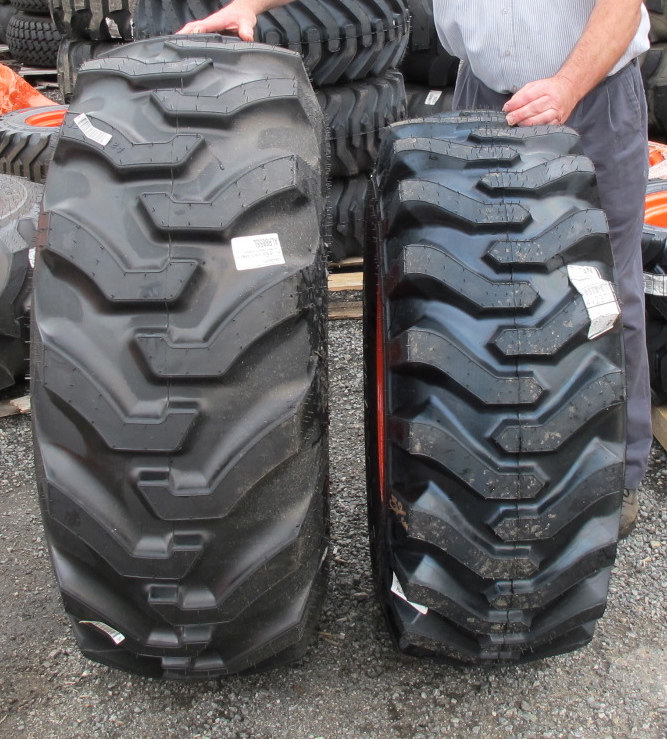

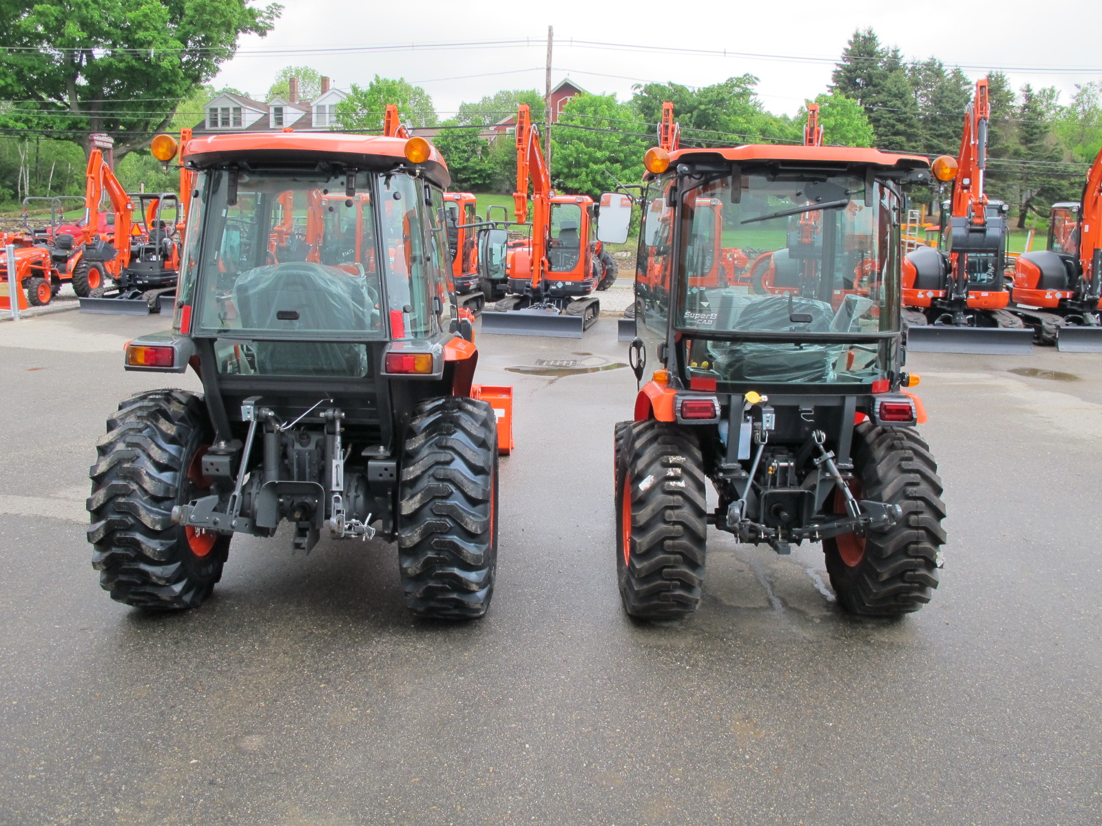

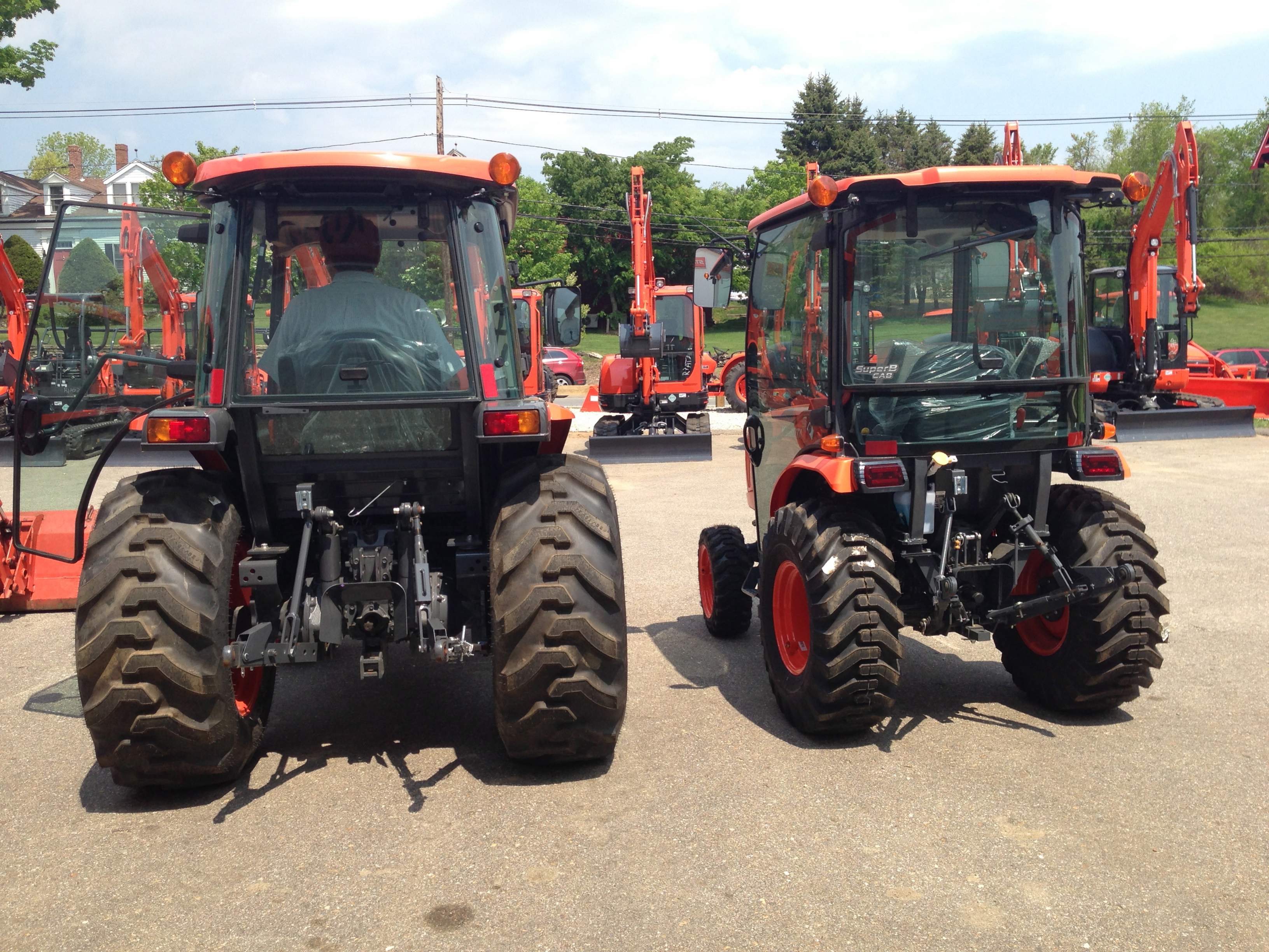

Thank you , do you or someone, know what the tire tracks are for the L3240?
The 3240 Specs say, Overall width (min.tread) is 59.8 inches. Does this mean with the stock factory tires on the L3240 a 66 inch bucket will cover the tire tracks?
The smaller L3800 tires on the tractor now have a width of 66 inches the rims are offset deep dish. I would really like to keep the 66 inch bucket or 60 inch bucket if possible. Could the larger tires leave a narrower foot print? It would be hard for me to believe since there're so big. Here are pictures of both. I really do not want a 72 inch bucket. But I do want to be able to back drag the bucket over my tire tracks.

The overall width of the rear tires will depend on how the adjustable rims are set.There is four different widths possible if I remember correctly.I had mine set to the third widest setting and it was just narrower than the six foot bucket.
What does Overall width(min thread) 59.8 inches mean? does that mean a 66 inch bucket will cover the rear wheel tracks?

All of the tire measurements in my manual are to the center line of the tire. I think there are only three positions for the industrals, the ags have a 4th position, narrower but I think the R4s will rub on the inside of the fenders. There should be a position that would allow you to use the 5'6" bucket without it being narrower than the rear tires. I would say that the wider bucket would give you more options but I only moved my wheels to the widest position because of the hills on my property and doubt I'll ever change them again. If your rears are loaded (or going to be) then I doubt you'll ever adjust them.
