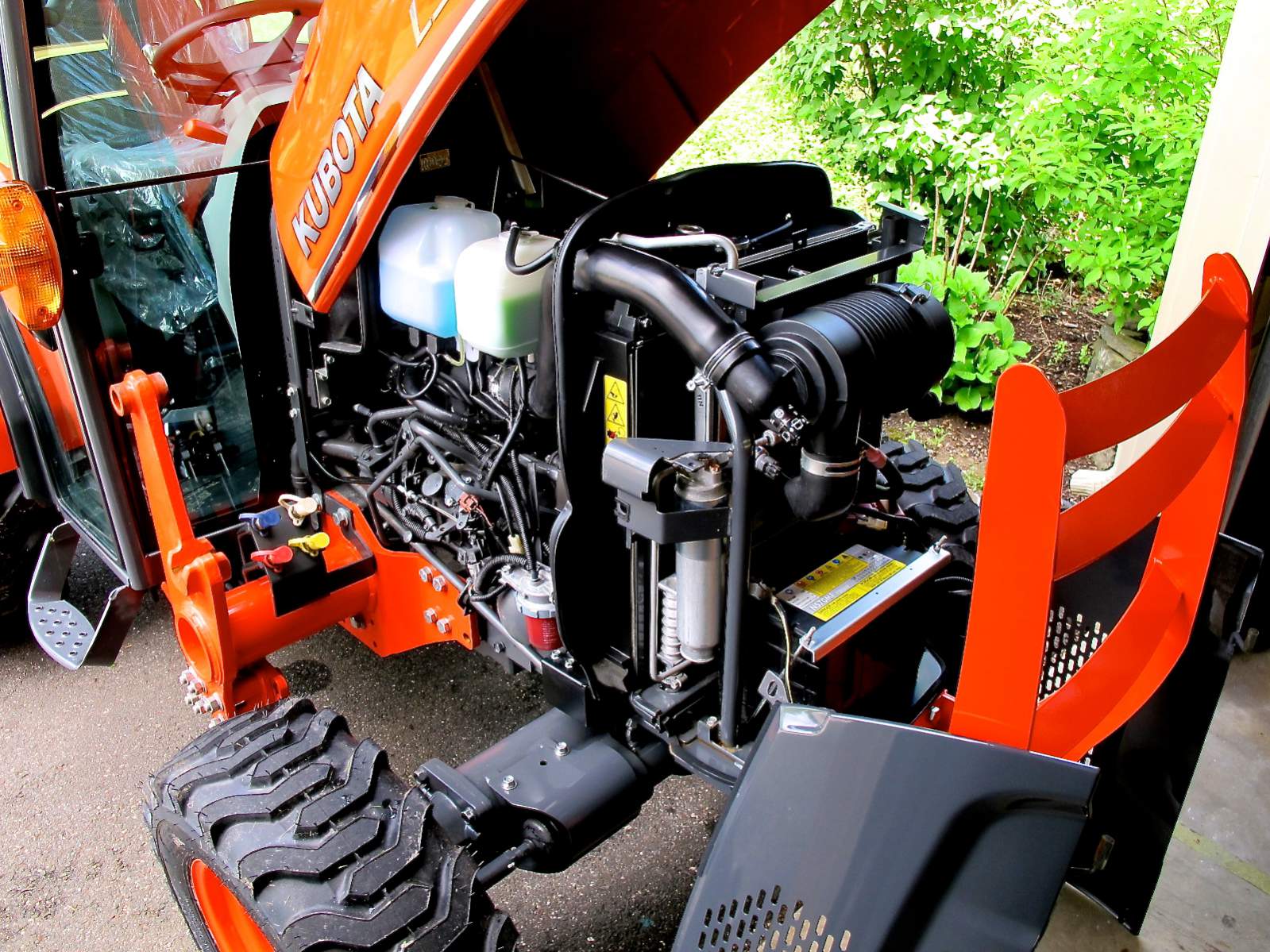

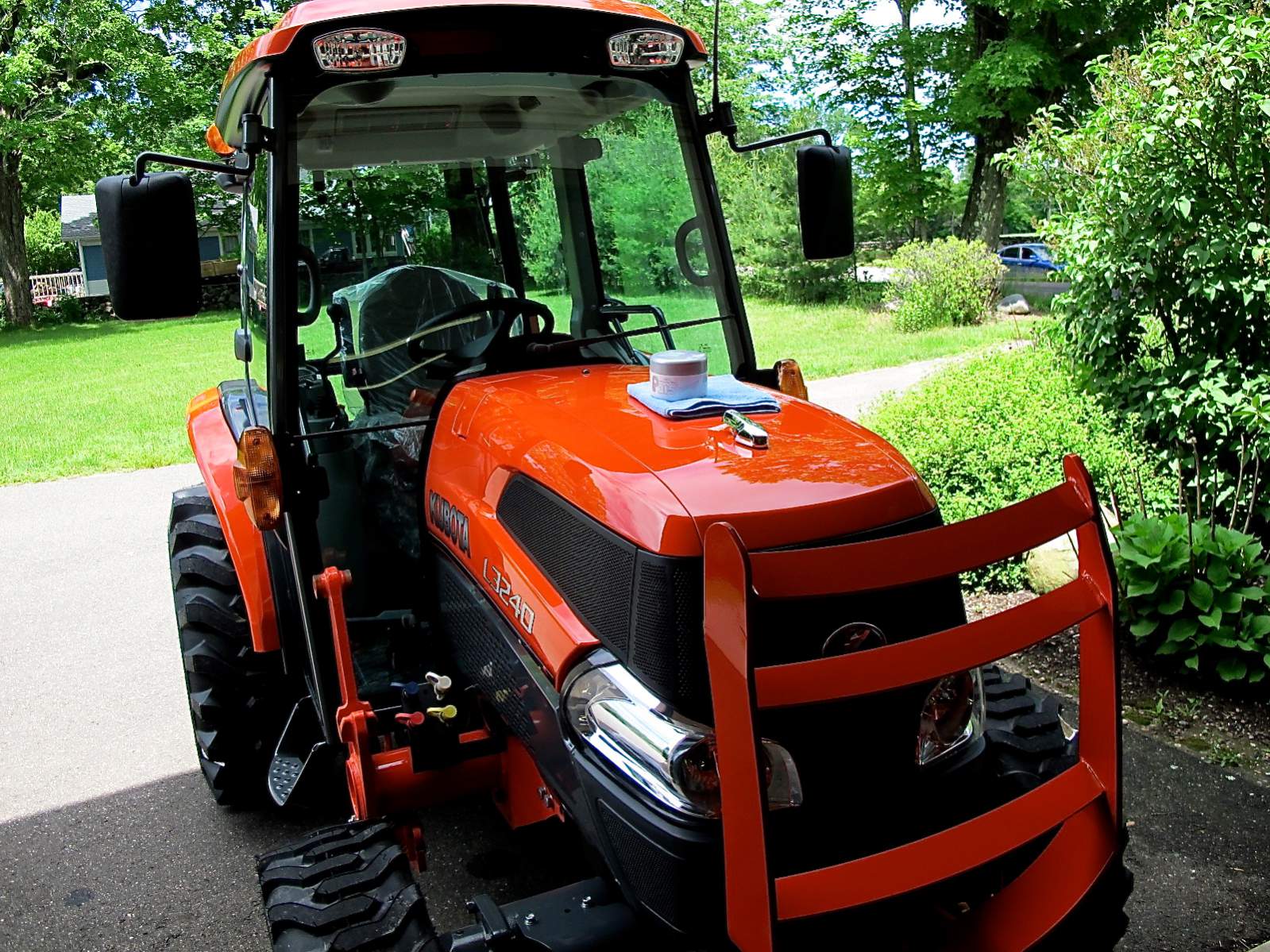

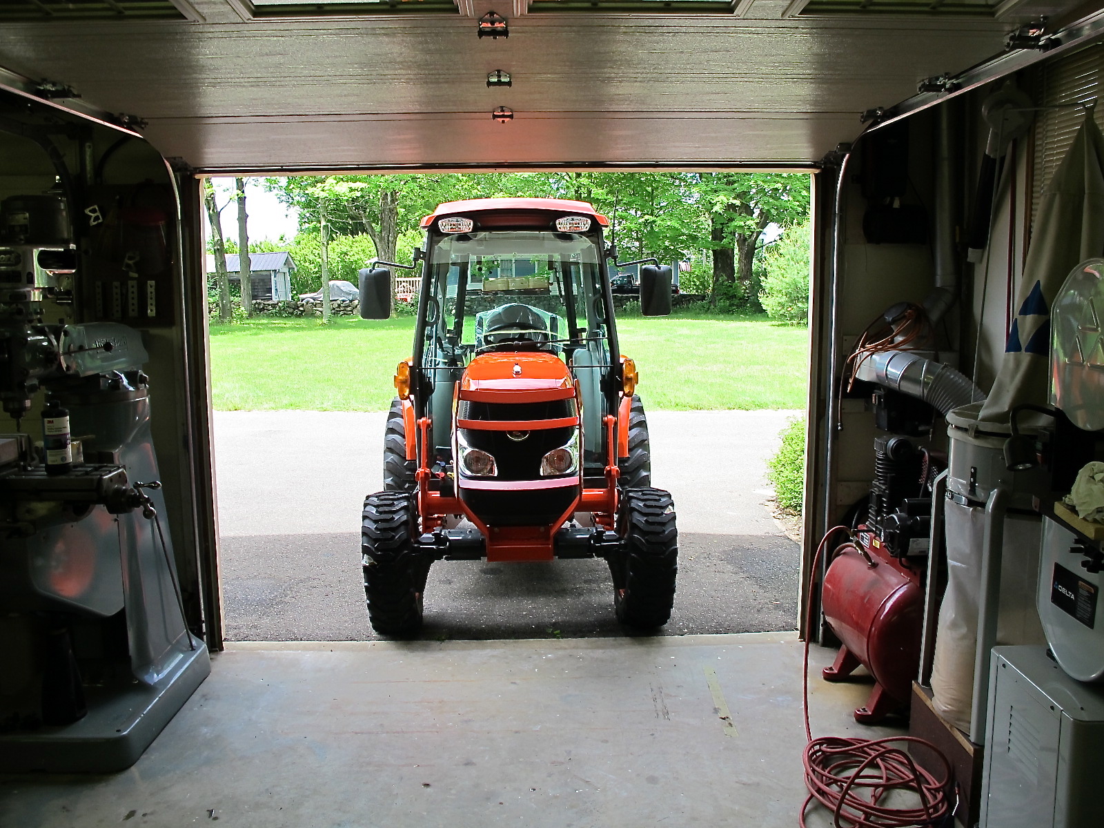

Thank you , do you or someone, know what the tire tracks are for the L3240?
The 3240 Specs say, Overall width (min.tread) is 59.8 inches. Does this mean with the stock factory tires on the L3240 a 66 inch bucket will cover the tire tracks?
The smaller L3800 tires on the tractor now have a width of 66 inches the rims are offset deep dish. I would really like to keep the 66 inch bucket or 60 inch bucket if possible. Could the larger tires leave a narrower foot print? It would be hard for me to believe since there're so big. Here are pictures of both. I really do not want a 72 inch bucket. But I do want to be able to back drag the bucket over my tire tracks.
As someone else mentioned the overall width at minimum tread is given with the R1 ag tires. As far as I know every dimension Kubota gives is based on Ag tires, the R4s are going to be a bit wider.
If you have the numbers for the tread settings you can figure out the various widths. If it gives a tread setting of 55" (which is the center line of the tires) then you just add the width of one tire to get your overall width. Best I can remember the ag tires on that model are 12.4" wide, so in this example the overall width would be 67.4". Take that same tread setting and put R4 tires on which I think are 16.5" wide and you'd have an overall width of 71.5". It lists the tread settings in the manual for the R1 tire/wheel combo, not sure if it does for the R4 tire/wheels.
If you want to stick with the 66" bucket I think it would work ok. It will be a little narrower than your rear tires at the minimum setting, but for most things that wouldn't be a problem, you're only talking 3" narrower per side. Unless you are excavating with it or cleaning up next to walls I don't see it being an issue.
