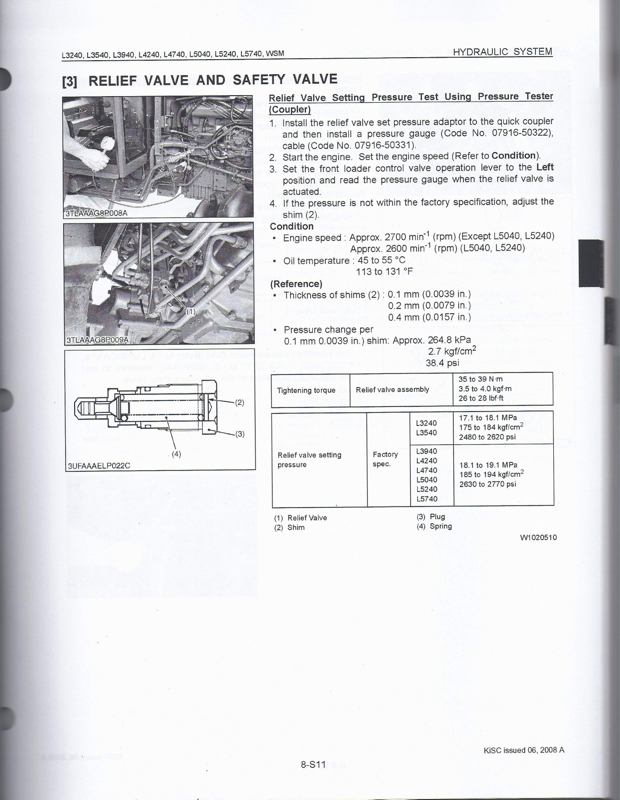

Check the psi setting on your relief valve to ensure it is up to its max spec setting. I could easily lift 2,000 lbs with the LA853 on the 5030 after ensuring RV set to spec. Have not tried yet with the 5740 but I checked the RV pressure and it is below spec from the factory.
Can u provide specs I have gauges but im waiting on my service manual. Also where's the adjustment? I assume tightening screw increase spring tension on valve causing high psi to unseat?
   / First Post: Just Bought GL5740HST Open ROPS R4's #15
The rated maximum is 2770 psi (see attached).
You adjust the relief valve by removing the poppet and installing the proper number of shims to get to the specified maximum.
You test your existing pressure by purchasing a glycerin-damped pressure gauge http://www.northerntool.com/shop/tools/product_200322889_200322889
and plug it into a FEL port with a QD fitting.
The attached page shows the detail.
Shims:
http://www.messicks.com/partdetail/31351-37970.aspx
http://www.messicks.com/partdetail/31351-37960.aspx
http://www.messicks.com/partdetail/31351-37950.aspx

Mine is at nominal at operating temp. It may easily lift a ton at the QA but a bulk grain tote is over 4 x 4. My pallet forks are very heavy duty so they aren't light. Lift capacity is 1878 @ 500 mm forward of the pins according to the book. The CG of a tote is at least 500 mm ahead of the pins when you consider the thickness of the QA adapter, main frame of the forks, and the distance out to the center of the tote. I suppose I could shim my relief to over omits he loader but why add the overload to the system when I do have a tractor that will do the job. What I was pointing was it will lift a ton, but back at the pivot pins.

Thank you so much for this detailed info my friend !!! I already own Hyd trouble shooting equip upto 700bar Ill get Teed up here and see what the helk is going on, right now without grapple the curl will not lift the tractor, which is different that any loader ive operated before but I'm unfamiliar with these small machines and wasnt sure. The internet is an amazing tool. Thanks again.

This is news I like to have thank you!! This lack of performance is concerning to me. Break out force is everything when considering performance of a loader. I suppose I will ensure hydraulics are at max spec. And no higher then if I'm still unhappy i guess a complaint via the selling dealer to Kubota dealer is in order as the dealers service has been great but this is an engineering prob. Thanks Again

I suppose that the height of the loader during the lift is also a factor. I have not yet tested the LA854/5740 with a scale, but with my prior LA853/5030, I lifted pallets of sod, scale weighed at 3000lbs. Albeit, the whole lift and transport was only about 20 inches above the ground, but it did it. This was with the RV psi set to just under maximum specified.
Without verifying it, the LA854 does not "feel" as strong as the 853. I did check the RV pressure as delivered from dealer, and it is 370 psi below the rated maximum of 2770 psi.
I have the shims but have not adjusted as of yet.
