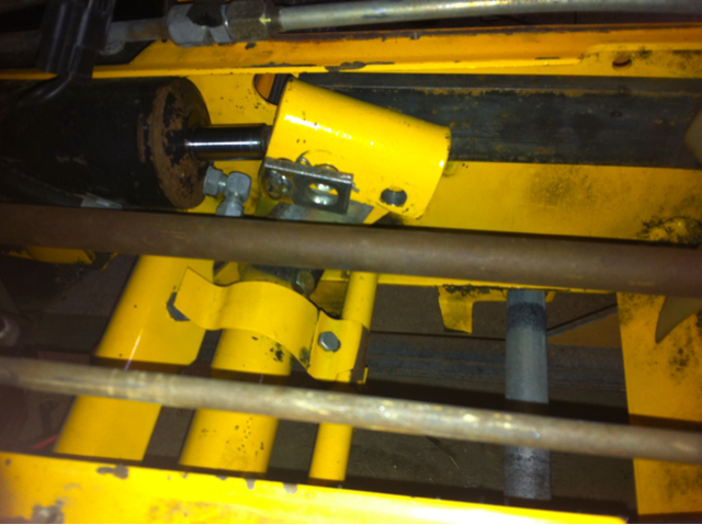

I just don't have space for anything more than hand held tools. Everything was cut with a 4 1/2" angle grinder and drilled with a cordless drill and welded with my Lincoln 220
I had to build this thing to bend the lower arms.

Looks great. Do you have Any photos of the connection to the cylinder?
No, but I will get one in the morning.
The unpainted bar going out of the picture on the right is for the 3 pt. It doesn't pin directly to the cylinder, but to the clevis piece that locates the cylinder. Hope that makes sense. Kind of had to explain.
