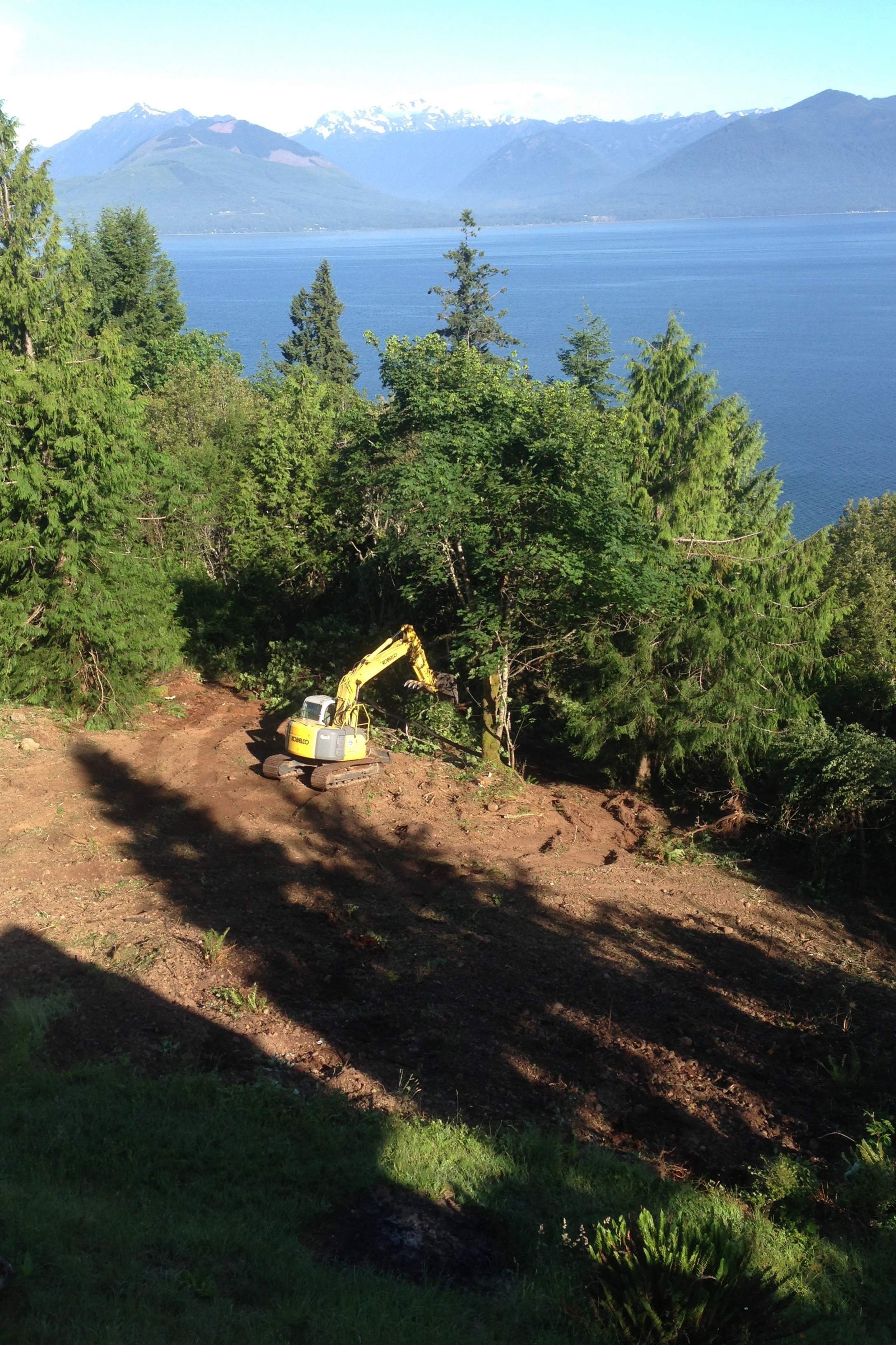

I was definitely thinking about a tooth bar after seeing the many accessories available. Any advice on brand? How easy to install? Are we talking about drilling holes, welding? I have only briefly looked at one... Piranha tooth bar from BXpanded. I would be using only for dirt work, gravel, etc. no brush. That was taken care by the excavation work I had done. On the other hand, if I don't figure out how to manage the slope, the brush and maples will be back! Photo is looking down from my deck. Steeper than it appears.

What a beautiful view! The BX is nice too.:laughing:

Thank you... no complaints :cool2: The reason why we bought the place... a million dollar view and why I have to keep it cleared! :D
