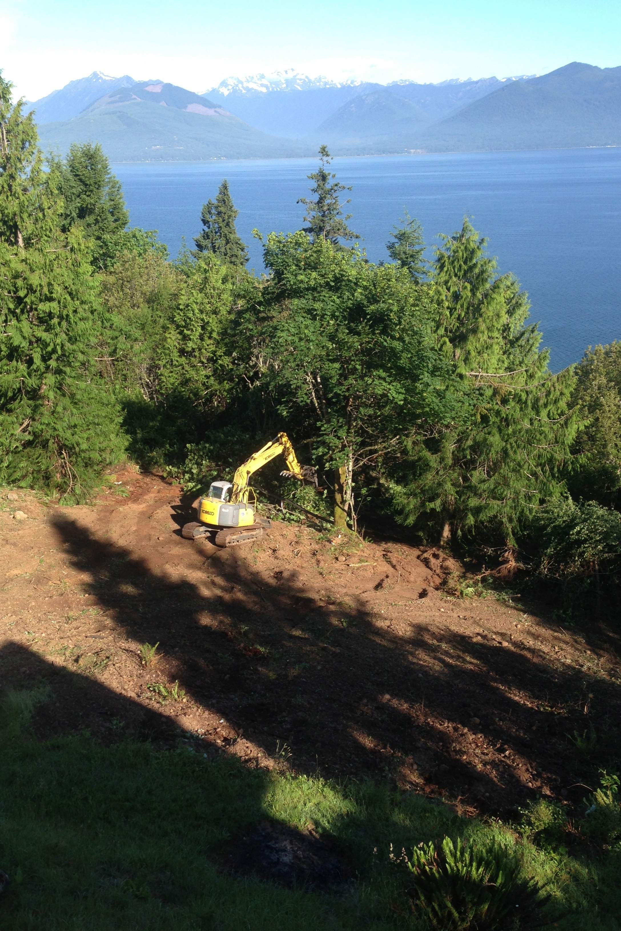

I was definitely thinking about a tooth bar after seeing the many accessories available. Any advice on brand? How easy to install? Are we talking about drilling holes, welding? I have only briefly looked at one... Piranha tooth bar from BXpanded. I would be using only for dirt work, gravel, etc. no brush. That was taken care by the excavation work I had done. On the other hand, if I don't figure out how to manage the slope, the brush and maples will be back! Photo is looking down from my deck. Steeper than it appears.

You definitely need to look into a box blade for your levelling and grading instead of just the front bucket. We have a 48" that's very handy for such work with our BX.
Beautiful place, by the way. But, obviously, be careful on that slope!

Lots of good advice hear. All I can add is I was in the same boat about 5 years ago. I'd never had a tractor, but I learned as I went. With my loader, I've gotten to the point that I'm at least adequate using it and I can almost always get the job done. Looking at your pictures, I'd say you for sure want to work and drive up and down the hill, not side way. Like others have said, you might want to use the backhoe to get the flat areas started, and then use the FEL.

Cutting a level road into the side of a hill really isn't hard. As mentioned before. the loader "tilt" is controlled by the rear wheels.
Let's say for sake of reference, the uphill side is on the left. To start, angle the tractor slightly up hill. Take a cut with the bucket while turning left into the hill. The cut should be on the uphill side and if you have the tractor angled correctly, will mostly load the left side of the bucket. Back up a little more than a tractor length, and while reversing, turn the steering wheel to the left swinging the bucket to the down hill side. Dump the dirt where your low side rear wheel will be on the next cut. Repeat the process as you progress, cutting from the high side and dumping on the low side. Obviously, you'll need to smooth the dumped dirt as you go, since the humps and bumps will raise and lower the rear wheels which has the opposite affect on the loader bucket.
It takes some practice and a tooth bar to make real headway.

The reason why we bought the place... a million dollar view and why I have to keep it cleared!
I think your assessment is a tad low... wow!
Yes dodge man, that is becoming very evident in practice. I also think it will be necessary for a beefy tooth bar on my FEL to handle the very rocky soil.
Yes maybe so. I have been lucky as my job has allowed me to travel much of the world and I think I can pretty much unbiasedly say that this is as beautiful a place to live as there is all things considered, even with a lot of gray days! :D
