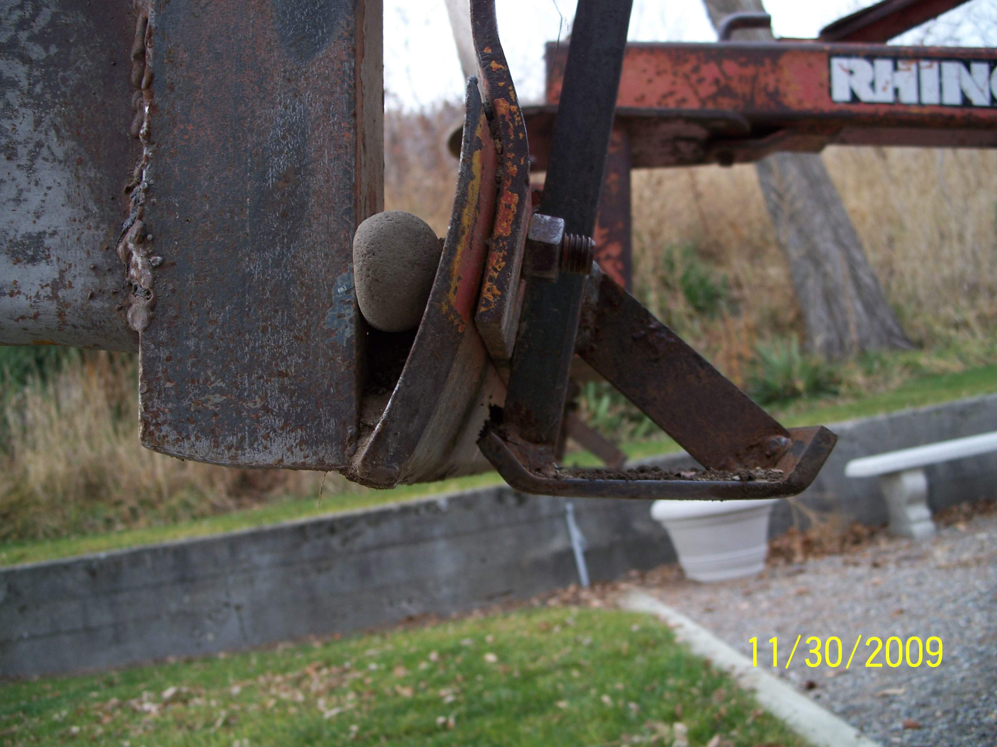

/ First serious box blading. #9
I built and attached "shoes" to my blade.
They really help on the bumps etc when blading the drive.
Sorry about the size of the pic.
By adjusting the top link, you can adjust the height of the
blade slightly also.
