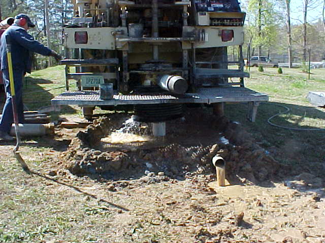

This is the first water test to see how much water flow we had.

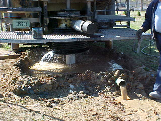

Another view

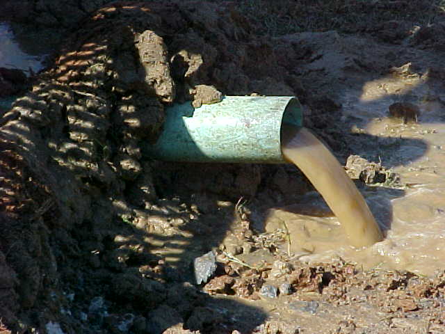

Water flowing from a 4 inch pvc and it was timed as a gallon can was filled. This told them how much flow there was coming from the well. I was 0.95 seconds to get a gallon can full.

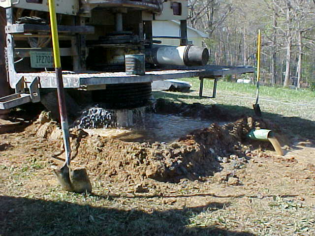

side view - you can see the water coming out of the pvc that lines the first 75 feet of the well. Also you can see th flow of water coming from the test (green pvc)

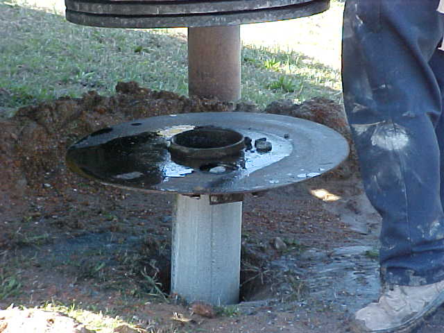

This is a picture of the PVC Flange they used after seating the PVC pipe in the first 75 feet of the well.
