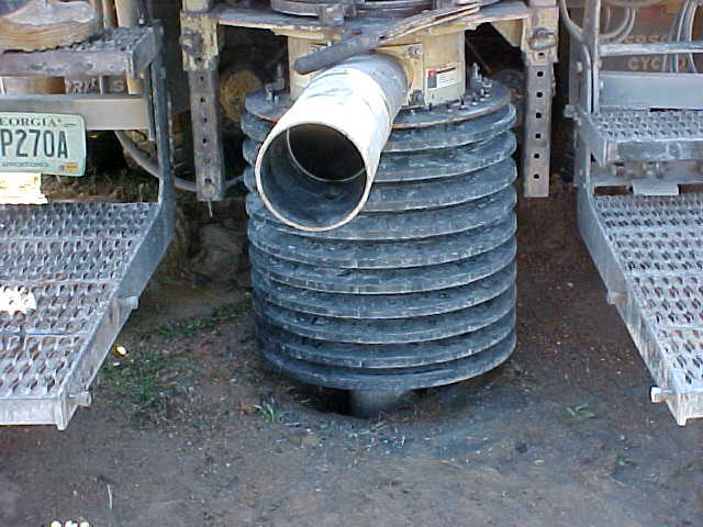

#531
This is the accordion type system that goes against the flange after seating the flange on the pvc. It is held against the flange with air pressure.

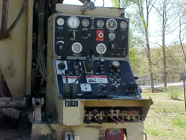

   / First Serious Project - Clearing 1.5 Acres
#532
The well drilling truck - the tan one - cost around $500,000.00 not counting all the bits. This is the main control panel.

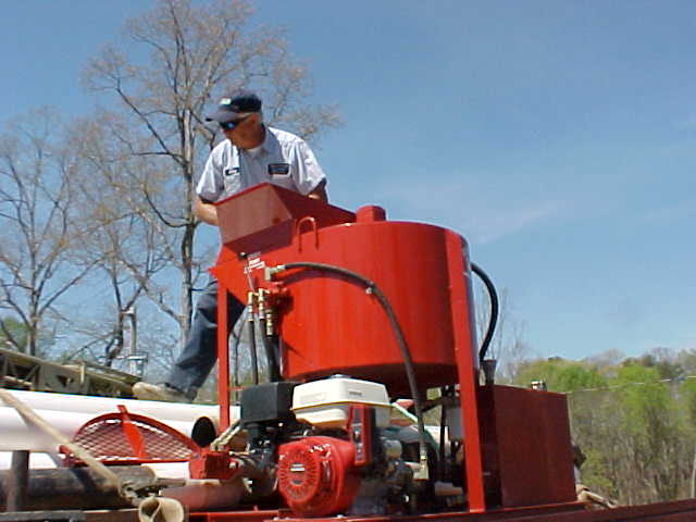

#533
This is a picture of the Grouting Machine they use to grout the PVC casing of the well.

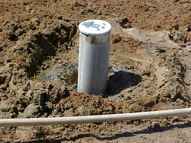

#534
The area around the PVC Casing pipe is prepared by daming it so the over flow of Grouting doesn't run off.

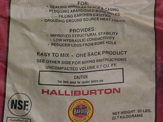

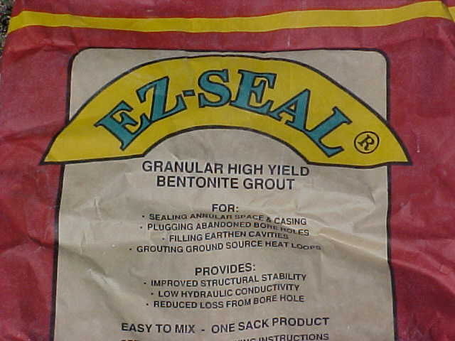

#535
This is the bag of Grouting material used to grout the PVC Casing to meet SC codes.
#536
Bottom Half of the bag. You should be able to read all of the print on bag.

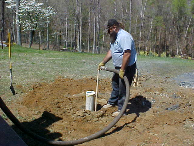

#537
Pumping in the grouting material after it was prepared and mixed in the grouting machine.
#538
Another view of the Grouting Machine. It was operated by a 13 hp engine.

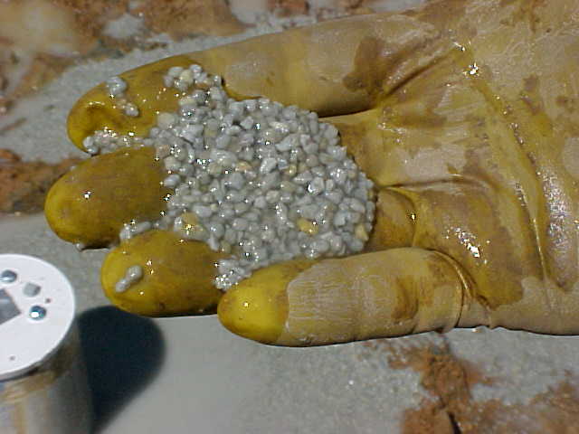

#539
A Close Up of Grouting Material after it has been mixed.

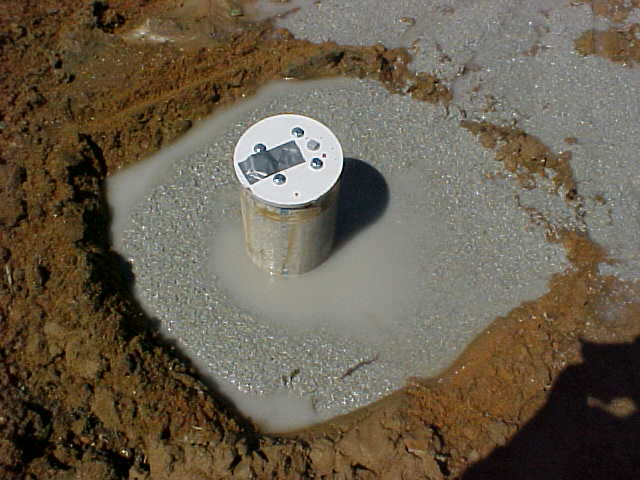

#540
The Grouting will expand as it dries and secure the PVC Casing in the ground for the 75 feet where the PVC Casing meets the rock. This also seals the well from any contamination from the ground water. This is a picture of the top where it came out above ground level before it was smoothed and covered with dirt.
