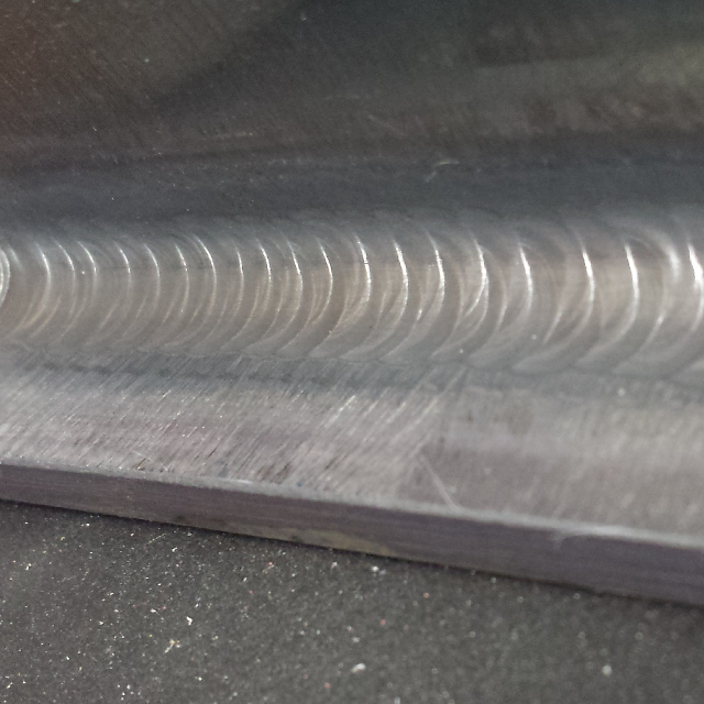

Looks good, Weldermike.
You're a pro for sure. :thumbsup:
/ First TIG welding class
#9
I always found aluminum was way easier when i was younger, and still to this day to be honest. Its a faster process so to speak but not so micro fine as with the steels. I feel i have more time to think with aluminum then with such a real quick wet out with the ferrous metals. I handle both fairly well but love tigging aluminum.
Very impressive looking welds.

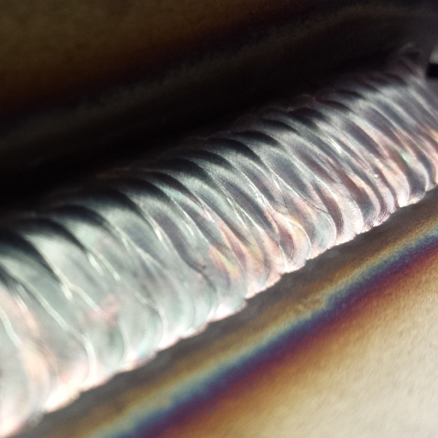

Gotcha bud. Stainless will produce some beautiful colors sometimes, but that has nothing to do with quality of the weld but some new guys eat it up and love it. Heres a stainless weld, border line of hot but ripped out fast to stay ahead of boiling it out. Absolutely no color, and one of a pretty one leaving rainbows behind it. Nothing wrong with either.
/ First TIG welding class #15
I don't do much with a tig anymore. But did lots at my last job. I am not sure on the rainbow effect, and if it has to do with grade if material, but I never got that using filler.
But would get it every time when doing thinner metal in a joint that didn't require filler.

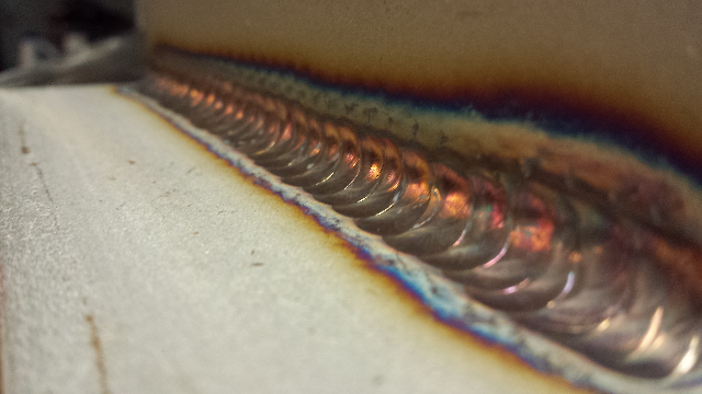

Stainless flows the nicest and is the easiest to see. In school we only worked with thinner stainless. The back side turned black from carbide precipitation but since it was just practice welds, we didn't worry about it. Experienced TIG welders can make the weld turn out a nice gold color with just the right heat.
/ First TIG welding class #18
10/4 bud, gold means you nailed it across the board. Speed, travel, feed and heat.
