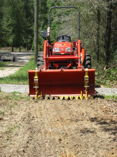

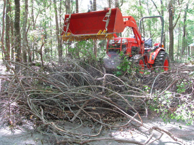

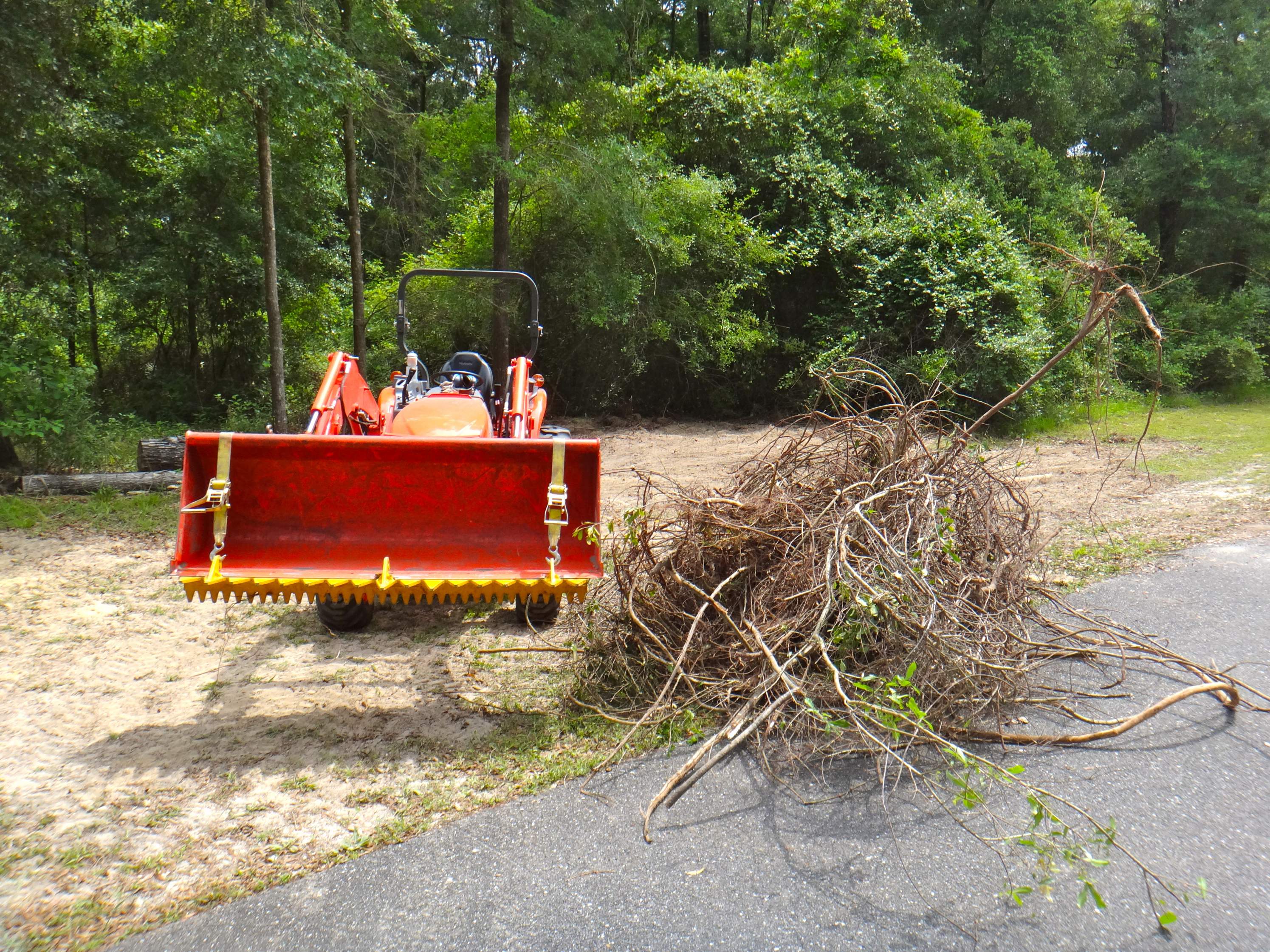

A Ratchet Rake bucket attachment is superb at knocking down brush and minor grading, BUT YOU CANNOT DIG WITH A RATCHET RAKE ATTACHED. A Piranha Tooth Bar bucket attachment is fairly good at knocking down brush, very good at digging but LESS EFFECTIVE AT GRADING. Get one or the other bucket attachment for your woods work, driveway work and garden needs.
The T-B-N STORE, button at top of this page, sells the Ratchet Rake.

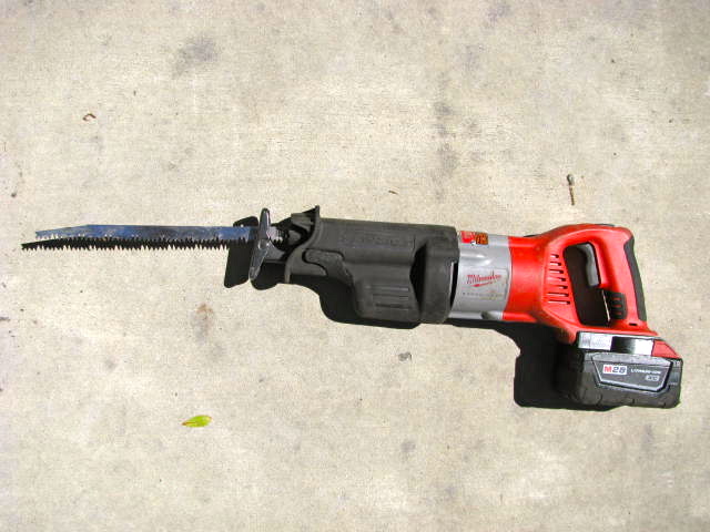

For 2" material and staying with tractors on your list, consider a good quality, battery powered reciprocating saw, with a 9" pruning blade or 9" Milwaukee Sawzall brand 'THE AXE' blade. For 2" material a battery saw is faster and much safer than a chainsaw.

Ratchet Rake is the right bucket attachment for de-vining. I have years of experience removing wild grape and wild climbing rose.
Would a land plane level bumps in a grass meadow?
BUMPS is an imprecise term. The Ratchet Rake might suffice solo. See Photo #6.
The ability of ground contact implements to cut is proportional to weight per unit of width. This seems hard for tractor newbies to grasp. It the grass is scalped in the meadow, and the soil moisture is optimum, a heavy LPGS should smooth fine. Your meadow is only one acre. The videos should have given you a good idea. However, local conditions make a significant difference and you are in Oregon and I in Florida. Discuss with your dealer. If you acquire a roto-tiller it will help smooth your meadow. You would likely want to overseed after smoothing.
LAND PLANE OR BOX SCRAPER LINK: Google
SMOOTHING PASTURE LINK: Google
SMOOTHING MEADOW LINK: Google
