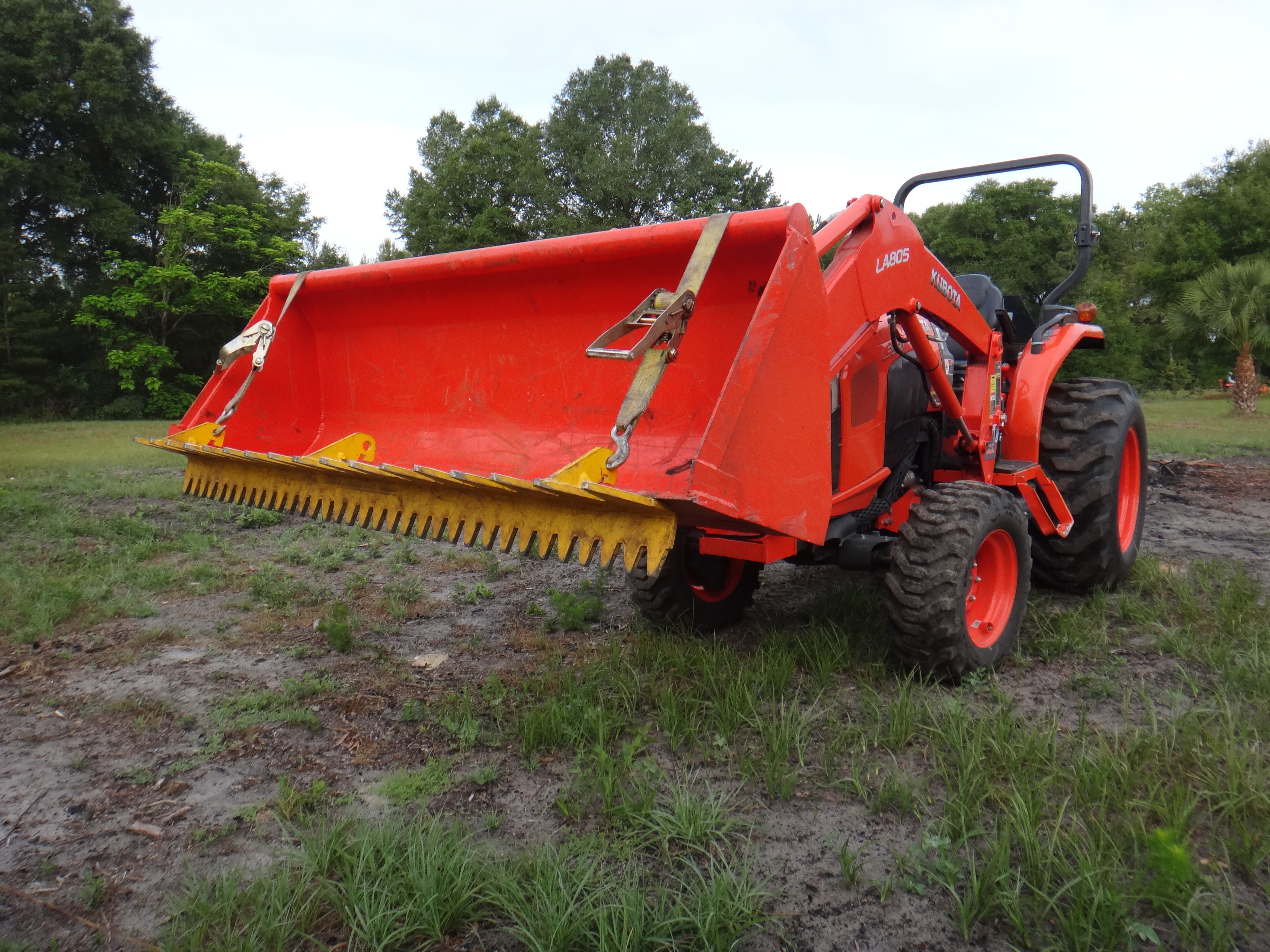

I smoothed a four acre field for a friend today. Ratchet Rake on the FEL bucket, Bush Hog (brand) Rollover Box Blade on the Three Point Hitch.
For swells 18" to 24" high, I used the Box Blade rippers to cut through the Bahia grass and initiate grass + dirt move. Followed by the Box Blade cutting edge to collect and transport greater ( 5 X ) volume of just exposed dirt to depressions.
For minor swells around 6" high, I back dragged with the Ratchet Rake. The lower, vertical teeth cut through the Bahia and pulled about 2-1/2" of soil to low spots each pass, with the tractor moving in reverse. Worked great.
Soil moisture was optimum.
Here are three photos I took today. Sorry for Photo #3. It opens correctly oriented.
Photo #1 illustrates why you CANNOT EXCAVATE with a Ratchet Rake attached to your bucket.

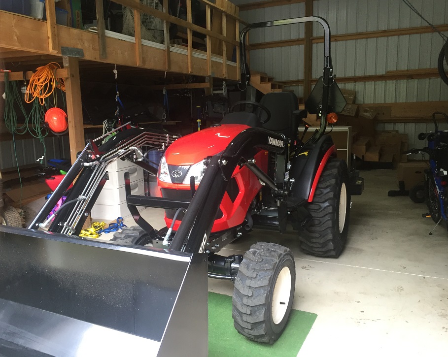

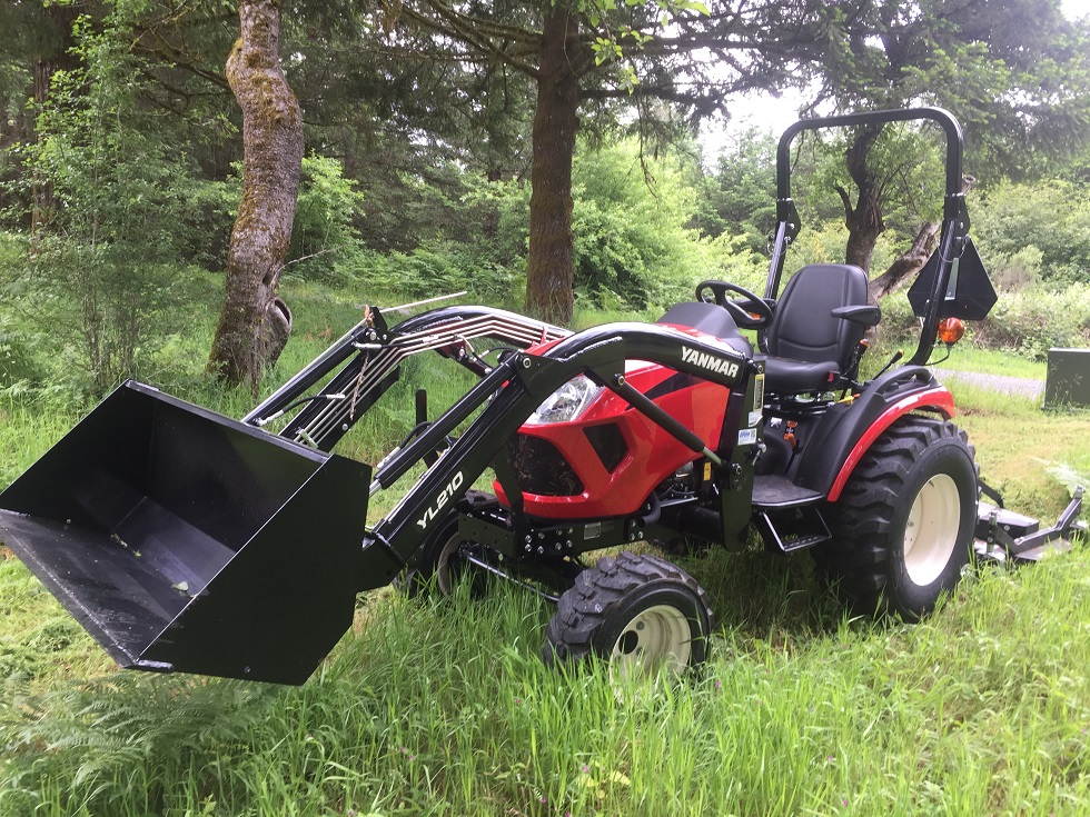

Dealer decided to deliver today so I was able to get my fist couple hours in. Managed the mowing that usually takes 4 hours on my old riding lawn mower in about 2 hours.
Definitely made the right choice with the 60" finish mower.
So far so good. the tractor is easy to operate, comfortable and capable.
Plenty of room in the barn still for more attachments!
