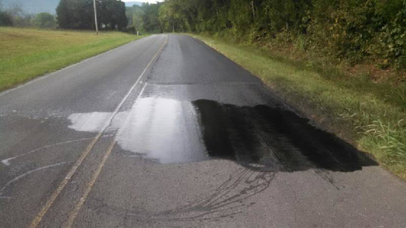

Hmmmm, what to do with the oil...
We have all seen those liquid streaks on the highway that don't seem to go away when the sun comes out. I suppose if we went onto the dark web we might find a company that does this and will even come to your place to pick up the oil for a fee. There are some pretty creative folks out there!
Don't be surprised though if you see that liquid that wont evaporate just outside your driveway when you come home from work... The first thing you will hear yourself saying is; "Heck, I could have done that without the added cost"
