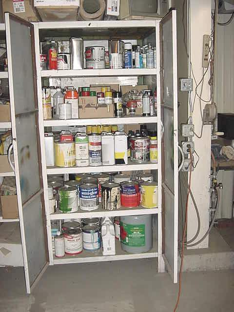

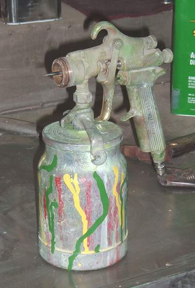

A lot of industrial primer is rated for tightly adhered rust.
