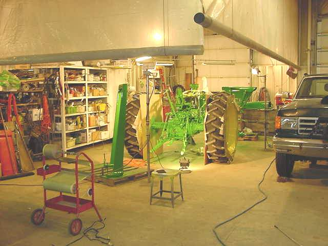

Nice paint booth. That looks small for a 4020, especially the steering wheel. You will have a lot of hand painting to do on moving parts unless you were able to move them while painting.

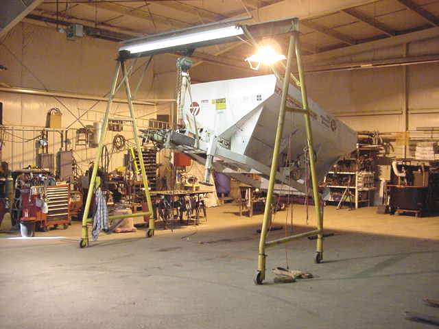

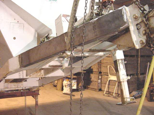

I flip stuff around to paint and used a pressure pot so the gun would spray all position. It's really stripped which helps and my booth is big enough I can lay out a whole tractor.
The pictures might be from various jobs, some this more than once. I like rigging on pallets if I can, turn in progress or stage and can stay up wind put the stuff in the air stream, the booth clears very well.
