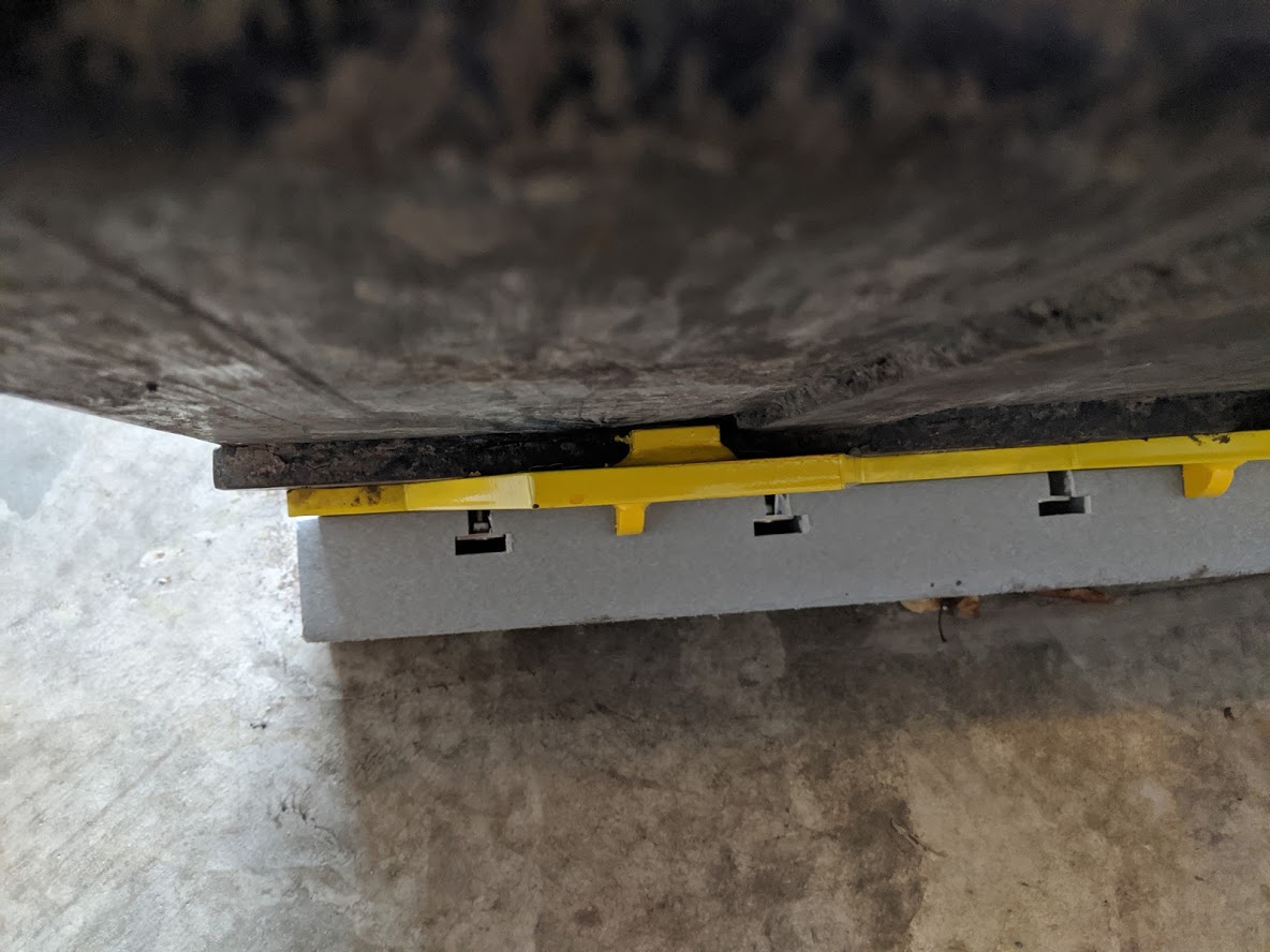

One thing about the snow edge I wanna throw out though, it uses screws to mount on the bucket, like when you mount forks. But whereas my forks have a puck on the screw tip to spread out the surface area contacting the bucket, the snow edge is just the screw tips clamping on the bucket. I was worried that's gonna dimple the bucket, called them about it, but they assured me that the little tabs that fit underneath the bucket support the bottom of it where the screws would meet, keeping the bucket floor from dimpling.
That's not quite the case though, at least not with my bucket. Mine evidently has a thicker wear edge on it, so that the tabs underneath don't come in contact with the bucket floor, there's around 1/8" gap. See pic:
Consequently, yes it does dimple the bucket, you could kinda see it on that pic if you look carefully. Whether you care or not on yours, that's up to you. I don't care much, I accept my bucket will get dinged here and there from the abuse I put it through. But, just putting out a fyi.

Gene,
You could just put an 1/8” shim in that space to to adapt the device to your bucket and avoid dimpling.

Gene,
Yessir, that's what I was thinking too, although it would be a bit of a pain to slip shims in there while trying to mount the blade. I didn't see that gap when I mounted the blade, only noticed the bottom side of the bucket when I flipped it to let it drain when I parked the tractor.
