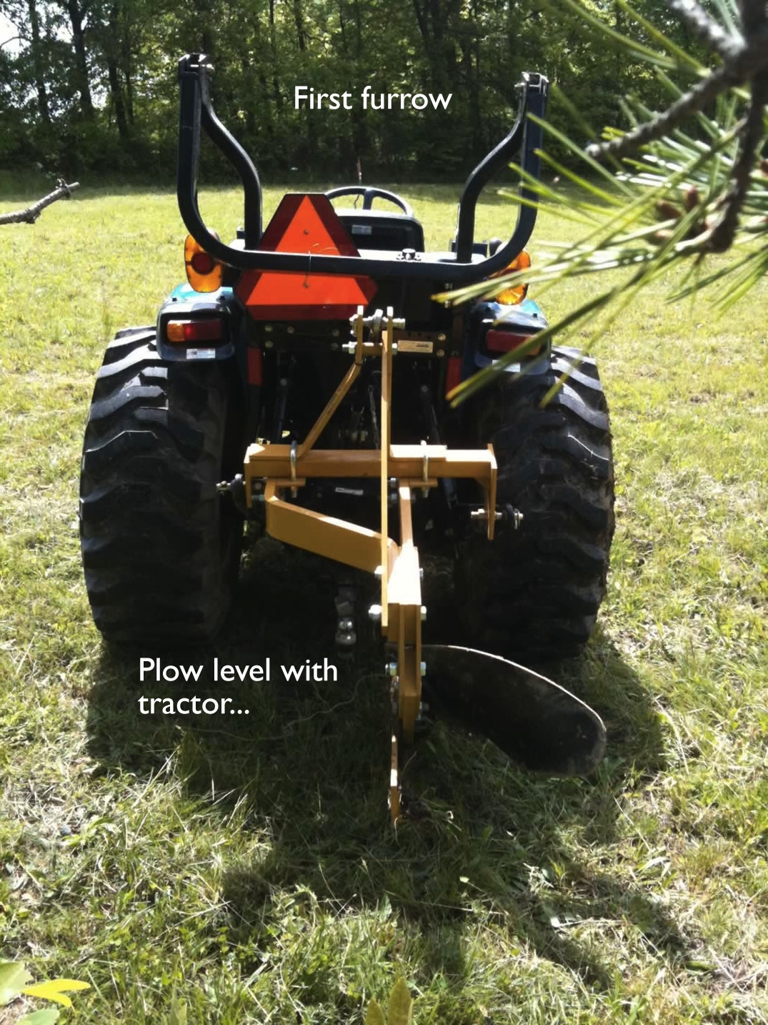

Got out this morning and walked the previous day's battlegrounds and did my reviews and checks and set out for the vineyard area. Attached are some images of my set up in garage and in the field.
It was a good day and I did better today. Still had some 'ups and downs' with the plow digging in. I ended up working the 3pt lever as subtly as possible to keep from making craters.

Hey, that is sooooooooo, much better. As you note, you have to make only very minor adjustments of the 3pt. Still, to me, it seems as if you are plowing very shallow. Hard to tell for sure, but from what I can tell from the pictures, you seem barely below (and sometimes not even) the roots of the sod. I would think your deeper sections are what I'd consider good, or even the minimum. You have the R4s, so you'll be somewhat more challenged, but in 4wd you should be fine. A coulter would be nice in that thick sod too, but you you've got to use what you've got. A little bit of speed might help in flipping too, but it looks like it went OK at the current shallow height, but you may need to increase if you go deeper.

DJ, that 'shallow then deep' is an issue I'm not sure how to control well. I did another few rows for some blueberries we'll be putting in and had the same issue....
I plowed the first furrow with the plow level with the tractor, I set the plow full down (lever all the way down), and it dug in, but dug in DEEP so the tractor could not pull. So, I slowly lifted the lever up to where I thought enough dirt was being lifted and the tractor could still move.
I got the first furrow fairly even, but not deep as I think it should be.
On the second wheel in furrow, adjusted the plow to be even with the ground and once again put the lever down, but not all the way down and it moved along fairly well, but still ended up digging in deep at points. Then I'd have to once again lift the plow up and compromise the even depth of that furrow.
The ground is a slope, but I'm plowing across the slope so the ground is not uneven, it's all even ground, so I'm not sure why at times it's fine and then suddenly it digs in. Maybe I still need to fiddle with the top link adjustment.
Anyway, in the end, I'm having to constantly lift and lower the plow just to make it across. From what I've been reading online, I'm thinking I may need to buy a guide wheel.
I'm not really frustrated, just seems like I'm not doing something right or something. I still really enjoy plowing though. :thumbsup:

I think you are right. You haven't found the balance point where the weight of the soil on the moldboard equals the resistance from the ground below. Your plow being a one bottom and pretty light may be hard to get just right. The foot of the plow (The vertical bar that rides along the edge of the furrow) is quite short and thin so it can knife into the soil instead of running along as a runner supporting the plow at the right height. A gage wheel might be the answer but first I"d try adjusting the top link a little longer aiming the point up a bit to find the balance point. If you go too far the plow will start to climb out of the ground, then you can go back shorter. Even the expert in the video made ten adjustments to get it right. :cool:

Yup. I saw his constant adjustments over about a 4 row period. I'll work on it.
