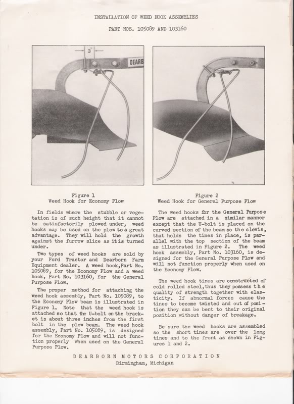

When I was a child and learning to drive a tractor on my grandfather''s knee, he told me that to get tall or difficult growth to roll over cleanly one needed what I now remember to be "weed drags." He said they would use a length of chain or very heavy gauge wire, sometimes dragging a weight behind the wire. He also said there were some plows that had short spring wires attached to the plow itself. I found pictures of the weed hooks posted at DEARBORN PLOW WEED HOOKS by Tim Daley. I have attached them so they can be accessed if the original website goes down.
I also think a coulter blade would help. In plowing sod, I've noticed that frequently the trouble is the plow will lift the soil, but not be able to flip it. The coulter helps with that by cutting the roots, and the chain drag or weed hooks would hold the sod against the moldboard so it can be flopped all the way over.
I'm surprised your tractor isn't able to pull that plow deeply. Are your tires filled? I would, at the least, go get a bucket full of bricks or dirt to weight the front axle so it will pull a little more, but filling those wide rear tires, if they aren't already ballasted, will allow you to let the plow go deep and still make forward progress. Once you have turned over the soil and then disked or tilled, it can be worked so it is a smoother surface. Next time, it will be a lot easier, since the up and down motion of the bumpy surface won't drive the plow deeper or pull it out so frequently.

284, I always enjoy learning from 'old tyme' techniques and 'technology'.
So far, my plowing slope side down, getting gravity to help, has solved my 'flipping' problem. But those weed wire attachments may serve some future purpose. Thanks for the pointer and story. I'm hoping to have this plowing thing down before I have a boy of my own on my knee learning.
