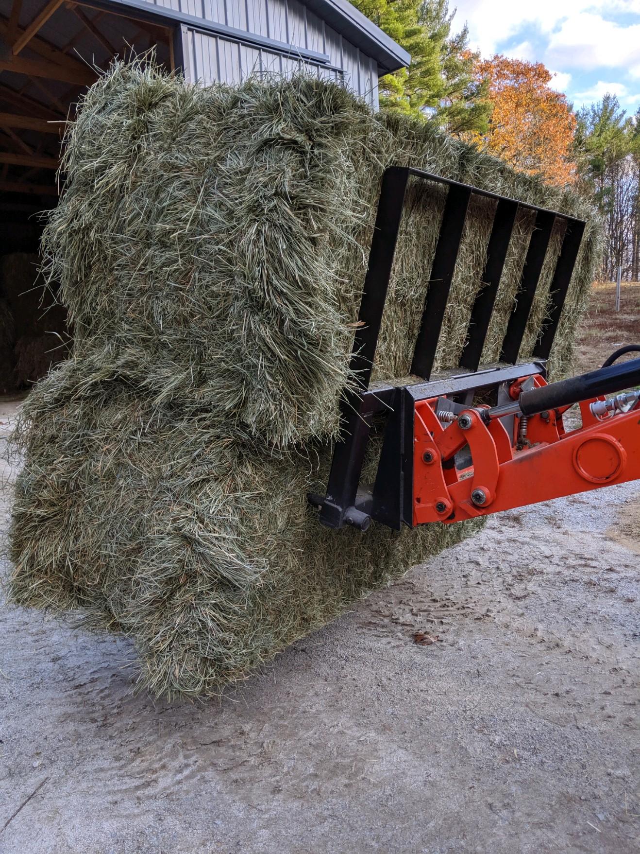

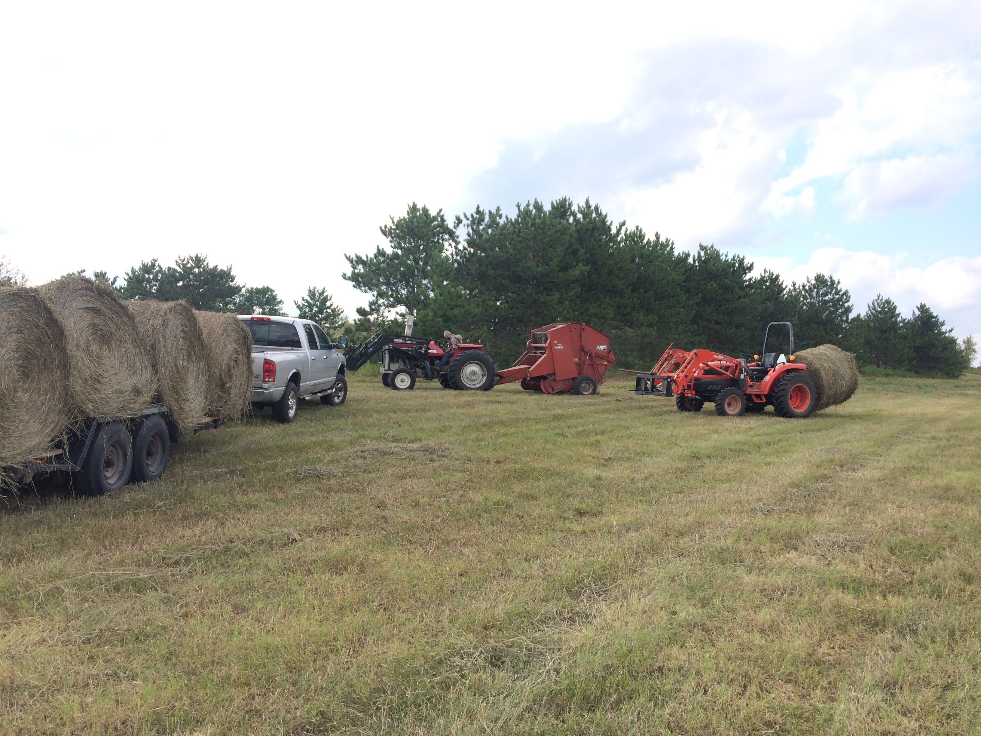

I'd get a ~4000lb tractor with 50+hp. Then you can lift bales carefully without something on the 3pt and run good size common implements. I can't really think of a time my tractor has been too big but it could use another 20hp to run my buddies old round baler. He keeps buying and fixing old farm equipment and its convenient that my tractor can run most of it at times when his tractors are tied up or in the shop.
For brands I'd limit it to your local dealers and get a sense of who will back you up if needed. Kioti happened to have the best dealer near me, and be cost competitive so it was an easy decision. I think this website is the best for researching individual tractor models for issues so do some searching here once you narrow down which dealers you want to deal with.
   / First Time Tractor Buyer . . . need some advice! #18
I'd get a ~4000lb tractor with 50+hp. Then you can lift bales carefully without something on the 3pt.
I wouldn’t bet on that.
   / First Time Tractor Buyer . . . need some advice! #19
Neither would I.
