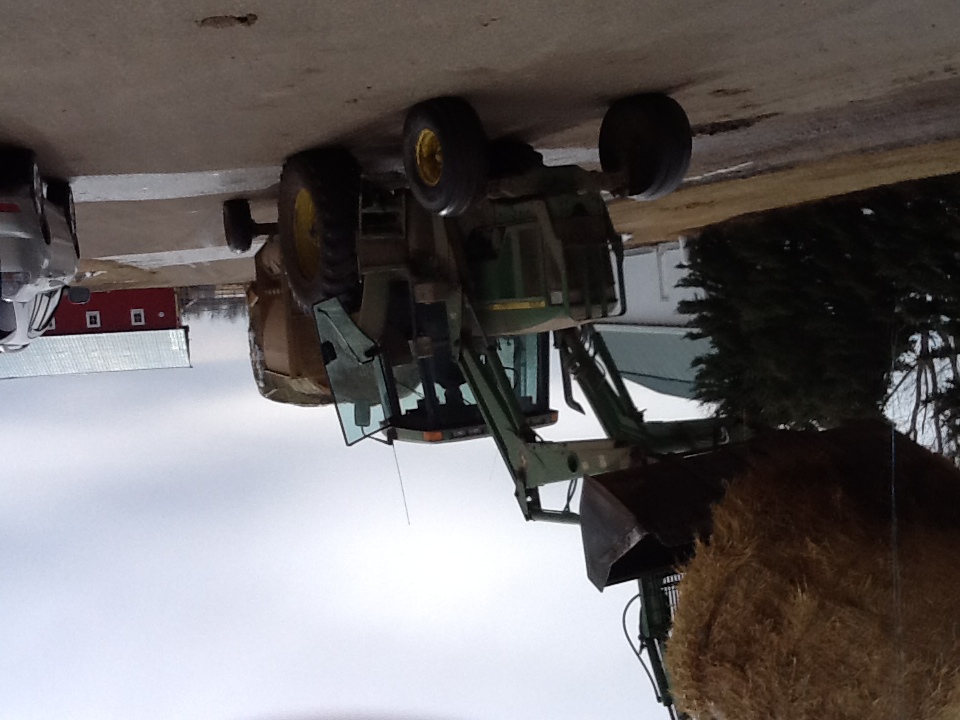

Tractor data has mine at 4100lb bare, then maybe 8-900lbs for both rear tires loaded(R1's don't have the volume of R4's), then the loader is 900-1000lb with bit of a subframe. It works for me anyways for 4x5 round bales in the 8-900 maybe 1000lb(wet one?) range, even pops them off the ground if they've frosted in abit. If you are putting a spear on a bucket then you start to get the weight way out front which is not what you want, but with a ~100lb ssqa spear on it doesn't seem to be a big deal. The last bale on the load of the trailer is always put on with only the bare 150lb 3pth spear on and I can manuever around in 2wd no problem with only a bale on the front.

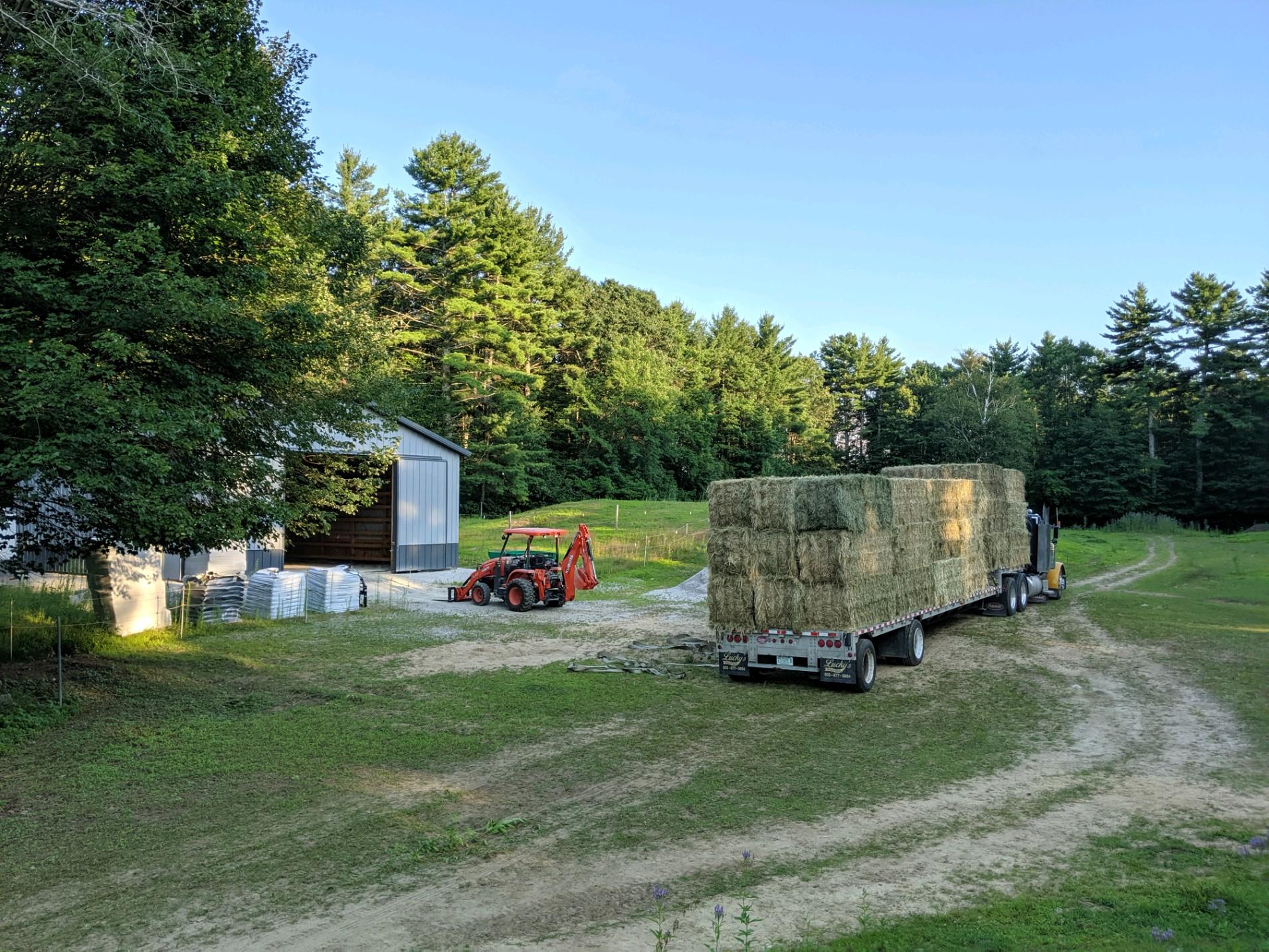

Having a tractor big enough to load and unload a trailer like this would be useful IMO, and really for hay the only thing my tractor can't do that 65hp MF can, is run the round baler. We tried but once the bale gets to 4' I'm running my tractor too hard just to turn the bale in the machine.

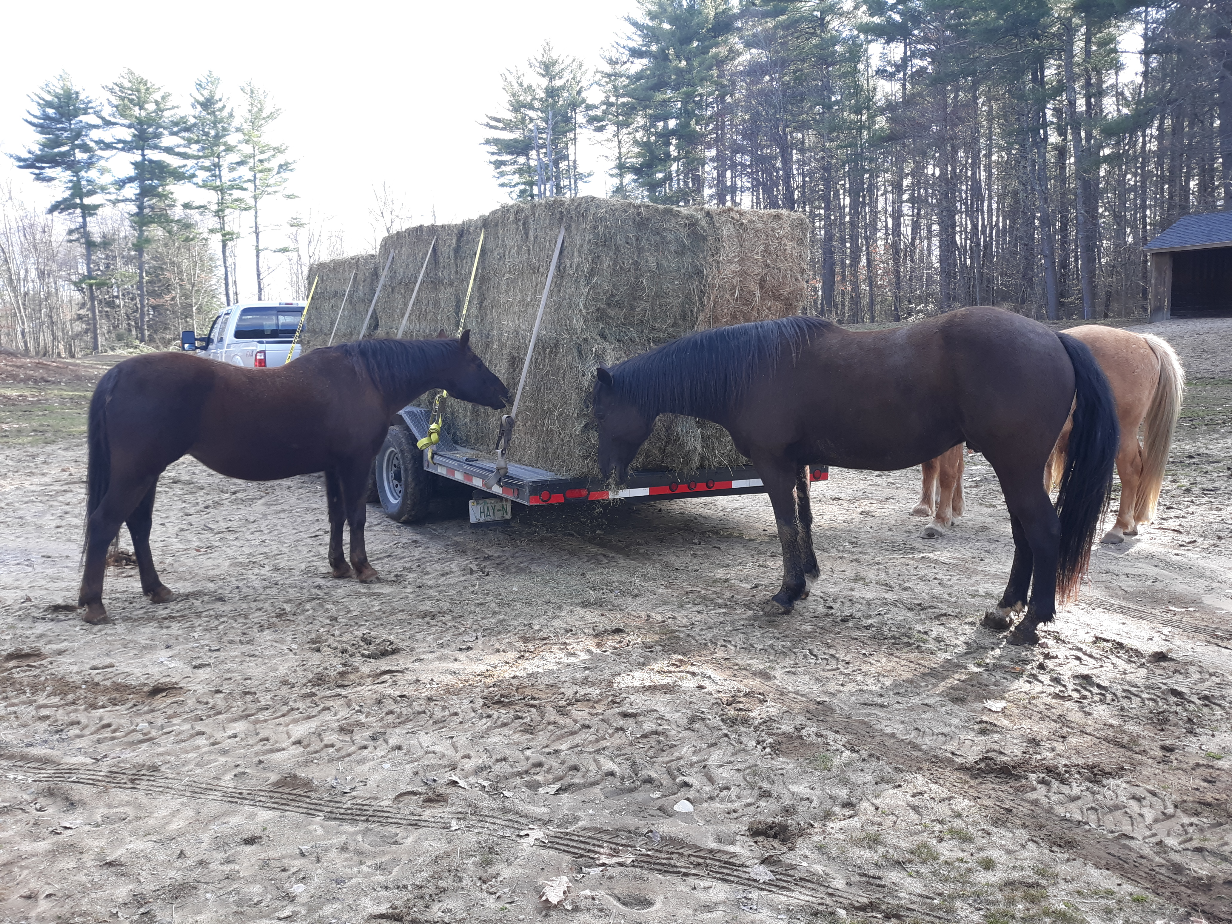

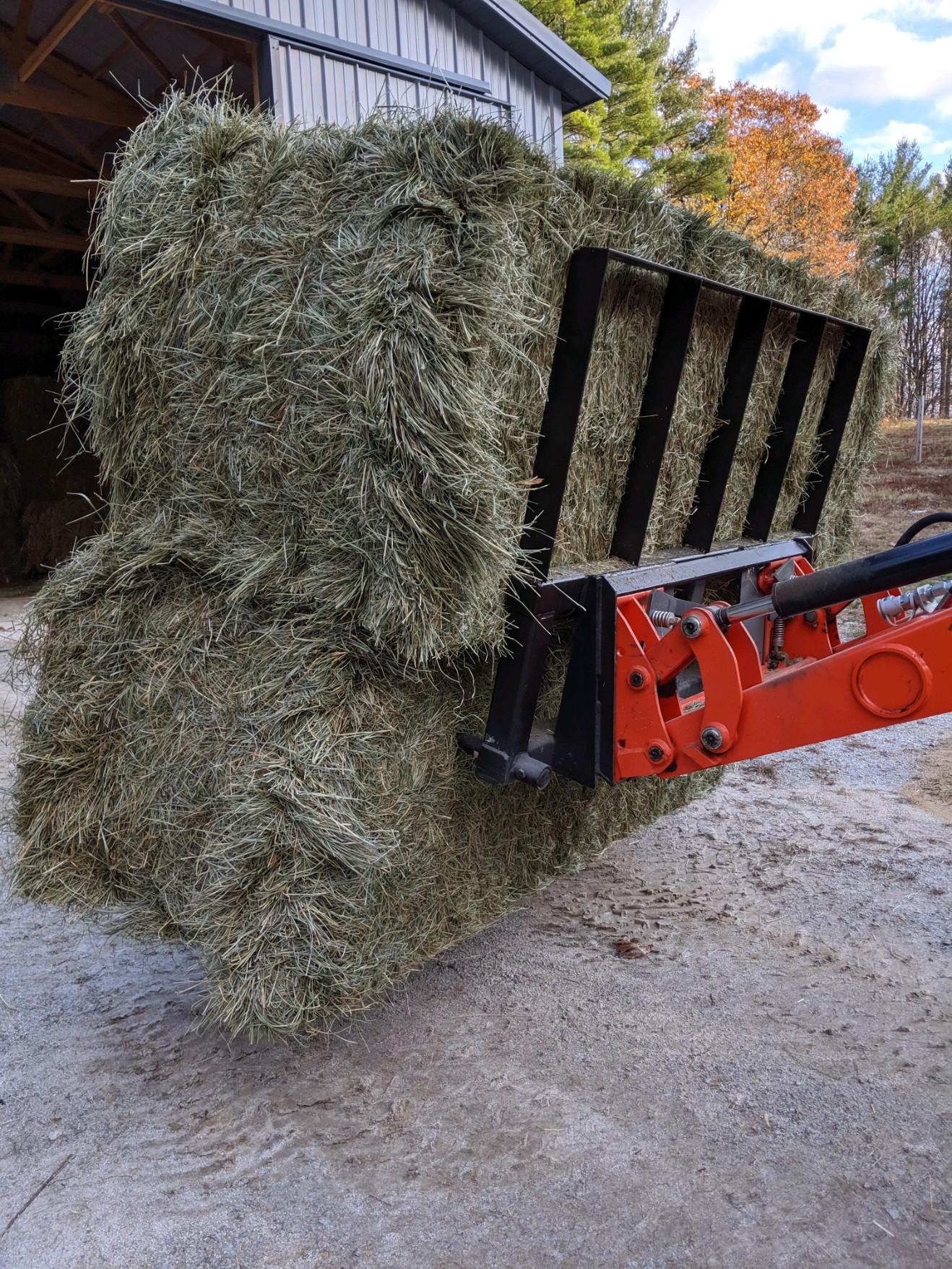

Very nice! My bale spear only has 1 point so I haven't tried two 4x5 rounds with it. In theory it should do it but I've only seen 4x4 rounds handled two at a time on a two spear fork.
Did you buy the L3800 first and find you were maxxing it out often? That's why I recommend going to the next size up, as you can do most of the big tractor jobs with it.

I did buy the L3800 first but we were buying small square bales off the field.. It's just the two of us and getting to hard..So I bought the L47 and we started buying 3x3x8 large bales.. And its a nice toy to play around with..
