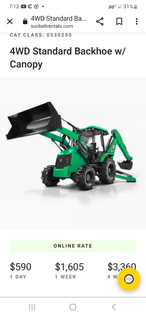

Sunbelt looks like $3300/4 weeks; and pretty much any rental place will beat Sunbelt's prices.
I feel like a tractor mounted back hoe is almost never the right tool for the job, and it fits a good roll for when you randomly Need to dig a big hole, unannounced, like burying a random horse/cow, where you don't want to wait a couple days, and you dang sure don't want to shovel dig.
At the same time, maybe this is just hate from me, cause I don't have the spare cash for one... I have used them on a 25ish HP yanmar CUT. and they do dig, they are far worse at it than a TLB or mini, and they are kinda a pain to reposition, and (maybe operator error) very hard to really get a good grade with, yep its a trench, but not a nice, even, 36" deep, 16" wide trench, ready for your conduit/waterline/whatever;

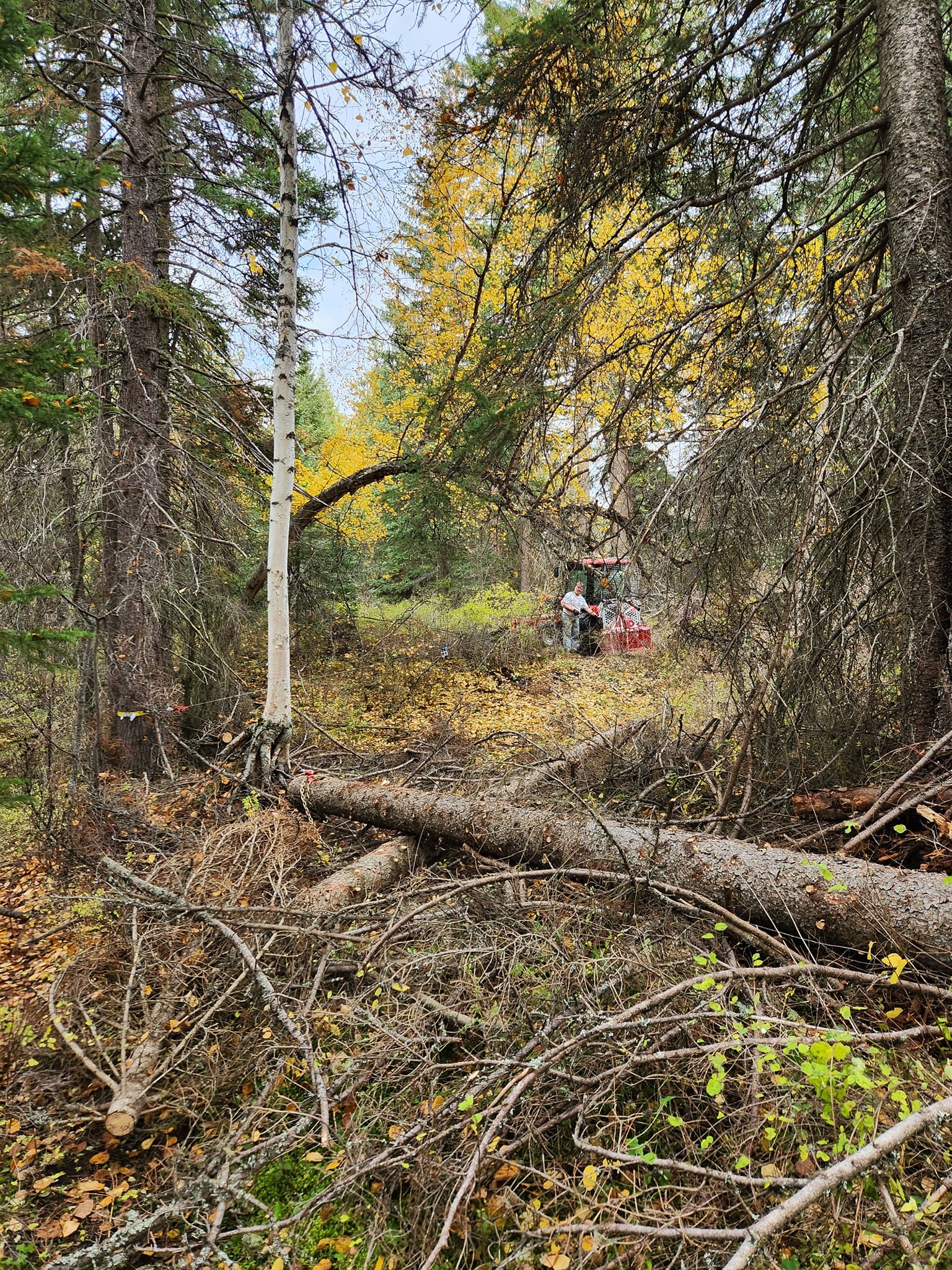

For forested areas my T474 is pretty nice, last weekend I was into the woods with my cab tractor and forestry winch.
But you'll have to determine yourself how big you want to go? I'd say a Legacy model 4820 would be a nice choice.
