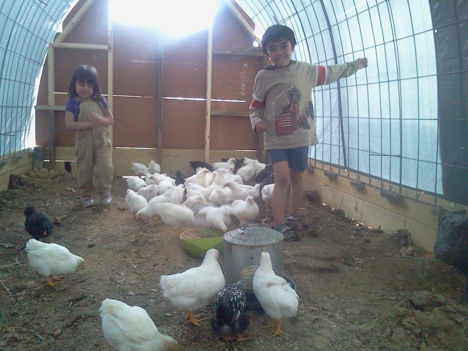

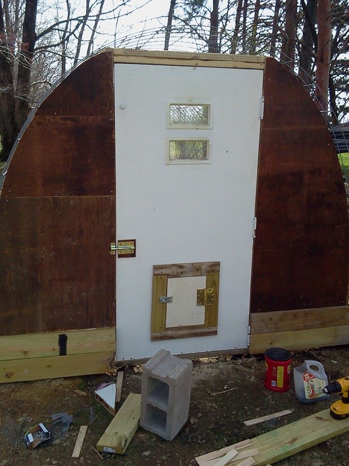

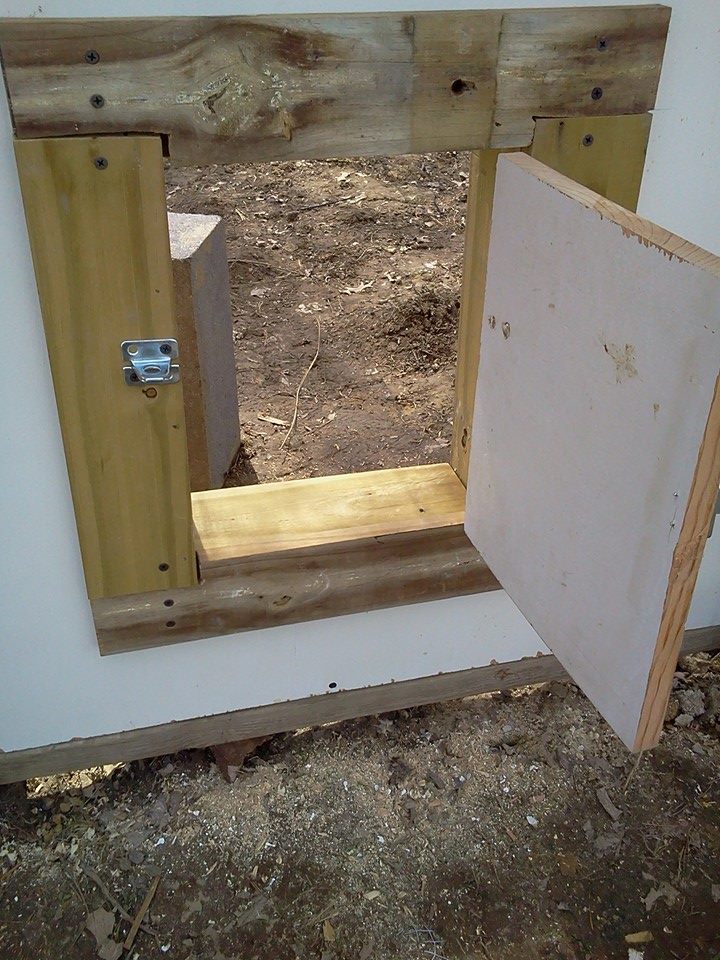

Updated photos...
Had to go out and buy a grommet kit and elastic straps today. My tarps are over-sized and I need to trim them down. Then have to build the rear window shutter and cover the tarps in chicken wire. Need to back-fill in the spaces around the base. Then sand & gravel on the floor, followed by a bunch of pavers I have laying around. Also need to build roosts and nest boxes.
Going to have to pause a couples weeks on a few of these steps as I've still got too much month at the end of the money.

Are you sure you have enough ventilation for the hot months? Do the sides roll up? Are you planning to bluid a pen outside for the birds?
Kirk
I am undecided yet on building a pen or free-ranging them. If I don't build a pen, I have to fence in my garden.
As far as ventilation goes, this thing is in the shade during the hot months and besides it leaks like a sieve all the way around. The birds were cold last night - all huddled in a corner - so I had to put in heat lamps and break a bale of straw for them. I walked outside and there were all kinds of draft sources lit up. I'm going to have a lot of work to do to get it ready for winter.
I have ventilation at the top of the arch on both ends. I have a larger window on the back wall. I could remove the glass from the front door and replace it with open windows. Do not plan on rolling up the sides.
   / First time using PTO. Can I get a quick primer? #40
tip. birds like to roost too.. give them some roosting spots. keep their foot size in mind for comfort. and don't use metal pole. it gets cold and hot.
