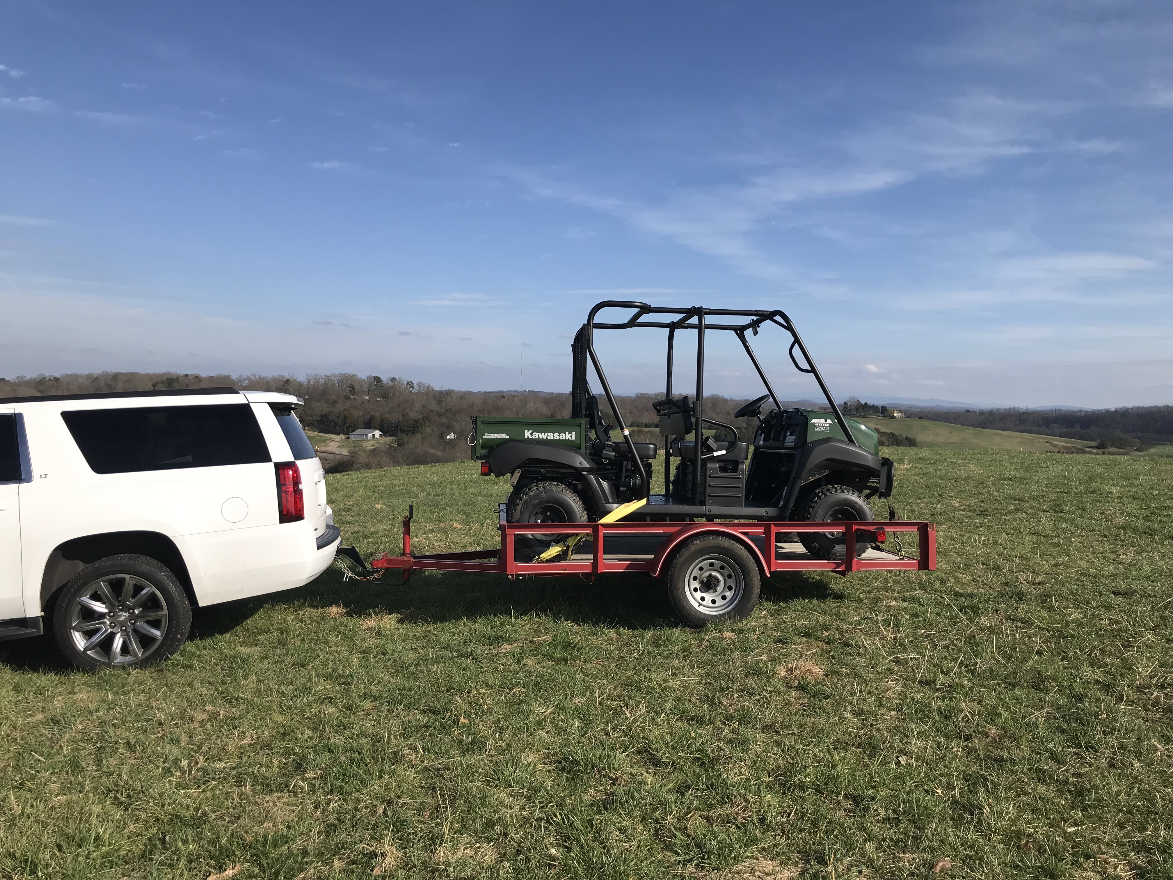

Hey guys,
I went with the Mule 4010 Trans, I think it will be perfect for what we need it for on the farm.
It fit easily on the trailer, except for the fact that I couldn't back it on. It was pouring rain and the dealer said towing it backwards would force the rain down the exhaust vents. It still pulled fine (although it would have been better with more weight on the front) and when its dry pulling it when its loaded backwards should make it really stable.
My trailer is 6.5 x10 so it had plenty of width and had almost two feet for the lenght. I only went 45mph on the way home and it felt solid, but would have been more comfortable with more weight on the tongue.
Thanks for all the help, I need all this rain to move out so I can play with this thing.

A world of difference towing when its backed on, the extra tongue weight changes everything. Very stable, couldn't even tell it was back there.
So a 6 1/2 x 10 foot trailer has no issues pulling a 4010 Trans Kawasaki Mule.

From your picture, it looks like you could use more drop on your hitch, and you could pull the Mule all the way to the front of your trailer.
