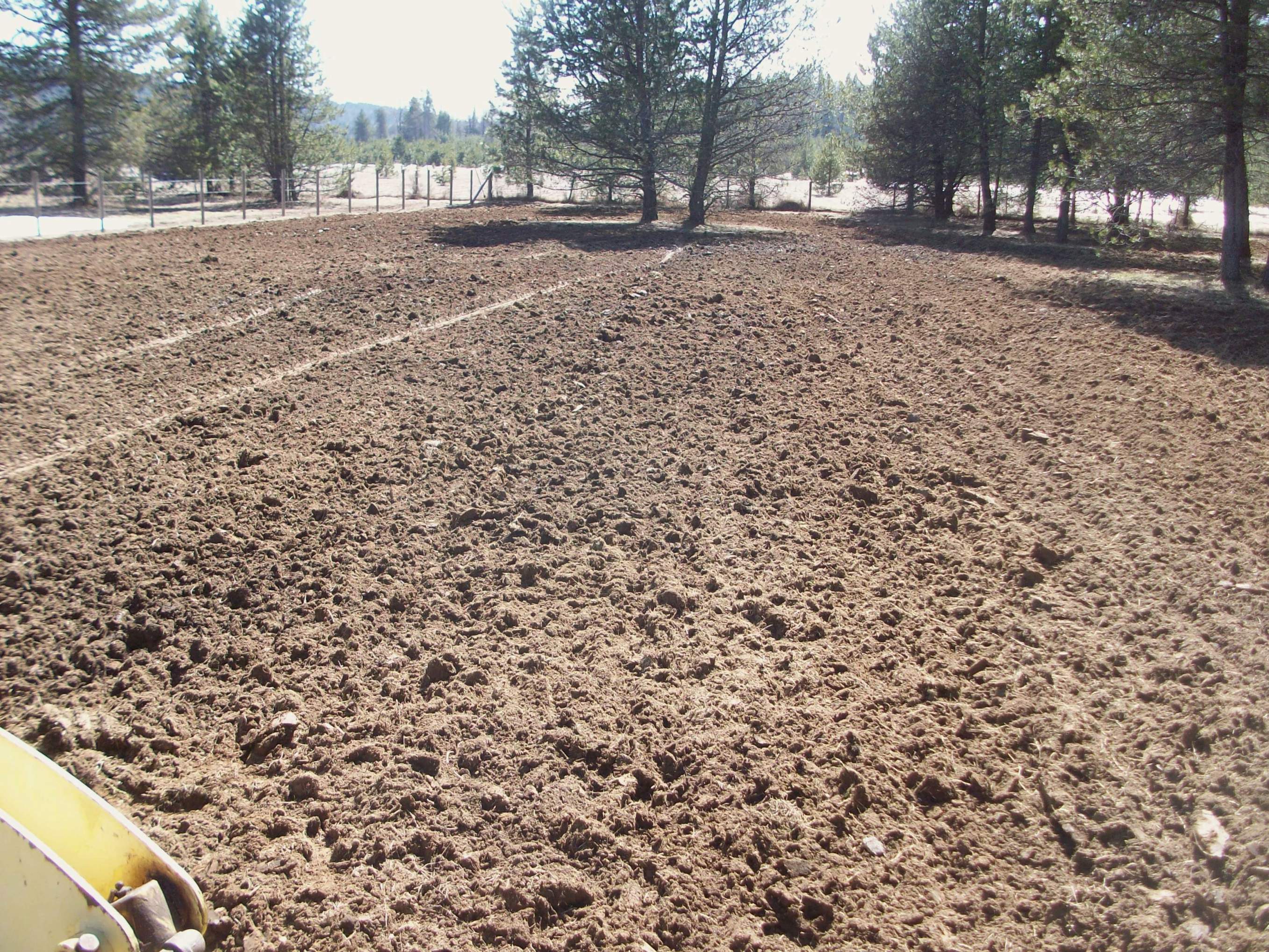

Dug this up today, spike harrow 003.jpg pretty small but it might work to break the clods down, maybe look into the drag idea, built one out of a pallet and 2x6s for the area where my garage was to be constructed , will try to check it out tomorrow, the alfalfa sounds good ,that stuff is sure getting expensive to buy- at least here, but that is a plant it every year seed I believe

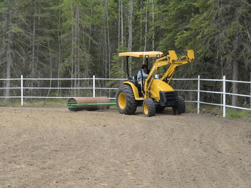

Field is lookin' really nice! :thumbsup: Couple of observations.. especially with regards to pastures and horses. Alfalfa and clover are problematic for horses. Your extension folk's can also help to verse you on this subject. Some species of clover are very bad for horses and alfalfa is too high in protein to be included in the horses diet at a high %.
Secondly, one of my first pastures (actually 2) I had a nice fallow seedbed; planted everything the first week in November - 6" of new snow a week later. Got great germination the next Spring and a beautiful stand! Waited until early fall before I ever let the horses put a foot on those fields.
Dang... they punched holes everywhere in those fields! :eek: I had already mowed the grass once, maybe twice, earlier in the summer and hauled the clippings off. The grass was probably 4" maybe 5" tall. Figured that the roots were solid enough... Nope, not even close - about every 10th mouthful - they'd pull the whole clump of grass up! Crap!!
Long story - short. I ended up dragging the fields with a short-tined drag, reseeded (overseeded) and roller-packed - ROLLER PACKED - those fields with a 8' - 3,800lb water filled roller.
You gotta pack that field. Seriously. They'll make it look like World War I out there...

Already caught **** from the wife, after she looked at my post about the alfalfa, was considering closing that field off and trying to harvest the alfalfa, but she just told me that ain't going to happen either:laughing: I told her no matter what gets seeded there 's not going to be any horses on it either at least till it has had a chance to grow up good, she also said some of the other fields already have enough clover and something about the horses mouths going numb,(think thats what's happening to my head):muttering::laughing:
any way I'm going to send off the soil sample in the morning and after walking on the field Definitely agree somehow going to have to pack the field eventually... My sister still has several implements , and a JD 550 crawler,bet that would pack it down, if I ran it up and down the field? not sure if my trailer or hers will haul it though,seriously doubt it -maybe I can rent a roller when the time comes... You've got me thinking....:)
