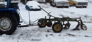

I'm sure that's true with a 3 point plow, but not so sure that is entirely correct for this style pull type John Deere (how about it? deere pull type plow owners) here's a jd plow new 018.JPGpicture the amount of work to stop, back up, re-align the plow would make this a real hassle.
The property is only 10 acres and the fields have been fenced into some really small fields,also it is partially treed further complicating plowing...here's how it looked after my first attempt with the JD 3bottom, the frost wasn't completely out of the groundplowing the field 006.JPG then switched to the Ford 3000 and discplowing the field 012.jpg anyway going to start on it again tomorrow, liked your plowing pictures you the plow and the NAA did a nice job:thumbsup:

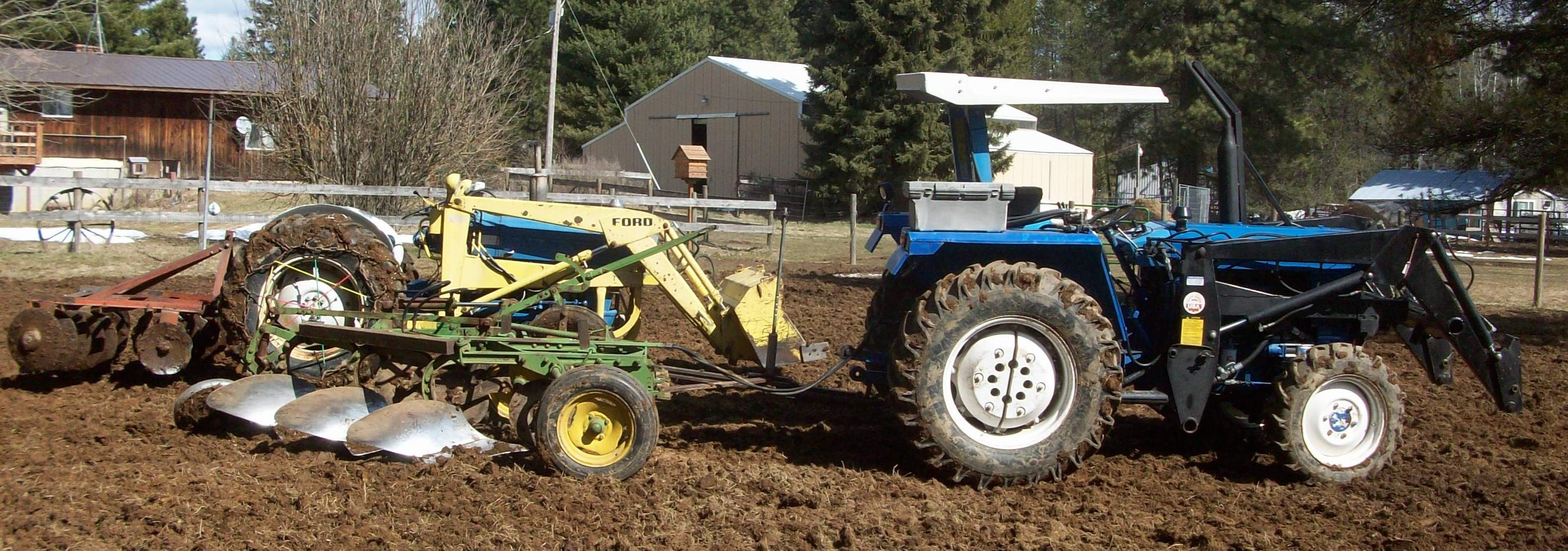

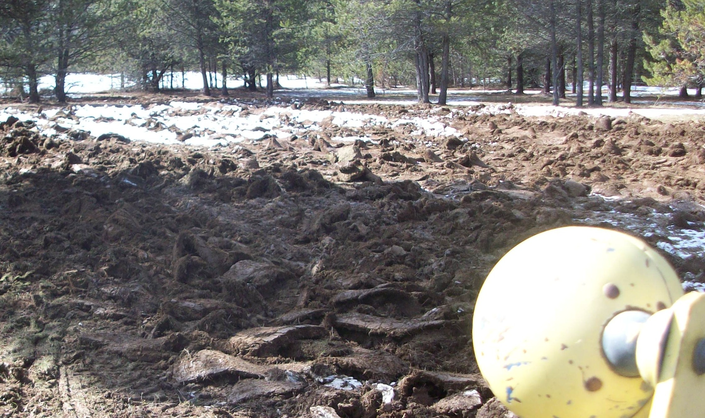

started to load a picture and a google malware warning about tbn covered the screen, went into the advanced area and was able to get back here ?? who knows?? anyway first- here are my helpers who will do most of the work. 1967 Ford 3000 ,W/6' interco? disc and a 1993 Rhino 554 w/ JD 3 bottom pull plow and hydraulic lift, plowing the field 008.jpg
also here's how i finished today ,going to be 22 degrees or so tonight may have to fight the frost again in the morning...plowing the field 015.jpg Right now everything's on a shoe string budget, Got a fair amount of Horse manure from the barn and run outs (been composting 2 years) and need to move it anyway probably going to bucket that out and plow it again... Thinking about getting a 5 gallon bucket from various parts of the field before and another after the manure is added, Possibly check with county extension office (next week)and find out what the charge is to test the soil...
/ First timer- field prep for field grass #9
started to load a picture and a google malware warning about tbn covered the screen, went into the advanced area and was able to get back here ?? who knows?? anyway first- here are my helpers who will do most of the work. 1967 Ford 3000 ,W/6' interco? disc and a 1993 Rhino 554 w/ JD 3 bottom pull plow and hydraulic lift, View attachment 309604
also here's how i finished today ,going to be 22 degrees or so tonight may have to fight the frost again in the morning...View attachment 309605 Right now everything's on a shoe string budget, Got a fair amount of Horse manure from the barn and run outs (been composting 2 years) and need to move it anyway probably going to bucket that out and plow it again... Thinking about getting a 5 gallon bucket from various parts of the field before and another after the manure is added, Possibly check with county extension office (next week)and find out what the charge is to test the soil...
I would not plow it again this year. You want the sods you got upside down to rot in place to kill all the weeds you turned under. Spread your manure and let it and the soil dry out in the spring sunshine and wind for a few days until clods fall apart to dust when kicked then disk again to chop in the manure and give yourself a fine even seed bed. It looks good so far especially considering how wet it still is.

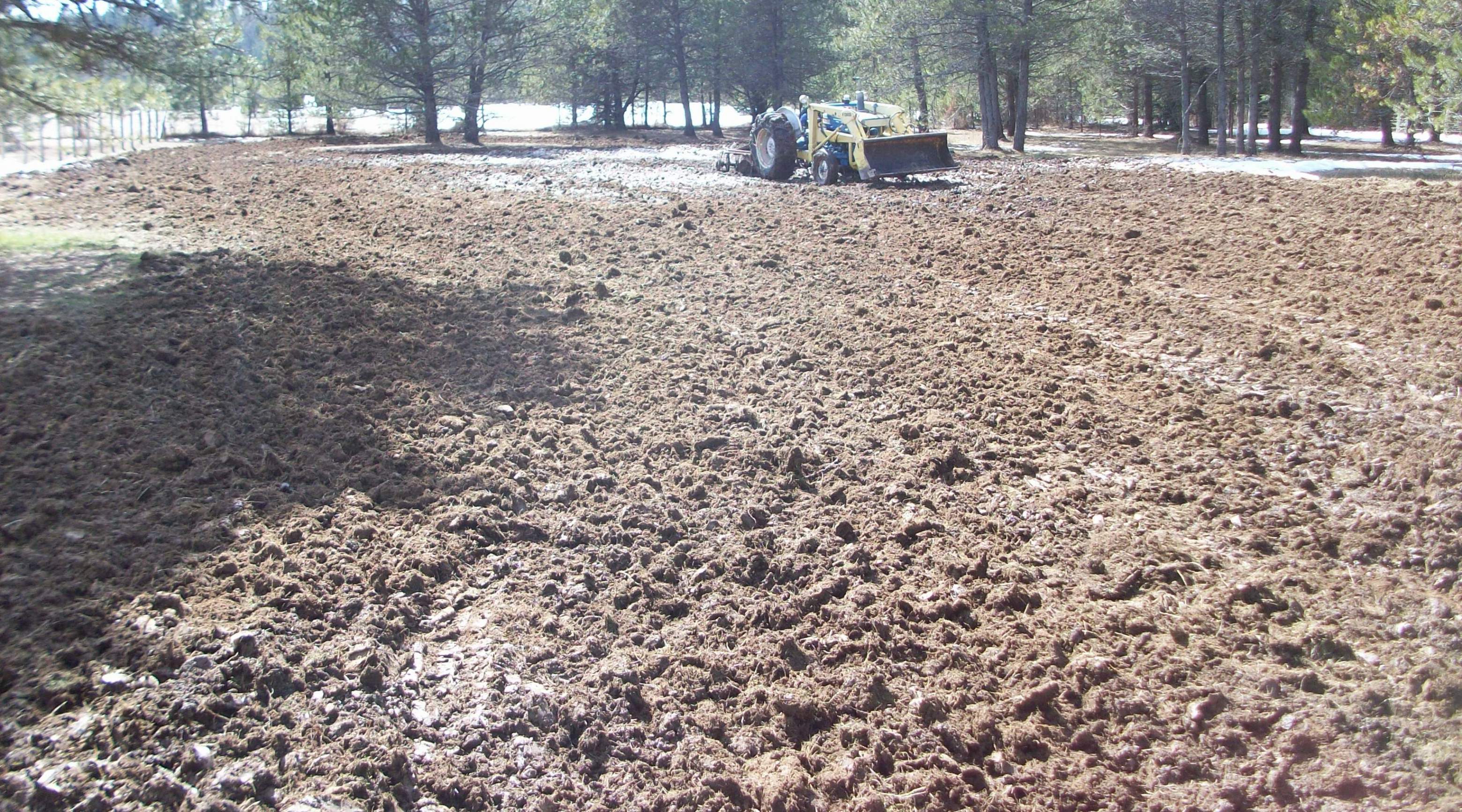

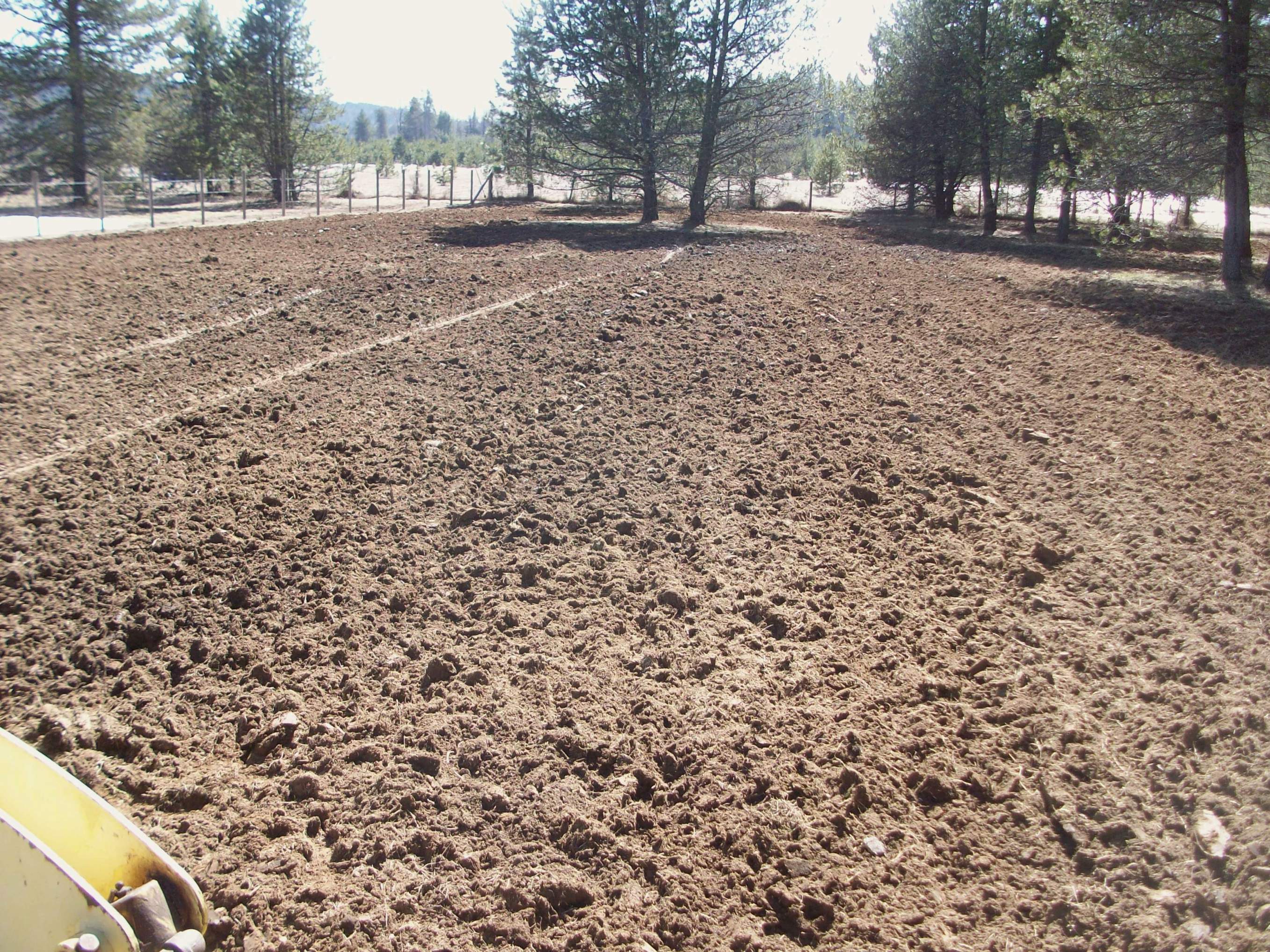

Well the last couple days have been sunny, no moisture , so I worked in the part of the field that is treed and just pulled the plow thru the areas that the trees were not closely spaced. Tried not to rip out the root systems of the Pine trees, Once that was opened up , got the disc and worked it over the plowed up parts, and anywhere I could get,
Glad the old Ford does not have a canopy, or it would have been destroyed by the end of the day, as it was- a branch got a hold of my coffee cup and between the disc and loaded 14.8 -28s another cup wiped out.:ashamed:lost count on how many coffee cups have been run over in the last few years...
Today put some extra weight on the disc, and ran it over the manured field - the field was not very wet except in a couple of shaded places, the dirt did not stick to the point of gumming up the disc wheels.
I found the sweet spot on the 3 point top link adjustment,to where both front and rear gang shafts were evenly running above the field, and a good spot for the depth adjustment the front discs are 16" and notched the rear wheels are 18" and smooth. When I took this picture, tractor in 5th gear and a smile ear to ear:cloud9:View attachment 310158 here's where I stopped for the day ,discing 010.jpg still going to look into the soil analysis, if price is not to much
