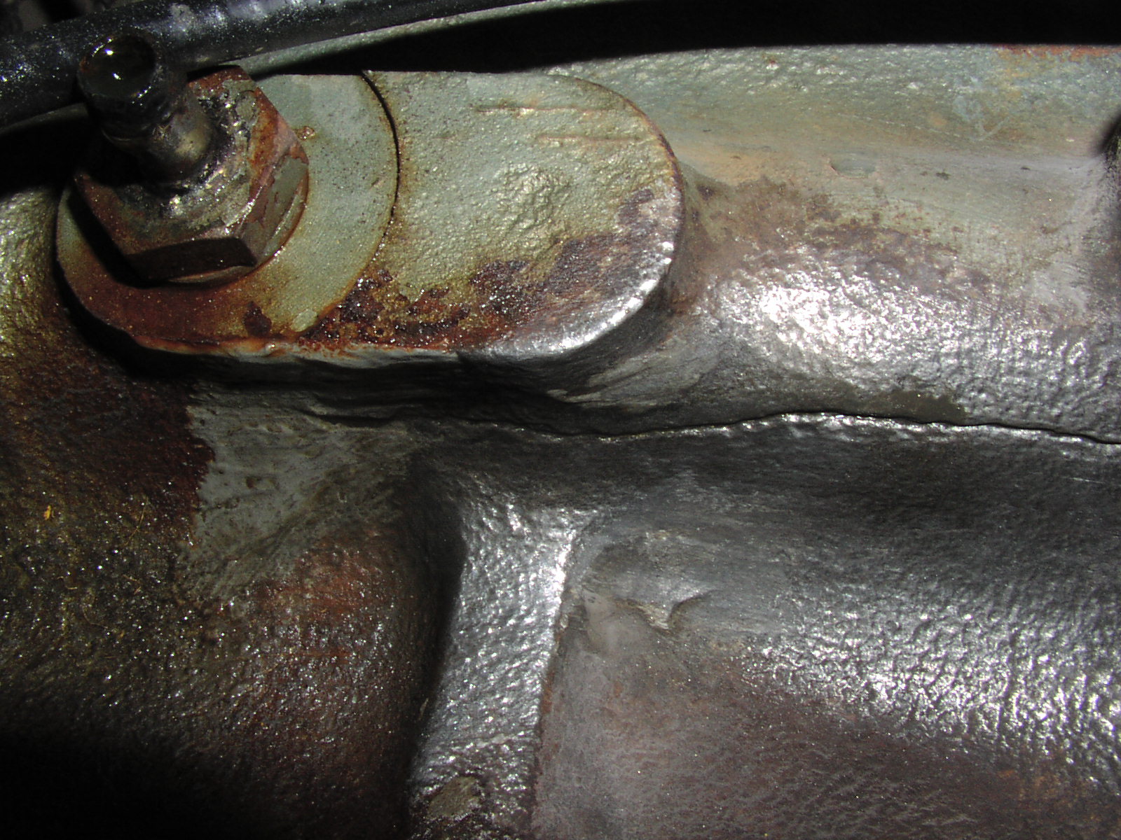

Well i bought my first tractor and i think i got burned. I posted a wanted add on some semi-local forums that are fishing and offroad related. A guy responded saying he has a ym2000 tractor with a boxblade,rotary cutter, and a finish mower-that needed work. He sent me some pics of everything and all looked good. He said the tractor ran great and he used it to cut his yard up until about a year ago when the finish mower gave out. I drove over to look at it.(2 hours) It looked good for its age. It was kept in a shed, and he told me that when he moved to that house about 10 years ago the previous owner worked the tractor into the deal for him. He said the previous owner had it roughly another 5 years before that. He brought it out and i looked it over. Eveything worked good, lift,clutch brakes, the engine started right up. He did say it was low on radiator fluid, i figured the old radiator probably has a leak, no big deal. Well i talked him down a little and gave him $2800 cash for the tractor, 4' rotary cutter(good shape), 4' boxblade(good shape), and king kutter finish mower that is in repairable shape(needs spindle and some idler pulleys and a good blasting and painting). We loaded it all on my trailer and off i went.
I got home filled up the radiator and drove the tractor off my trailer. I took it around to my back yard to drop off the finish mower, then i drove back to the front yard to move the next attachment. I hooked up to the rotary cutter and drove it to the back yard and dropped it off. I drove back around to the front yard, hooked up to the boxblade and drove the 300 feet to the back yard again and turned the engine off. I heard water boiling in the radiator. Im now upset.
The next day i take the upper radiator hose off from the radiator.Thinking i need to flush rust and crud out of the system, I undo the cap and backflow the fluid with a garden hose for roughly 10 minutes before the radiator fluid turns somewhat clear. It was a rusty black color! basically black!
I let the tractor run without the upper radiator hose unconnected to the radiator,while topping off radiator with garden hose to keep up to water pump, but water would barely pump flow out.a small stream. If i raised the hose slightly above the normal height of the hose it would not pump out. IS THIS NORMAL?
So by now im thinking that i need a water pump, and that just my fluid looks rusty black. well i reatach the hose and run the tractor for 15 minutes or so leveling a small dirt pile. Water is barley steaming from the overflow tank, but i did have to much water in it to beginn with. BUT, after it cools a bit i open it up and it is already black! Now im thinking im getting oil or smutt in my coolant.
Maybe i need a headgasket and a water pump im thinking?

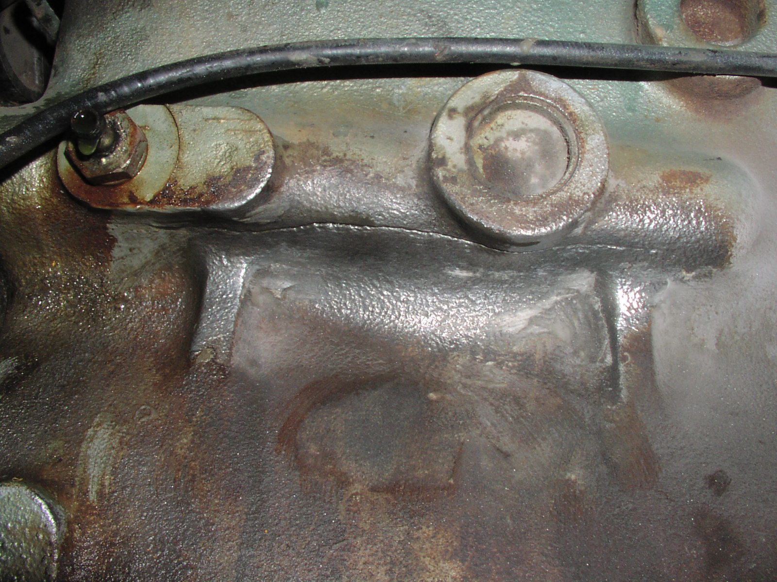

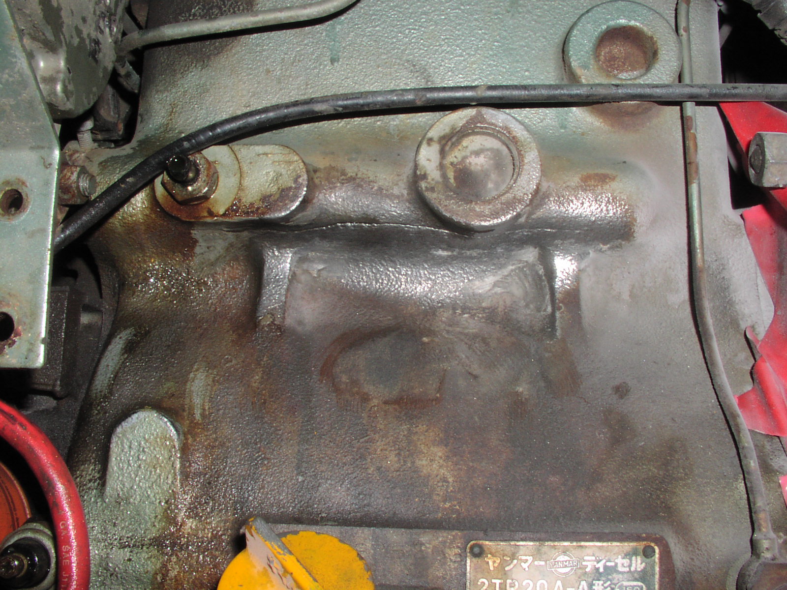

Well im looking at the motor to see any parts i need while i order stuff and what do you know! I think i see a crack in the block near the starter! it looks like it has been partially jb welded or what not. Its not leaking but im concerned about my block being cracked. How do i know its not cracked on the inside?
Im out of $2800...i Barely even make that in 2 months right now.Im mechanically inclined, self taught. Im wondering if i just slapp more jb weld on it, and replace the head gasket and water pump and hope it doesnt overheat. The engine runs great, but has cracked block/overheating issue. What do i do?

My opinion there are 2 cracks. One outside and one inside. Because you are getting oil and antifreeze. Or the crack could be long and into water and oil. But I don't know how the oil and water jackets are in this block.
   / First tractor, did i get burned? ym2000 cracked block.... #36
Djames55 I agree there has to an opening into both the oil and coolant chambers.
   / First tractor, did i get burned? ym2000 cracked block.... #37
Good chance there is an internal crack but not knowing the history it could be a blown head gasket allowing water in oil. Whole thing is a mystery.

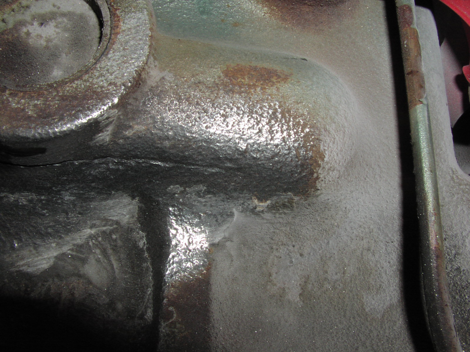

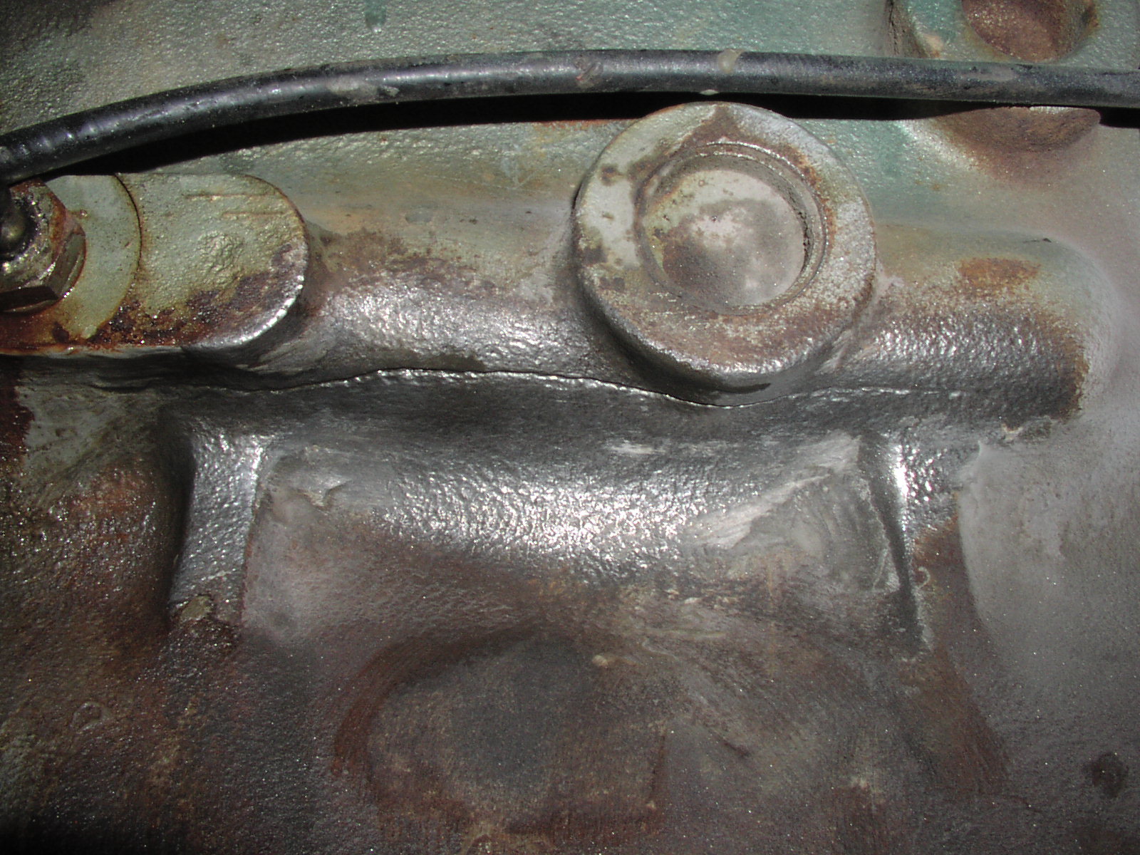

Sorry i have not had time to get on here guys. I just removed my starter and other things that were in the way to get to the crack. I took a grinder with a wire wheel to the crack and it runs almost the entire length of the water passage way in the block. I have decided that i am going to weld it with Crown Alloys royal 44-30 mig wire which i have heard of great results mostly on marine blocks around here locally and online. The jb weld that was previously on the crack looks as if it helf 75% of the crack from leaking. Im sure if done again/correctly with better prep that it would hold and last. If the crack was shorter that is what i would use. I am going to bevel out the crack just very slightly with a dremel, drill the ends of the crack, then slightly heat the area with map torch to burn off any coolant or oils to assure i get a good clean weld. I will be welding very short tacks maybe 1/4" or less at a time to keep the heat down.
I also drained my coolant once again. It does seem dirty but i see NO signs of oil in my coolant so i am good there. I am going to drain my oil and check it out as well but from the dipstick it appears to be in good shape, it doesnt look milky or "waterey" for lack of a better term.
I have not contacted the buyer about getting my money back. I bought this tractor to get what i need done by springtime and will repair it and use it until i get this property cleared and somewhat leveled. Im pretty sure with a proper repair this engine should last for years to come.

Just a thought. From the earlier photos, the black stuff running down from the crack looks a lot like what Bar's Leak looks like. If the previous owner had been dumping Bar's Leak in the coolant, you may have a bunch of it in the lower passages.
