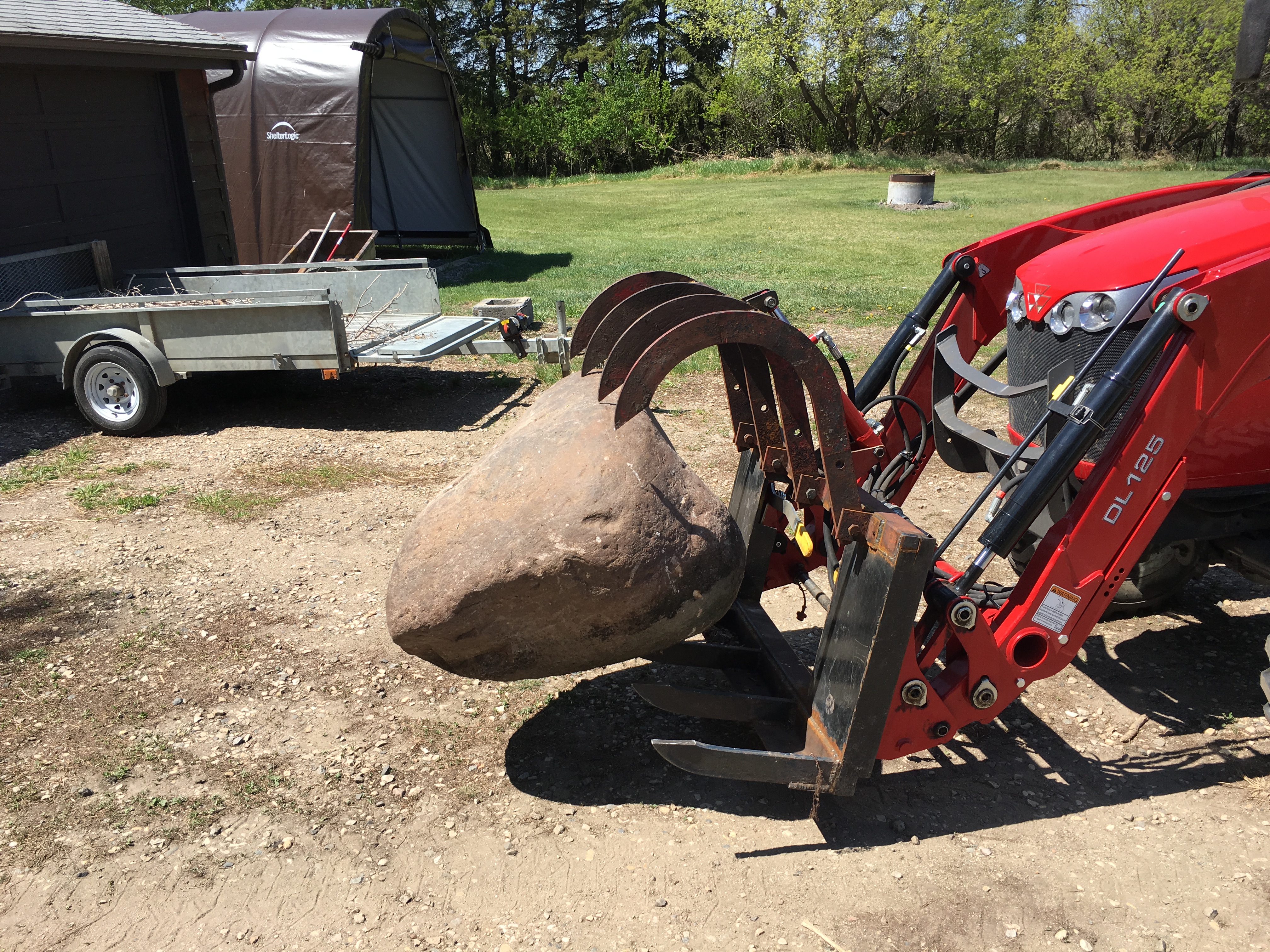

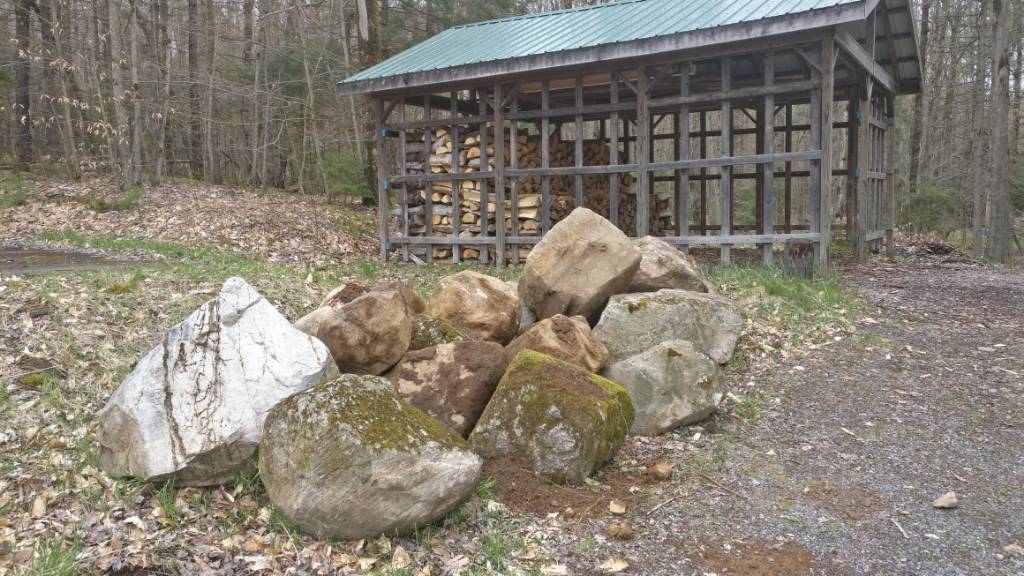

I don't, because I listened to the advice on here, and bought WAY larger than I initially thought I needed/wanted. I'm on 5 acres, and went with an LS XR4145HC. For what I do with it (moving lots of rocks/wood, snowblowing, and some road maintenance, it was the right move. Anything smaller (with less loader capacity) and I wouldn't be able to move the things I need, and snowblowing would take significantly longer.
The pictures show the piles of rocks I accumulated a few weeks ago. IMG_20200516_112851.jpgIMG_20200404_154817.jpg
