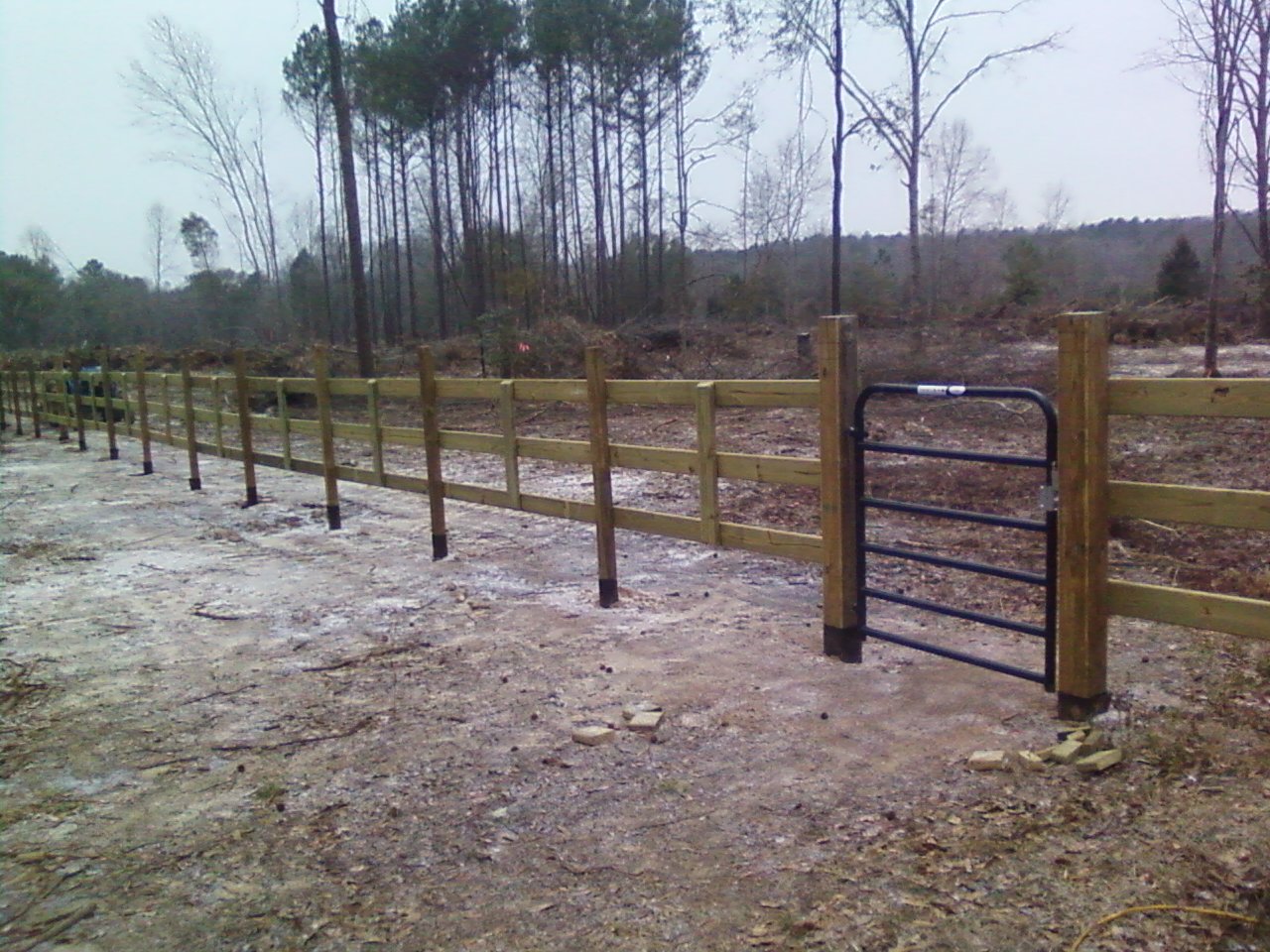

This is part of my 3 rail fence.
I like it. At one time I had about 18 horses. Down to 10. I found that they like it a lot better if they don't stay in the barn. Check the cost, but here my rolls of hay contain about 18 square bales. I do lose some in feeding. All is stored under cover. We still have to stack, unstack, and feed.
