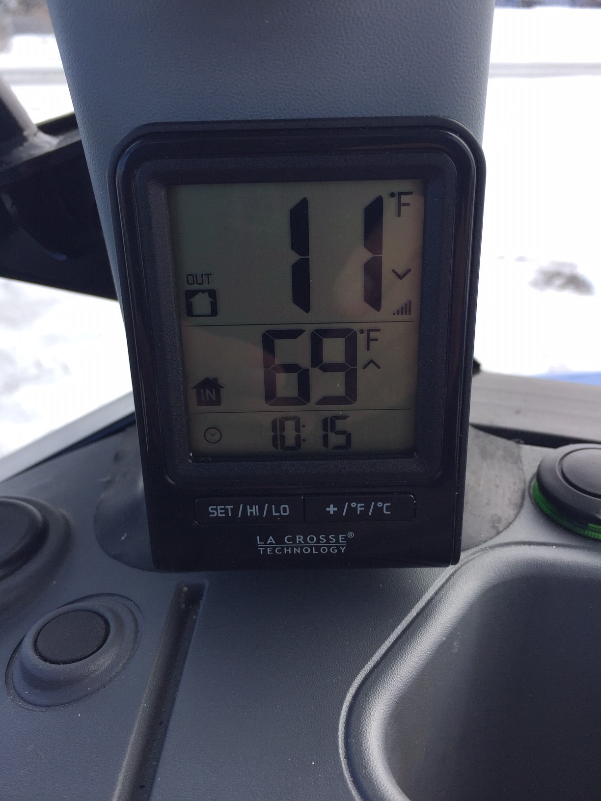

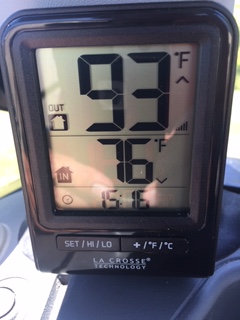

I realize that NC is a temperate climate compared to the Midwest. Here is why I really appreciate a tractor with a cab, heat and air.
