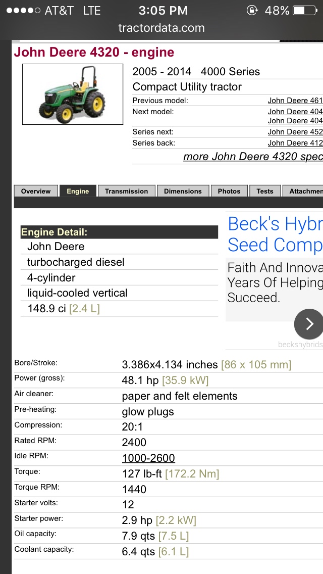

This may be a dumb question but it's one I don't know the answer to so I will ask it. I have a 4320 and it's turboed, but it just sounds like a regular tractor, I always figured a turbo would whine a little. Is that due to the size of the turbo and the speed it's spinning?
Trucks whine, pulling tractors whine but my little tractor does not.
The JD I am getting has a HUGE muffler compared to the size of the turbo,,
maybe the muffler is absorbing the sound?
Also, my exhaust is directed down, and towards the front,,
much less noise gets to the operator,,,
Drive past someone,,, ask them what they hear,,,
,,, and,,, if you had the 1972 year model 4320,,, I would bet you would hear the turbo,,, :thumbsup:

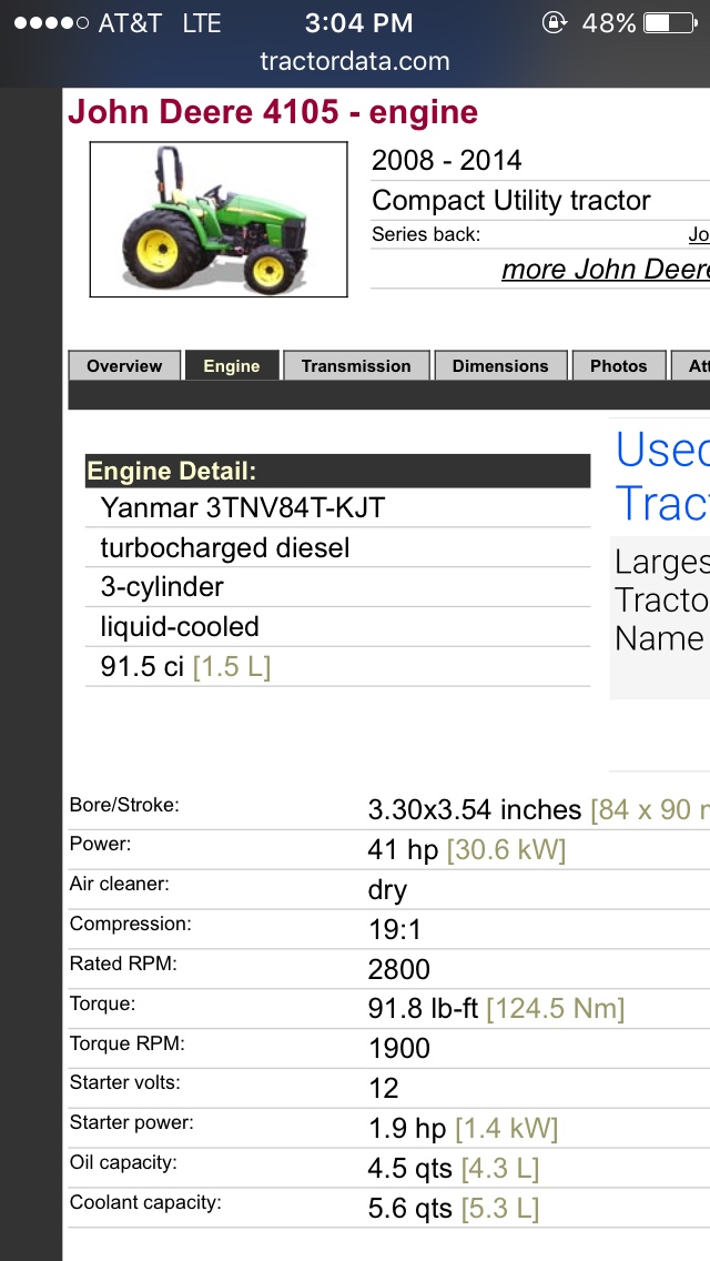

Your tractor and mine are very similar, only difference is age and HP
Edit: ok maybe there a little more different than I thought

I think it might be because a turbo on a tractor only boosts the pressure of the intake air a small amount compared to a truck. Remember, these engines are designed to operate at full rated power continuously. If they boosted as much as a pickup they'd overheat.
