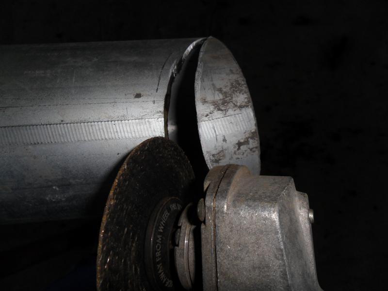

I have used about every method mentioned above and found the quickest/easiest for me is notch with the angle grinder.

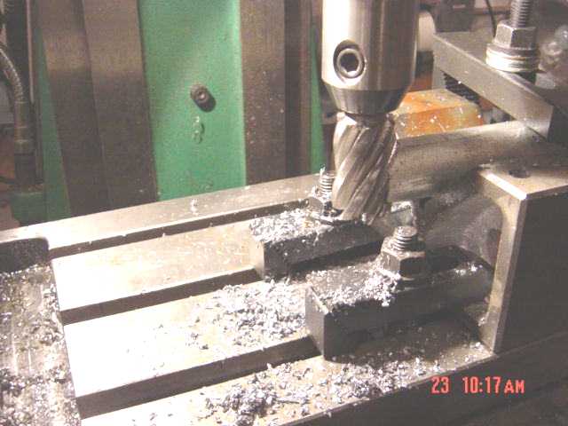

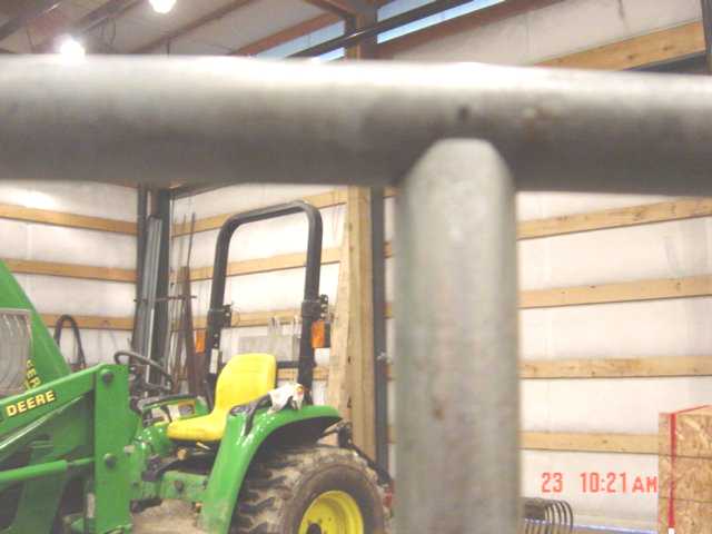

I've used my mill and a roto broach before on small pipe.

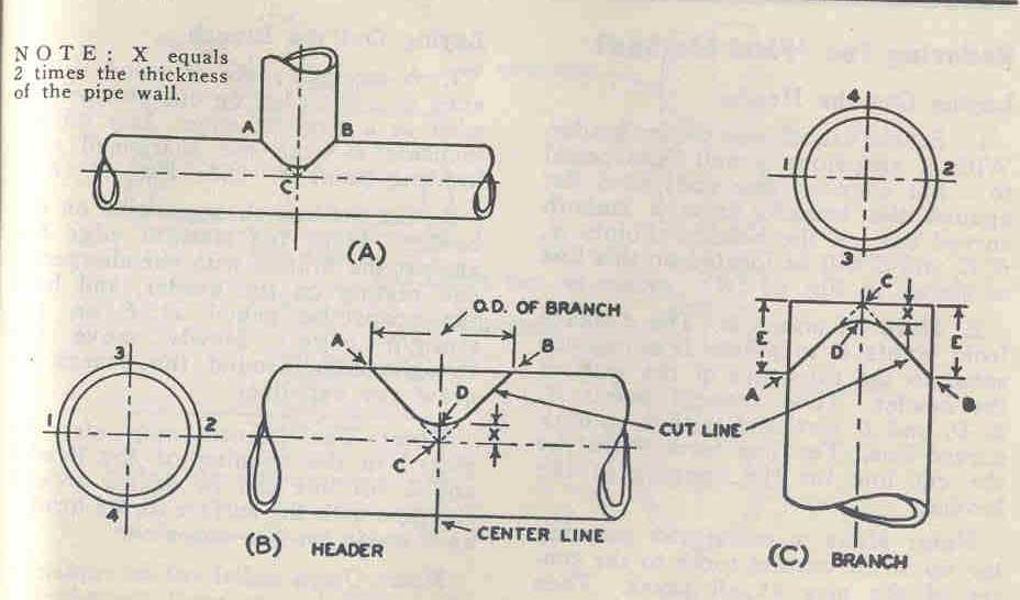

If you're going to do it with hand tools, this is a nice template maker. Plug your numbers in, print it out, cut the line, wrap around your pipe, mark, and cut / grind.
Tube Coping Calculator
Wow Shield Arc, that's a nice calculator; thanks! I've always done it by the trial and fit method with a torch then finished up with a grinder. That will help a lot.

If you do it on a semi regular basis I would get the cheap pipe notcher. Doing 90 degree notches with a grinder is fine but once you start getting into angles, say building a roll cage, that's where the notcher really shines. They have a scale and are adjustable (think mine goes from 90 down to 30 degrees). Losen a couple of bolts, set to the correct angle, tighten, no real thinking involved. I've gotten hundreds of cuts out of a single hole saw, just low RPM and a little cutting fluid or WD40, cuts real fast.

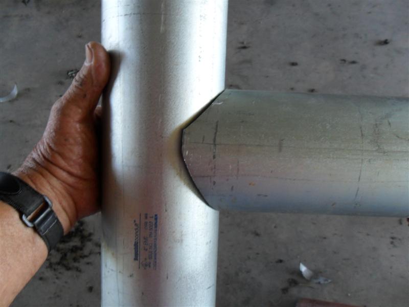

I cut pipe all the time and fish mouth it to weld together. When building H frames for fences. The fastest and easiest way I have found is to mark all the pieces and line them up, cut them with a torch, (I now have a plasma cutter that is even faster) but the torch works great, touch the ends up with the grinder to remove any slag.
If you are building something that needs to have a super tight fit up, then use a hole saw and the pipe notching tool, otherwise it is slow and you have to buy expensive bimetal hole saws.

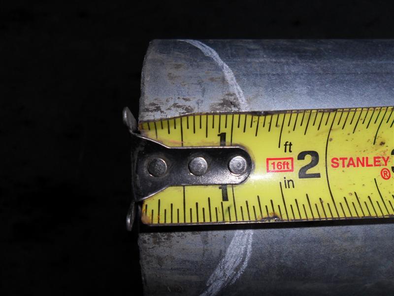

I have made paper fish mouth patterns for years. I use a cereal box cardboard and they hold up pretty good. Then I started using the "Sure kut" metal patterns. These work nicely too.

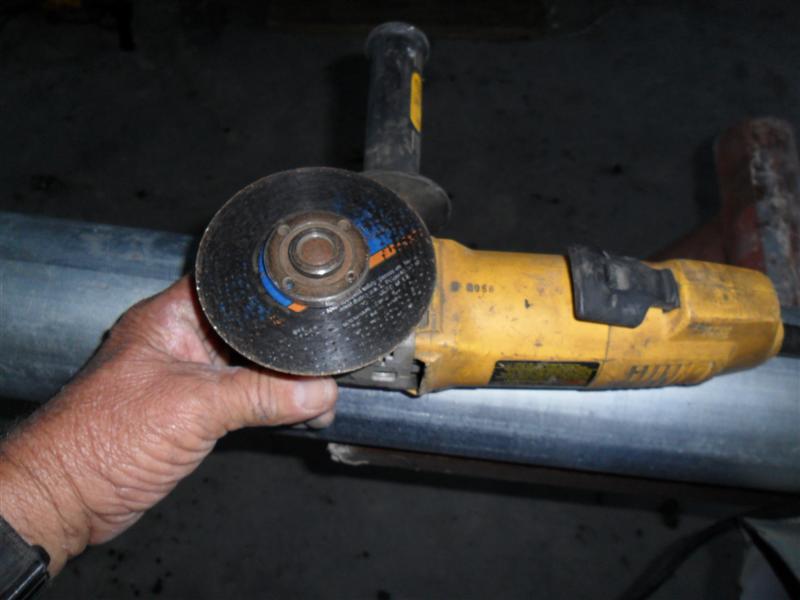

You mentioned you don't have a torch, so you can try using 4-4.5" grinder with a cut off wheel if you don't have to many to do. With the pipe being 3/16" or thicker it may be tough to follow the cut pattern all the way around 2" pipe.
