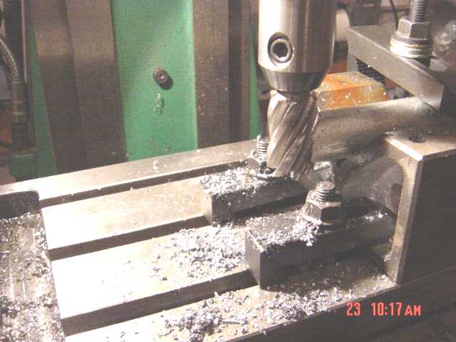

I've used my mill and a roto broach before on small pipe.
