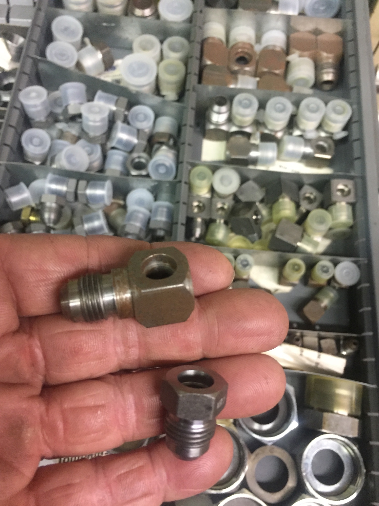

I am looking for a supplier of socket weld jic 6 fittings. I need 90 degree ells, branch run tees, and straights. I am also looking for a supplier for the appropriate mild steel tube. My FEL has all rubber hose that I would like to replace.
Thanks for any info!
Brian
   / Fitting supplier #3
In my industrial piping days such items came from industrial piping suppliers. Never saw a socket weld JIC. They must larger than any hydraulic system I worked on. Usually any thing larger than 3/4" was flanged or pipe thread. Find a supplier of Swadgelock compression fittings made for hydraulic service. Installed 100s of those. That way you do need to have an expensive flaring tool. Largest hydraulic system in my past was 3" triple heavy welded steel pipe. 10,000 PSI if I remember rightly. Believe me cleanliness was a problem. WE installed filters at every branch line and before every device.

Those fittings should be available in forged steel. Mild steel would probably meet the PSI rating you need. Mixing SS fittings with steel hydraulic tubing may be little dicey as they are designed for TIG welding. There are other brands of compression type fittings that may be cheaper. JIC requires a 37 degree flaring tool which if I remember correctly are about $300.

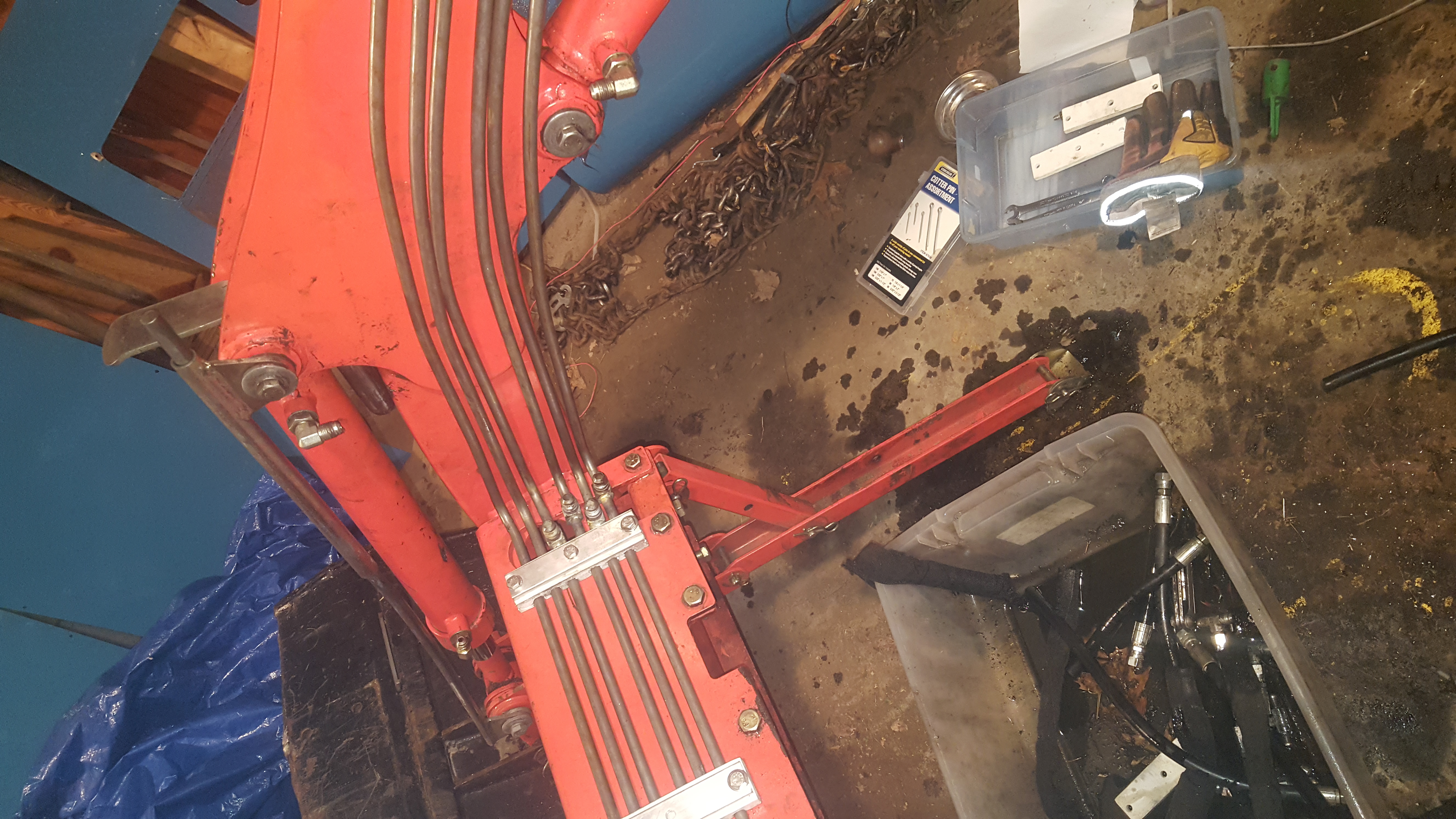

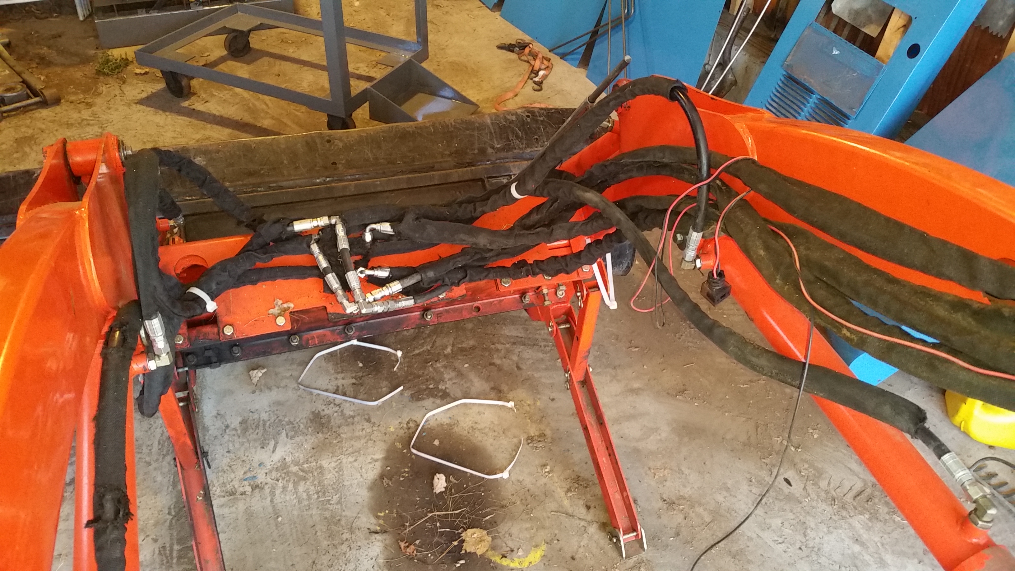

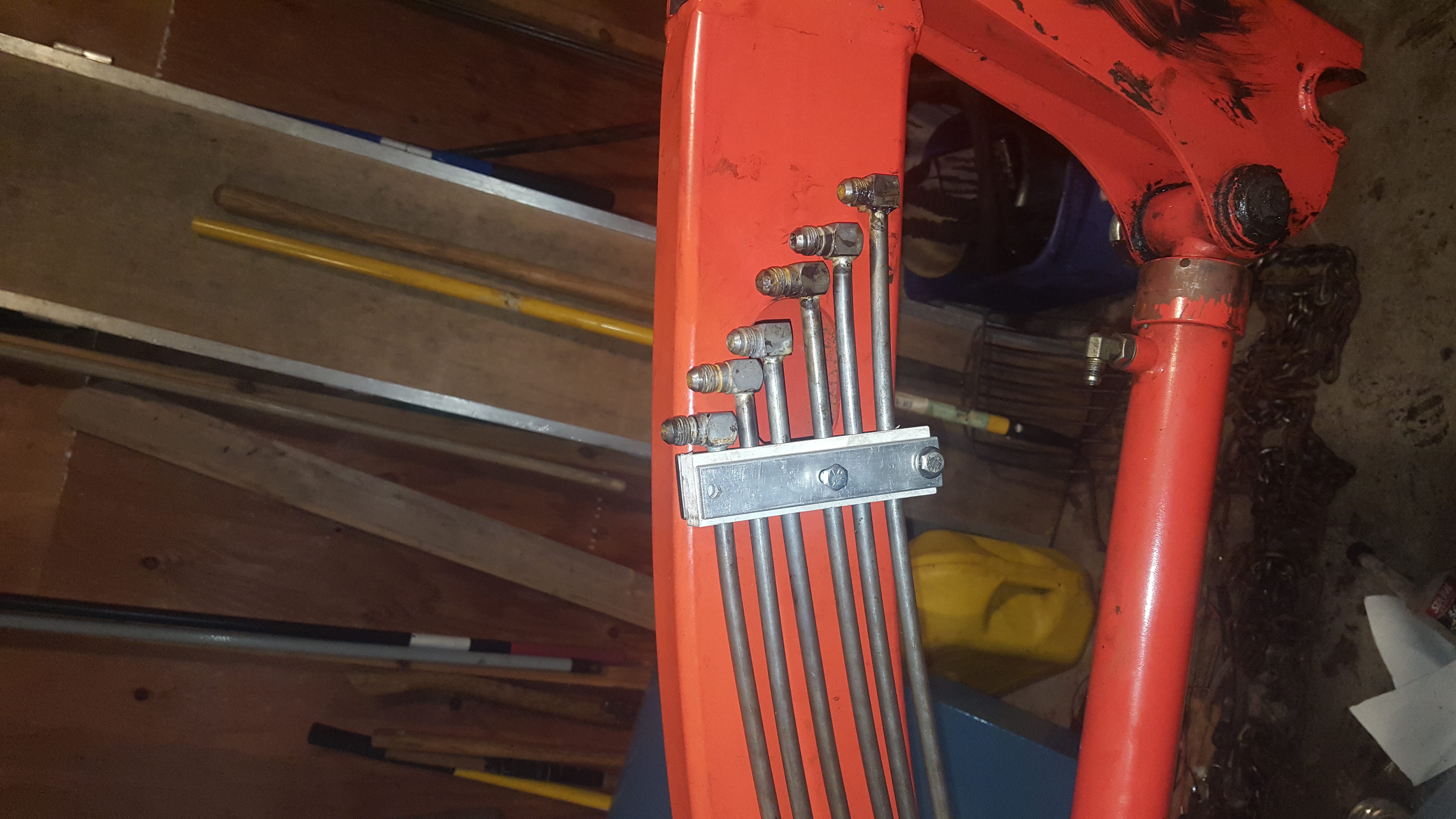

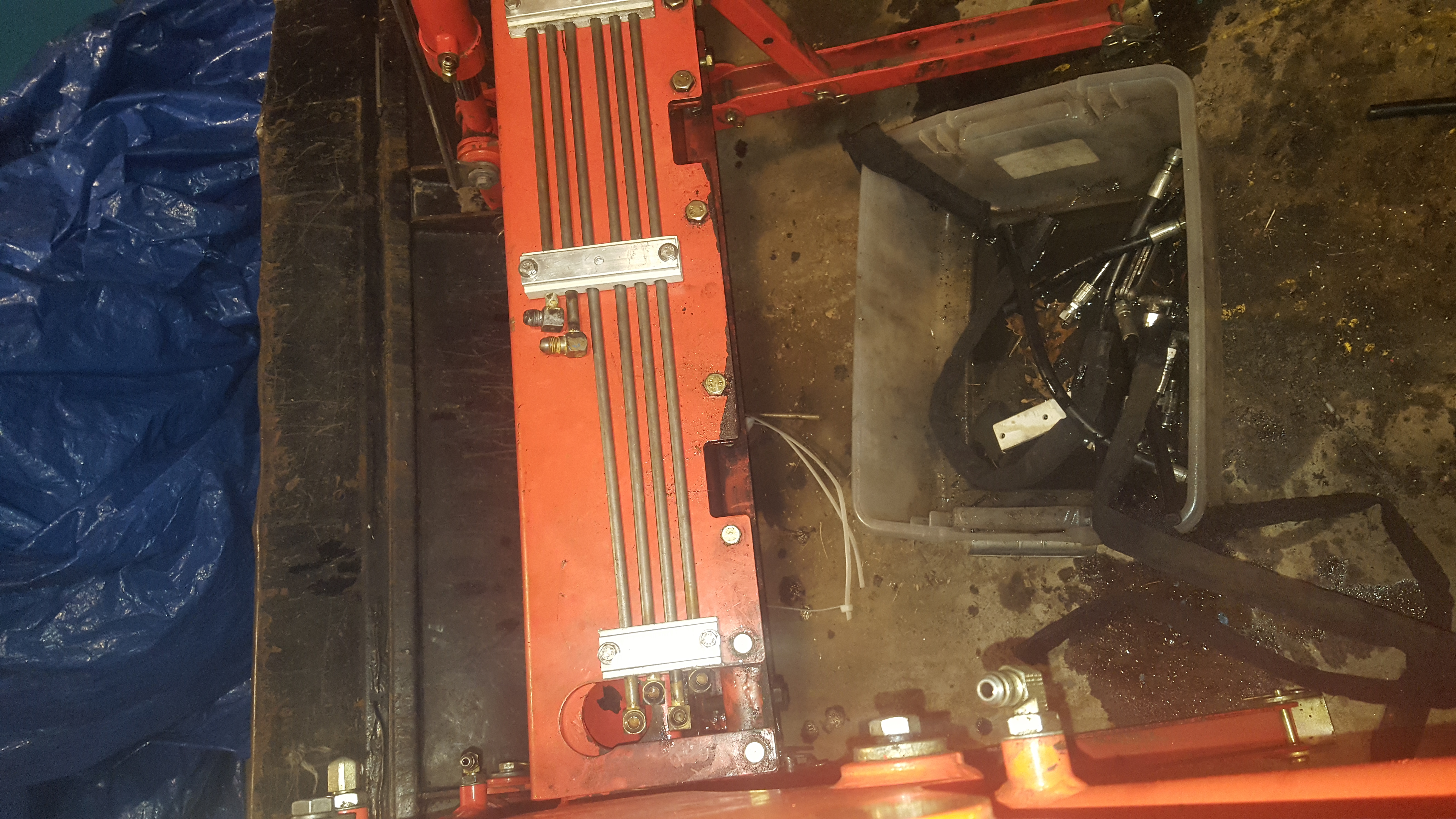

So I thought I would post a brief update to this project. I have had very little time to put on this project in the past couple of months. I have made mounts for the new lines, silver soldered the assemblies, and have done a trial fit. Attached is a before picture and photos of the lines during the trial fit.
