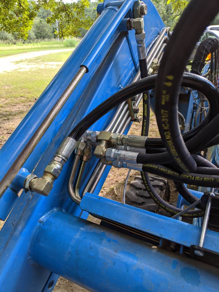

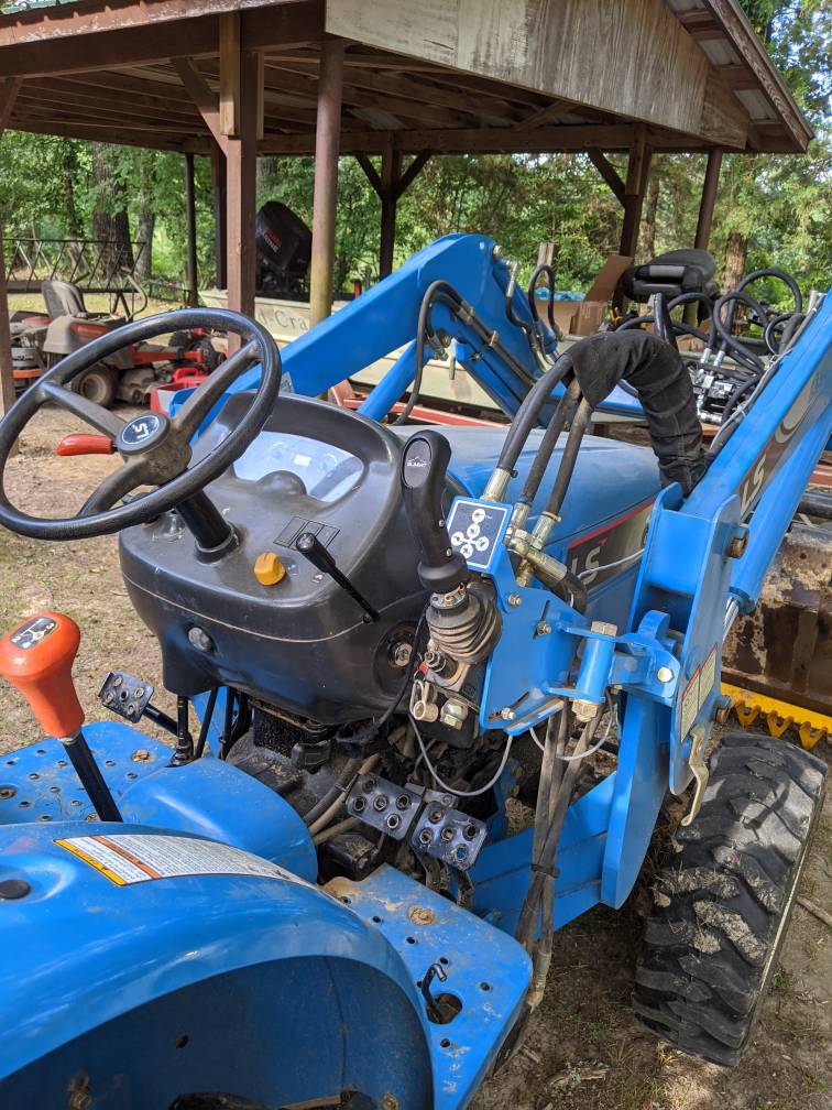

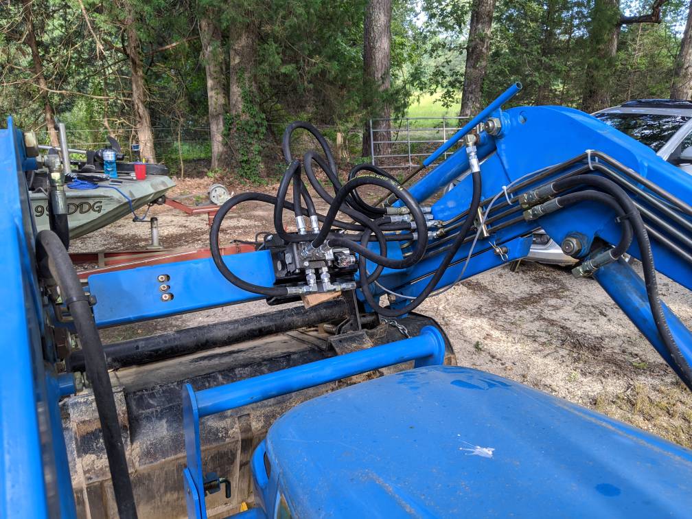

It's all in! It's not pretty, some hoses could have been shorter, but it'll work! Ignore the piece of 2x4... The bolts that came with the mounting bracket were a little long, and the threads didn't go all the way down the bolt, so until I find some different ones, the 2x4 rides! IMG_20200722_180037.jpegIMG_20200722_180024.jpegIMG_20200722_180013.jpeg
