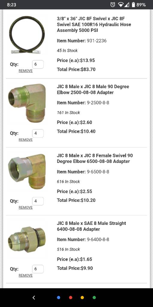

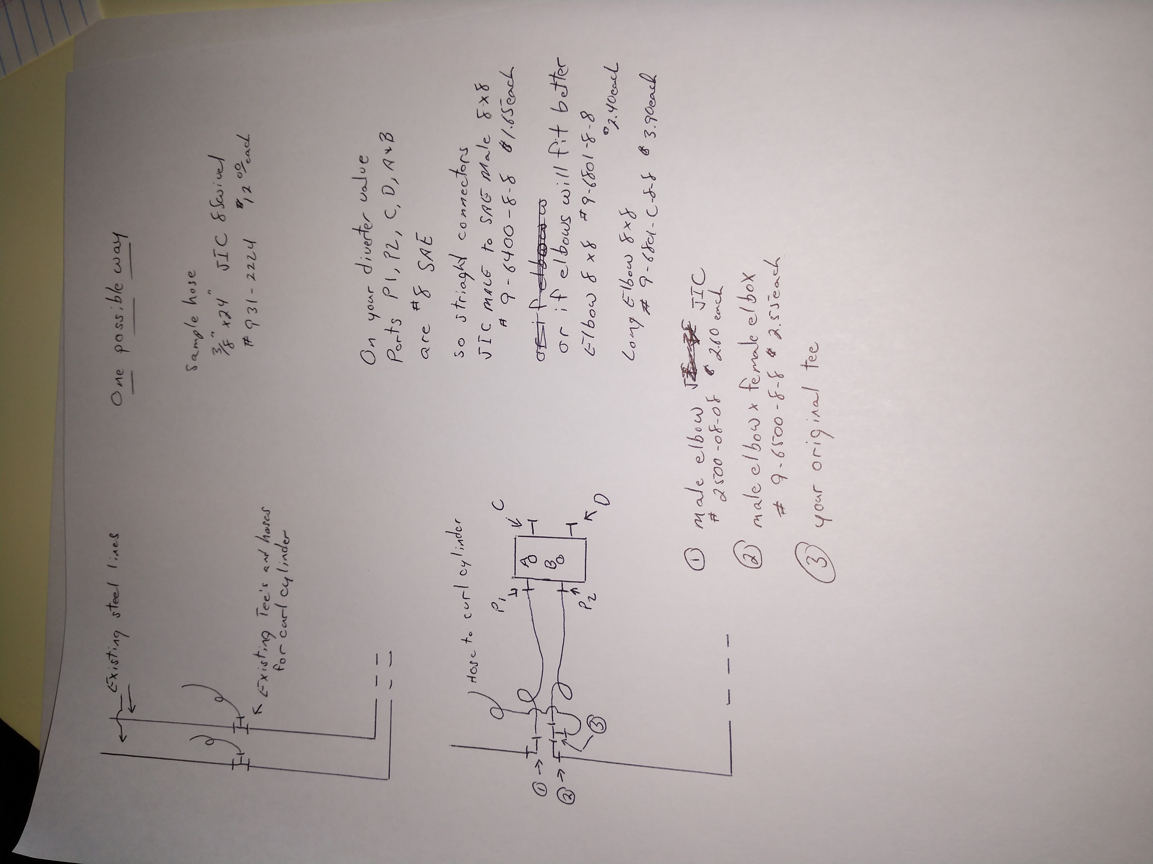

Fittings to go into the diverter? Those usually are something other than JIC.
Also are you sure the tractor loader lines you'll be connecting to are JIC-8? That sounds large. I think mine are 6. Or maybe those fittings are for something else.
   / Fittings/Couplers Question(s)
#22
The fittings to go into the diverter are the SAE #8 to JIC 8 straight through. And I got the JIC 8 from some posts above where they took what is in my manual and said it corresponds to JIC 8. I also double checked that with surplus center.

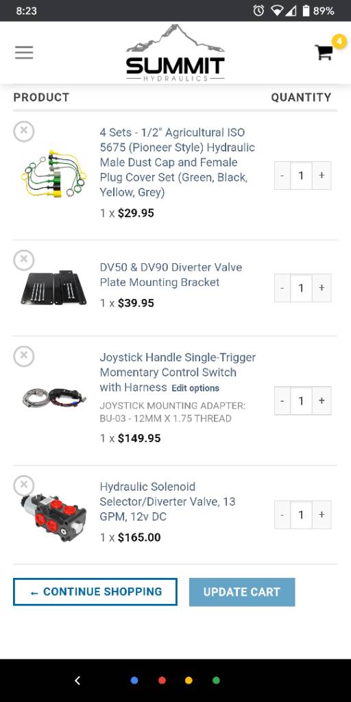

I did notice I'm missing the male pioneer AG (ISO 5675) connections. Does it matter if I get a poppet valve or ball valve on the male side? The grapple I'm looking at doesn't specify what the female is.
   / Fittings/Couplers Question(s) #23
The poppet valve style is supposed to hook up better under pressure,
it is easier to depress and release pressure.

Pretty sure that diverter valve has SAE 8 fittings on the valve. They sell a kit that has adapters for just a little more than the price of the valve and handle.
If you look up the data sheet on the valve (and others) they require a drain connection at a certain pressure and flow. If your tractor hydraulics are less than that, it is fine to just cap it. My tractor's hydraulics are low pressure and flow, so no drain required.

Hey guys! My valve and joystick came in yesterday, and my hoses and fittings should be here today. My grapple unfortunately, is not here yet. Upon planning my install last night I realized that until my grapple comes in, and when I have my bucket on in the future, I won't have anything connected to two of the ports on the valve. What do I do with those? Plug them with a #8 SAE cap, loop a hose between them, or something else? Leave them open and hope my son doesn't push the switch on the joy stick? (I don't like that option...)
   / Fittings/Couplers Question(s) #28
Plug or hose, to keep dirt out. Leave the wiring unfinished to prevent accidental activation.

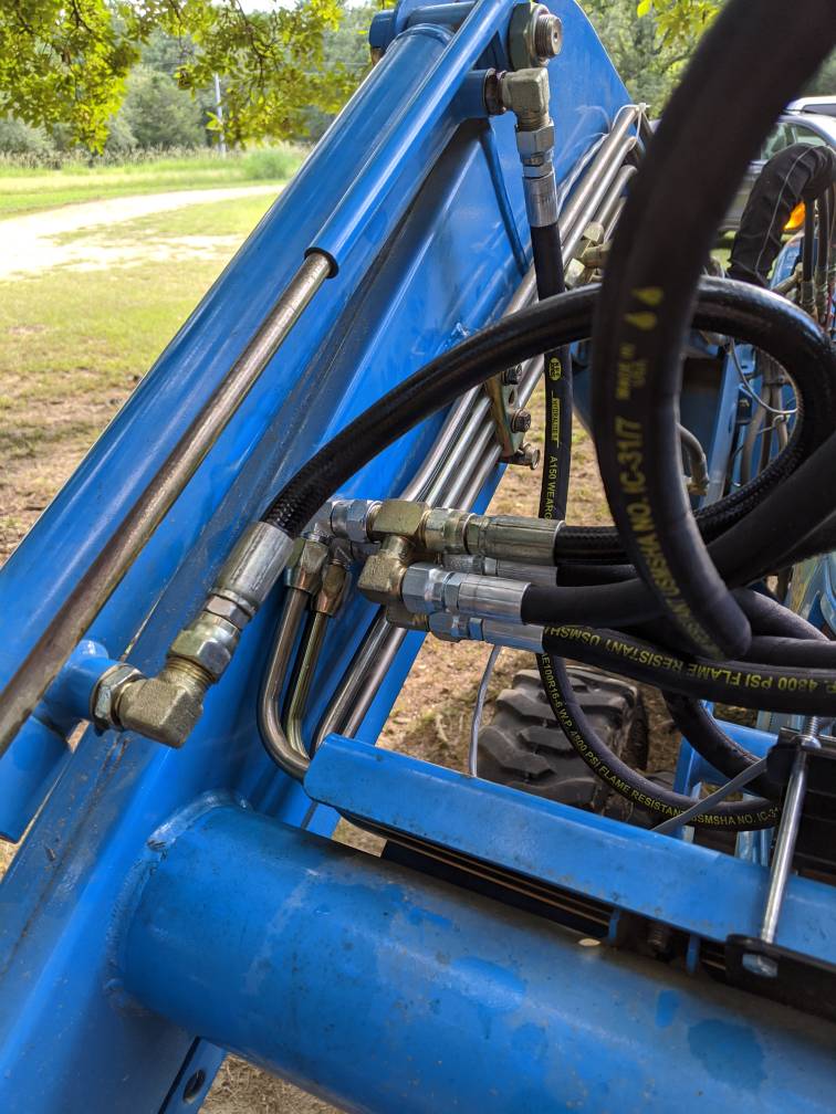

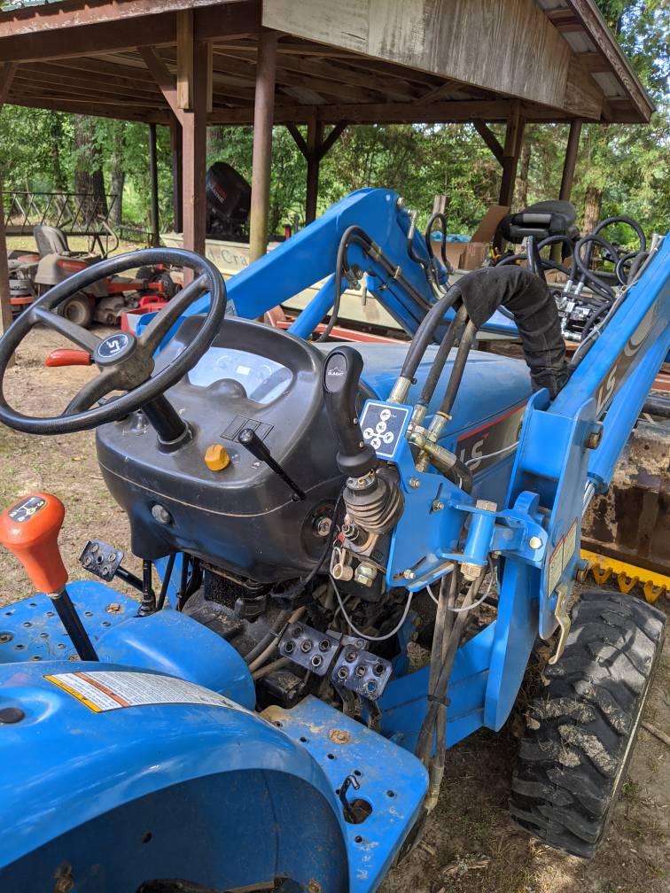

It's all in! It's not pretty, some hoses could have been shorter, but it'll work! Ignore the piece of 2x4... The bolts that came with the mounting bracket were a little long, and the threads didn't go all the way down the bolt, so until I find some different ones, the 2x4 rides! IMG_20200722_180037.jpegIMG_20200722_180024.jpegIMG_20200722_180013.jpeg
