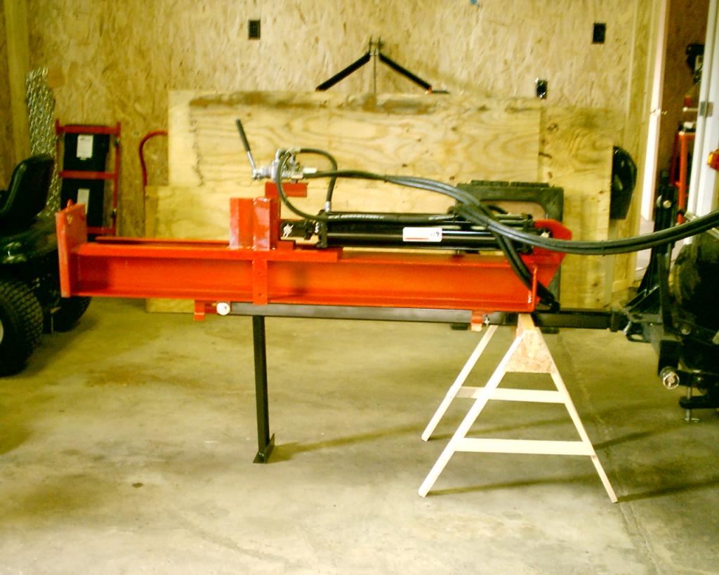

I am in the process of adapting my log splitter into a press. My splitter is one I built and has a fixed plate on the end of the beam. The wedge is connected to the piston via a pin and the whole thing slides in a track. All I have to do is build a piece to replace the wedge for the press. Then when I need to use it as a press simply pull the pin, remove the splitting wedge, and insert the press adapter.

I too have found that a log-splitter makes an excellent press. One additional point to add, though, is that the high flow-rate of the hydraulics can make it difficult for precision work. I would add a flow regulator or restricter orifice to slow things down a bit.
