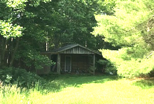

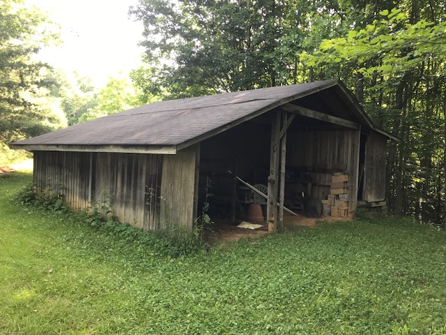

getting back to your original question.......examine the structure.......probe the posts, beams and rafters for rot, sag and level........then do an exploratory to see what kind of foundation you have.......if there isn't one and it's just posts in the ground then it's not worth putting any money into........if you have a good foundation and a good structure then it could be worth saving......if you don't it will just be a money pit..........Jack
/ Fixing an Old Barn #23
yeah unfortunately if its just sitting on dirt it's not worth putting any money into it......eventually the posts will start to rot out or be attacked by termites if that hasn't started already......it will lean and then gravity will do the rest.......I'd look at it as a limited life structure.......no reason you couldn't clean it out now and use it as a place to do maintenance on equipment or store materials out of the weather while you build a new structure.......Jack
/ Fixing an Old Barn #24
Time is money. How long will it take to go through the old barn, remove the bad stuff and replace it with good lumber? Just one rafter or joist can take hours, if not the whole day to replace and do it right. How long to replace and install just one new post?
You can rent an excavator and have it all down and the site cleared in a day. If you get one with a blade, you can probably smooth of the dirt and be ready to build in that same day.
If you hire it out, a crew should be able to built you a new barn in three days. It would really have to be big, or have some special features for it to take them longer.
Most people with basic skills can build a pole barn building in 4 weekends if they are working on it seriously.

I can smell mildew when I look at those pictures. If so, that might remain after a rebuild.

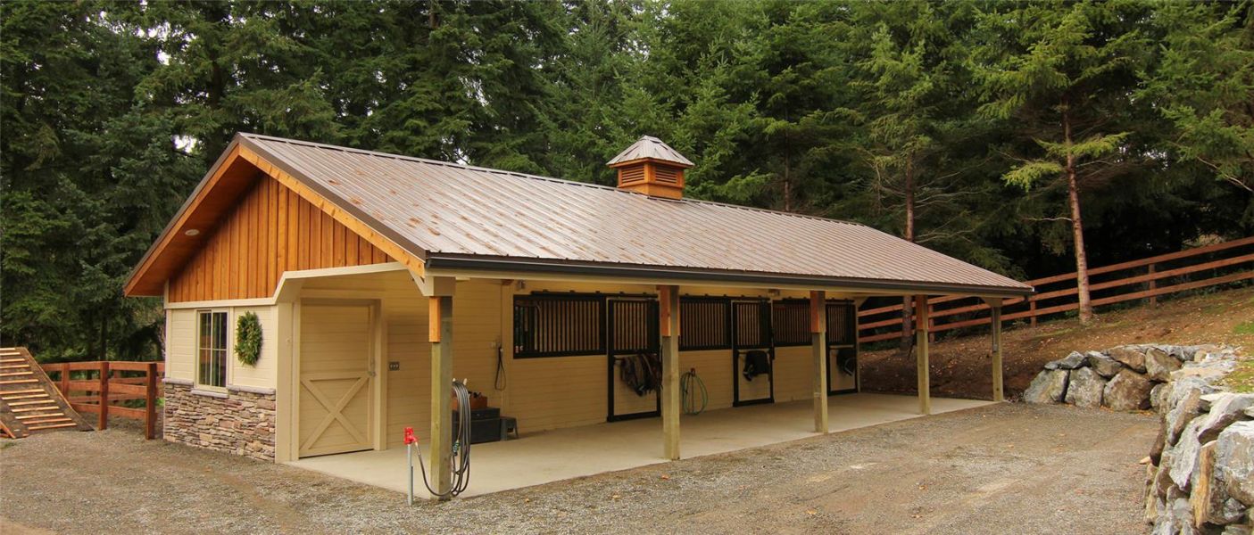

Your dream barn is very nice. I like the way they made their own flat spot and created an interesting retaining wall in the process.
I'll have to do something similar on my hilly property. Agree it was an attractive solution. It was nice to see an advertisement of a barn set into a hill like that. They mostly seem to photograph them on flat land.

Sure, most actual barns around here are on hills too. I meant when you're shopping for a barn design online, they usually show them on flat ground, which makes it hard to picture it on my land.
Thought about the 2-level. We have the slope for it. Insurance is cheaper if you store hay separately in a metal building. Plus with my allergies..... 'Course I COULD use a second story to store the tractor, plus use it as a workshop. But I think I'm going to opt for smaller, single-purpose, charming structures because it will look much better on this particular property, which is kinda tucked into a heavily wooded mountainside. If I had majestic sweeping open fields I'd do one huge building, for sure. Would be magnificent. Here it would overwhelm. I think it helps to consider the "scale" of the landscape in order to make things look nice.

No foundation, just dirt.
Seems like most folks think it's a tear down.
On dirt is not a big deal. Prop some stiffleg braces up to carry the weight, cut the post off above the rot line, nail a post base anchor to the bottom of the post, and pour concrete around the anchor. Chances are you can just use 2' diameter sonotube and not even bother with a footing. Nail 2x4 sleepers to the roof and screw sheet metal roofing down to the sleepers. Add a few internal braces if necessary. It will be good for another 20 or 30 years.
