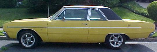

That's actually a '68, the last Dart 2dr sedan. Has a mild (around 350 HP) 360, A-518 (4 spd OD auto) trans, & 3.91 gears out back. It's the chassis & suspension system I went crazy on. Using almost exclusively Mopar parts (but few Dart parts) it handles like a slot car, but if I want a decent ride I'll drive my truck.

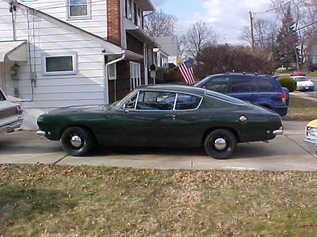

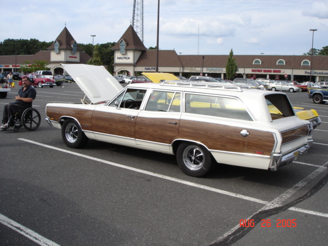

My brother has a couple fun Mopars too: 340 powered '68 Barracuda fast back & a 550 HP (on the engine dyno) 69 Coronet 500 station wagon with power steering, hydra-boost power brakes & A/C. The wagon is silly-fast for a 4500+lb tank!
